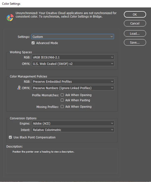

A question that has been bugging me for a long time now.
In my specific case:
I was asked to redesign / tidy-up 7 simulair looking packages for whiteboard accessories. The issue with the current packaging is that some of them have a weird green-ish layer. I'm not sure / aware what went wrong when the current packaging was printed. With the redesign we want to avoid some of them looking different, we want them looking all the same, color wise.
The redesigned packaging is being printed at the same printer where the initial packaging was printed, which is China.
Is anyone able to tell me what color settings / profiles are best for these kind of files? And which settings to export the PDF in? I usually choose PDF/X-1a:2001
These are the current color settings / profile the previous design used

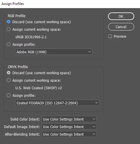

One thing to note about your attached captures—the Assign Profiles capture is showing the active document has no color profiles assigned. A document with no color profiles falls back to the current Color Settings’ Working Spaces for the soft proof display of native RGB and CMYK process colors. So with no profile assignments, the color display is effectively random, and would change depending on whatever the current Color Settings InDesign happens to have loaded.
You definately always want a document RGB profile assignment, because it will be impossible to accurately convert RGB colors into to the final CMYK print space at Export or Print without a source RGB profile.
If the packaging color output will be all Spot color (not a conversion to process colors), and you are using the Pantone Solid Color or Toyo Solid Color book libraries, the Color Settings and profile assignments do not matter. The Solid Color libraries define colors as device independent Lab, which has no profile. The soft proof accuracy of a Lab color representing a solid ink, depends only on your system’s monitor profile accuracy.
For either process or spot color you have to have an accurate monitor profile, which is generated when a monitor is calibrated.

Isn't there a general / default setting which i can use? I'm pretty the one color setting / profile is better than the other?
In color settings the working space default for me is (as specified in the attached image in my 1st post):
- RGB: sRGB IEC61966-2.1
- CMYK: U.S. Web Coated (SWOP) v2
Would this be something i could use?
February 8, 2021
If it's being printed in China why would you ue U.S. Web coated (web is roll fed (like newspapers)) SWOP v2?
You really need to get the colour profiles from the printers.
