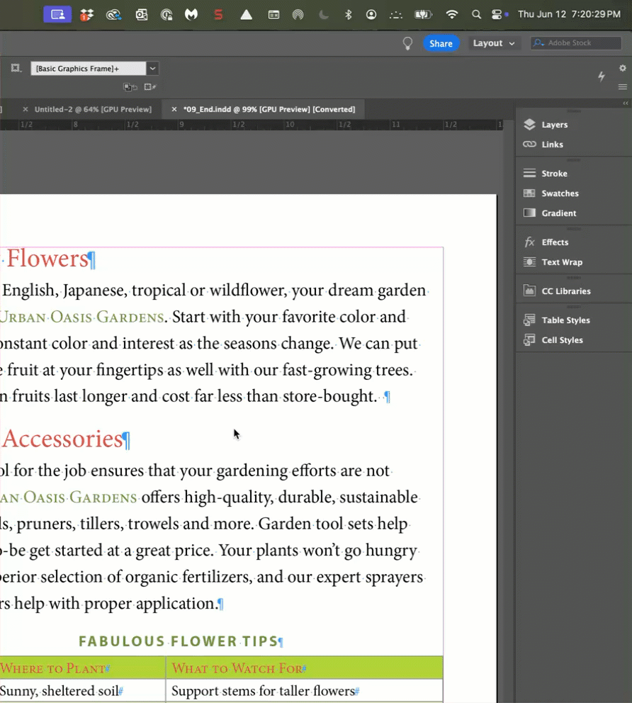

  1. The 1st column (aka vertical strip) is sitting next to the 2nd column and text will disappear underneath. Consider docking that 1st column to keep that from happening. Drag the group to the right until your cursor touches the scroll bar. Release the mouse when you see a blue, vertical bar.
  2. Save your workspace!! If you crash or reset prefs, you will lose it and I know you won't enjoy setting it up again. 😉 Once saved you can return to it at any time, using the Workspace list. You can also reset the workspace back to the last time you saved it. When I wrap up a day of production, my InDesign desktop and my desk are both a mess. Luckily. I can clean up my desktop by just resetting my workspace. Wish I had a quick way to clean up my desk!
~Barb
Jun 13, 2025 3:55 PM UTC
As always, thanks for the time on that, Barb. I think I've already done what you're showing there; the panel I have with paragraph and character styles is already part of the narrow column to its right. I can't drag it around independently the way you show in your screen grab. And I did take your advice and save the layout.

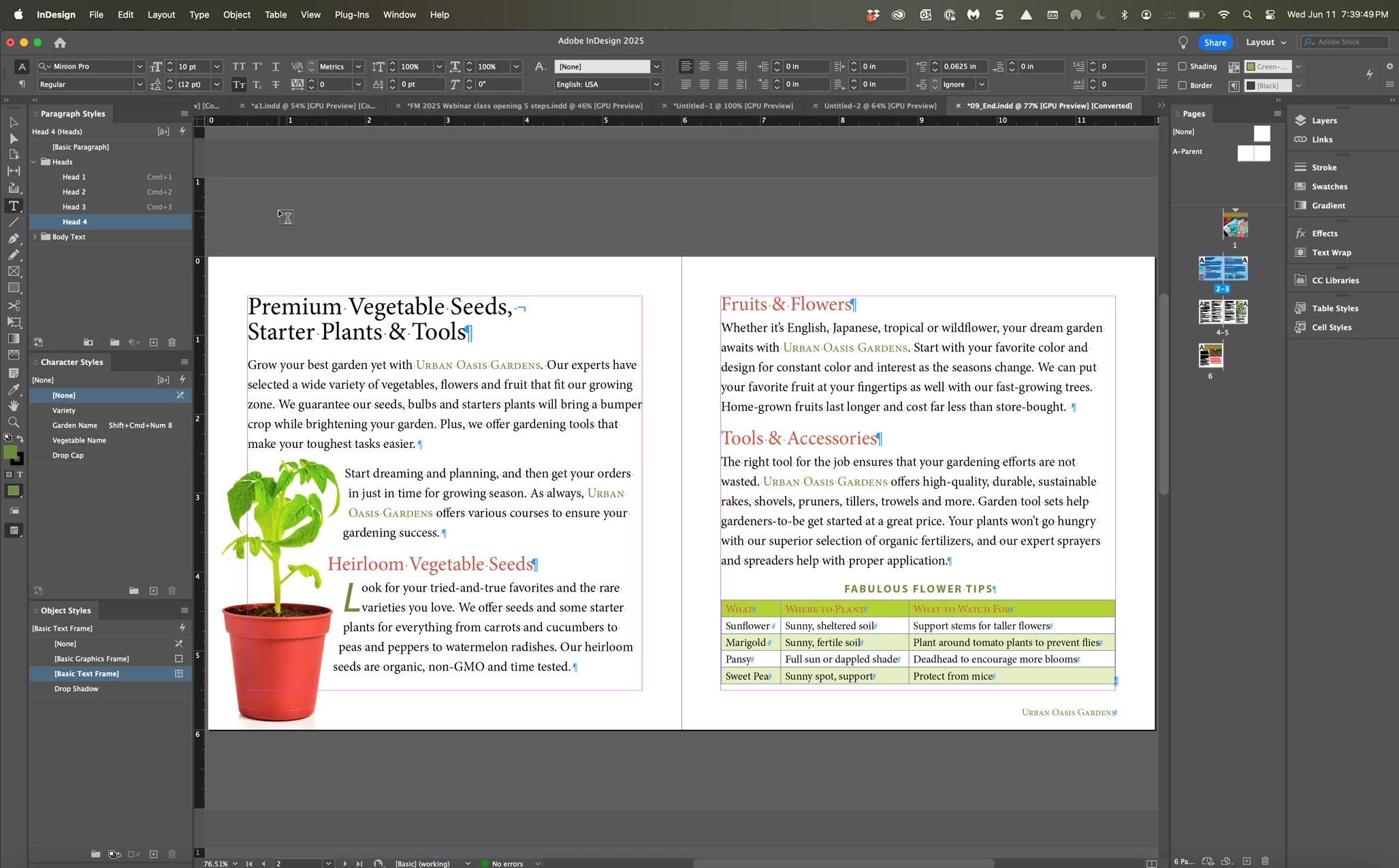

I hear you about screen space. Most of my students have two or three displays so they have plenty of room for panels. I do a lot of work on my MacBook because I'm an outdoor girl and often outside. This is my preferred laptop workspace (though I have custom versions for specific jobs). It's important for me to have access to my styles panels and pages panels—they are always open.

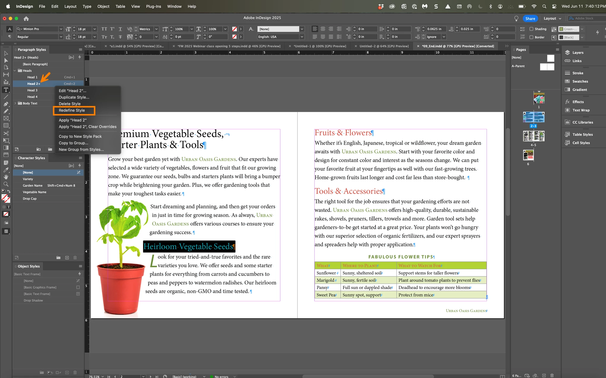

As for Redefine Styles—it's available in all of the styles panels—Paragraph (shown), Character, Object, Cell and Table, but it is only shown if you have an override (the + next to the file name). Otherwise, you don't need it and it doesn't appear.

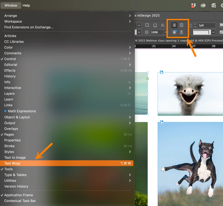

Instead, I open my intro classes by explaining panels. I point out that in order not to overwhelm a new user with too many menus and items within the menus, most InDesign functionality is found in panels. I show that the Window menu lists all of the panels alphabetically from Articles to Version History—so Text Wrap is in there with the Ts—and the only digging ever required is when a panel is embedded in a submenu. I also have them display the Control Panel which is context-sensitive like the Properties panel, but has many more options available (including text wrap controls). We wrap up that part of class by creating a custom workspace so that they learn how to design a workspace that supports their workflow and get back to it easily.
Once more thing I mention in all of my InDesign classes is that if you see a button on the Control panel, you can Alt/Opt click it to open the panel with the additional controls.

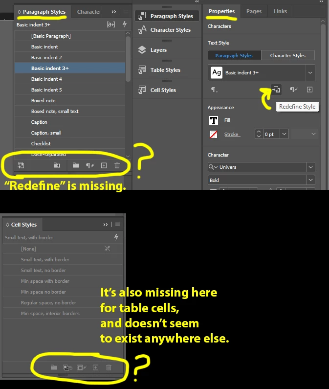

As far as the panels are concerned, I don't have room for them on my screen. I have docked some in the vertical strip to the left of the Properties panel, however. I do find it useful to have the Paragraph-styles panel open along with the Properties tab; I can see and change a lot more information at once.
The "more complete" panels are not, in fact, complete. For example, the "redefine style" button is missing from the Paragraph-styles panel; it's only available in the Properties pane. And for some things, it's missing entirely; namely Cell styles. Screen shot attached.
Also, you need to have the Pages tab available at all times anyway, and it occupies the same screen area as the Properties tab. So I don't how the Properties tab costs any additional space.
Edit: I did find that the Paragraph one at least has "redefine" in a context menu. But not the Cell one, which is probably why I concluded that it wasn't available in any of these panels. The lack of attention to consistency here is pretty infuriating and confounds users' attempts to find functionality; so they conclude that it doesn't exist.
