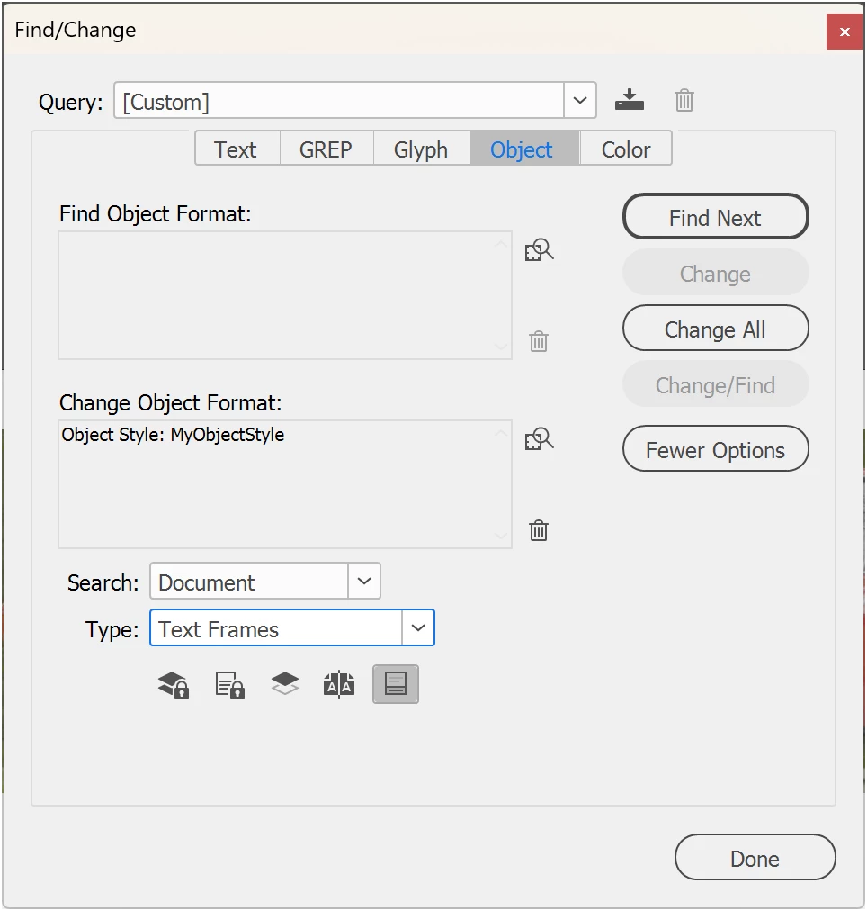

    Mar 12, 2026 7:47 PM UTC
    If all the text frames were the same size at the start and throughout, then you can go to Find/Change and search for object, insert the height of the text frame exactly, and then in the change options put in the new height, and change all and it should find all objects that were that height and adjust them.

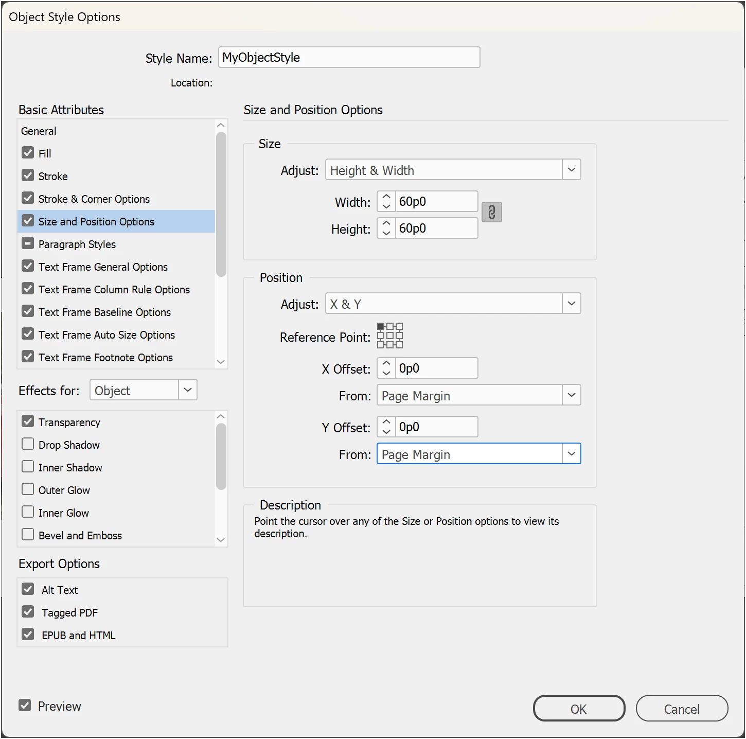

    Mar 12, 2026 7:29 PM UTC
    Find/Change all the textframes applying an Object Style (that you make) that defines both the size of the frame and the position.

    m5heathAuthor
    Mar 12, 2026 8:11 PM UTC
    But I have 200 pages and I would have to apply that particular object style 200 times in order that it will find them all. I can't see a way around that.

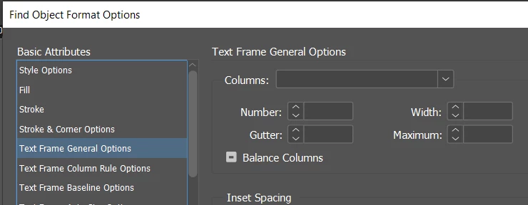

    Mar 12, 2026 8:15 PM UTC
    By the way, when I look at the Find Object Format Options, the basic attributes does not include ‘size and position options’. Has InDesign dropped this and moved it to another choice?
