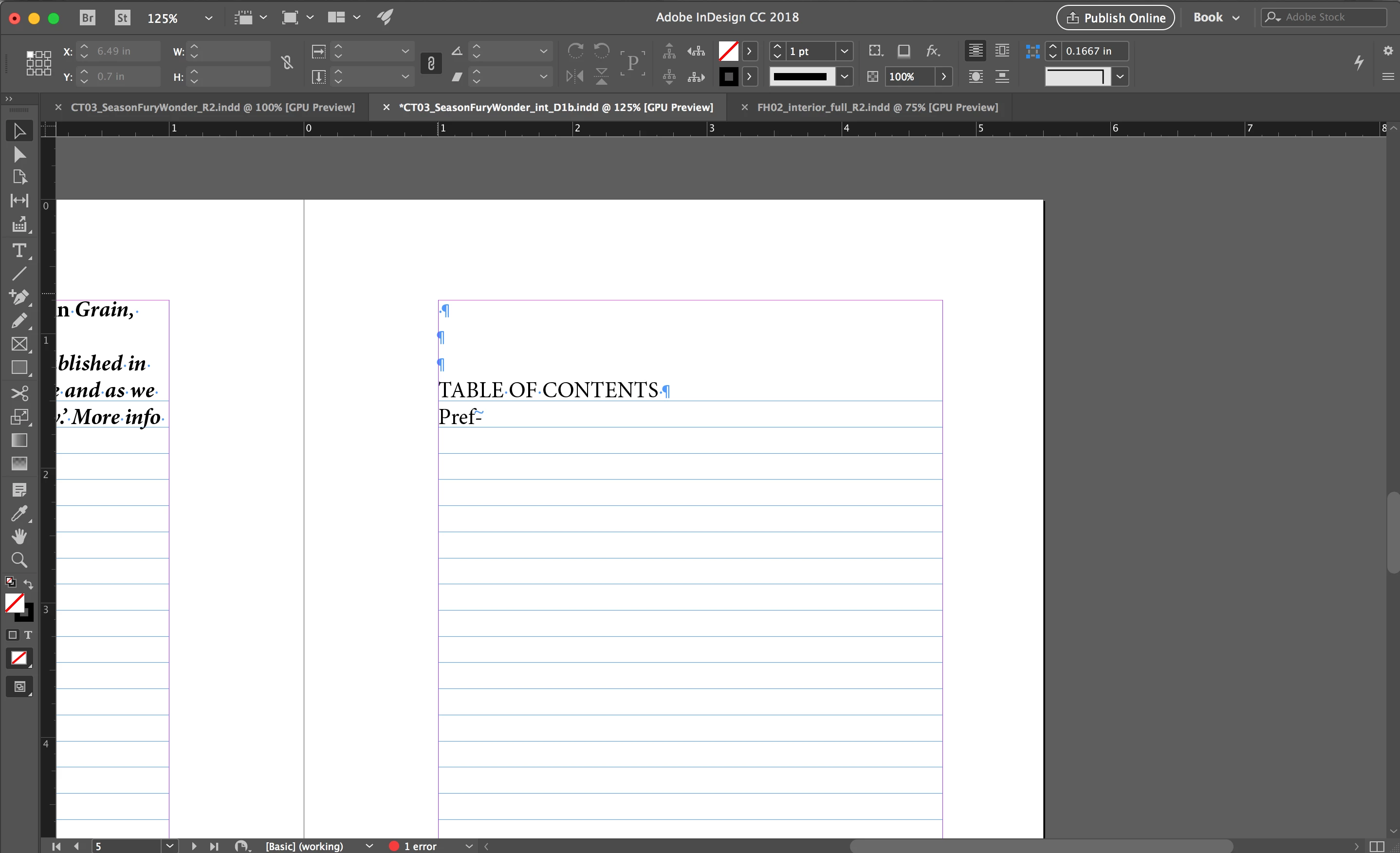

    Hi, I'm also having an issue placing text from a .docx file into my InDesign document. When I place and try to flow the text, I can only flow a small part of the Word doc. I've never had this problem before. I'm using InDesign CC 2018.
    I place the file using command D and then shift click to flow it. I remove styles and formatting but preserve local overrides. When the text starts to flow only a few pages are created and part of the text flows in but then stops mid-word before it reaches the end of the last page created. The red plus sign does appear on the last page but if I continue to try adding a page and flowing it, again only three new pages appear and they appear empty but with a new plus sign at the end. Could there be something wrong with the Word doc? Here's where the text stops at the beginning of the table of contents.
    shawnpaikin
    November 9, 2018
    When I have the problem of text suddenly ending like that, it's because the line after that has loads of 'keep' options applied or even a very long web address. If you make the text box wider from bottom right you will normally see what is too long and won't fit on one line. If that doesn't help, the line that is cutting off may have imported a bad style from Word, set the line to default style and reformat the one line again.

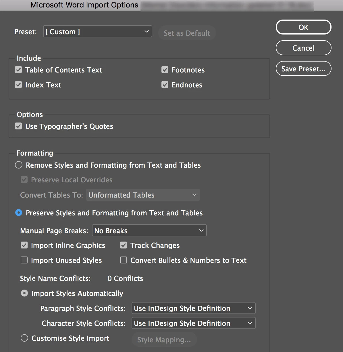

    Derek Cross
    June 16, 2018
    Which version of InDesign and OS?
    When you first set up your InDesign document ensure you select Primary Text Frame - that will alow the pages to flow when you Place the MS. You can use InDesign’s Word Import Options dialogue feature to match Paragraph and Charcter styles. (Make sure you select Basic Paragraph Style and No Character styles when you Place the Word file and clean up the Word file as much as you can before you Place it.)
