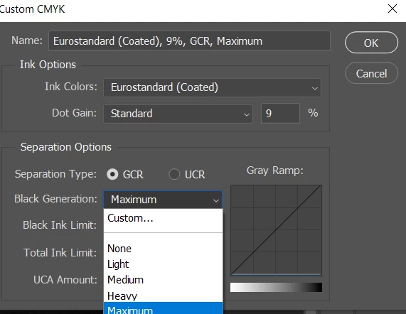

To avoid the colour cast on your black and white images, the best approach is to make sure they are prepared as grayscale in Photoshop and if you're converting them to CMYK to only the K channel active (which is the same thing as a grayscale image...). This ensures that no cyan, magenta, or yellow is added, which is the main cause of the colour cast.
You can do this with Edit>Convert to Profile> Select the colour profile and then perform an Gray Colour Removal (GCR) - which should move all the channels to the Black channel only

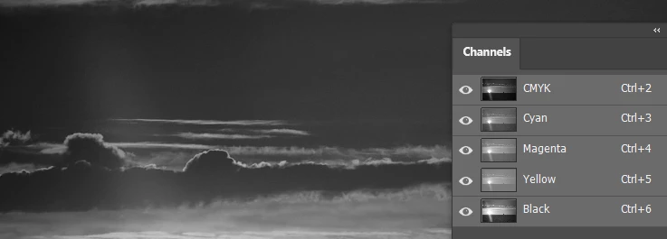

  • It would be best to leave your grayscale images as Grayscale - what you've done converting CMYK to grayscale isn't necessary but you've already done this - as your image was originally Grayscale placing that in InDesign would have been more efficient - and using PDF X4a to export your PDF as PDF X4a shouldn't perform any colour conversion - whatever your Photoshop settings are for your images should retain that.
This might be happening for you - which when converted to CMYK it's in all Channels and why you're having colour casts
Just to note - the result below is the exact same as a Grayscale image, it's just going to be a CMYK image with all the channels on the Black channel - which is the same thing as a grayscale image... so it's really pointless I think. As said earlier it's best to leave your images as Grayscale - and use PDFX4a when exporting the PDF.

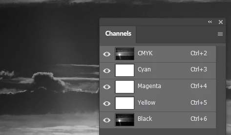

To resolve your issue with CMYK grayscale images
Click Profile and choose Custom CMYK
Select your Colour Profile and then GCR and then Maximum
(Sorry for the bad screen shot it wouldn't work any other way)
Then you'll see all the other Colour Channels are empty - except Black

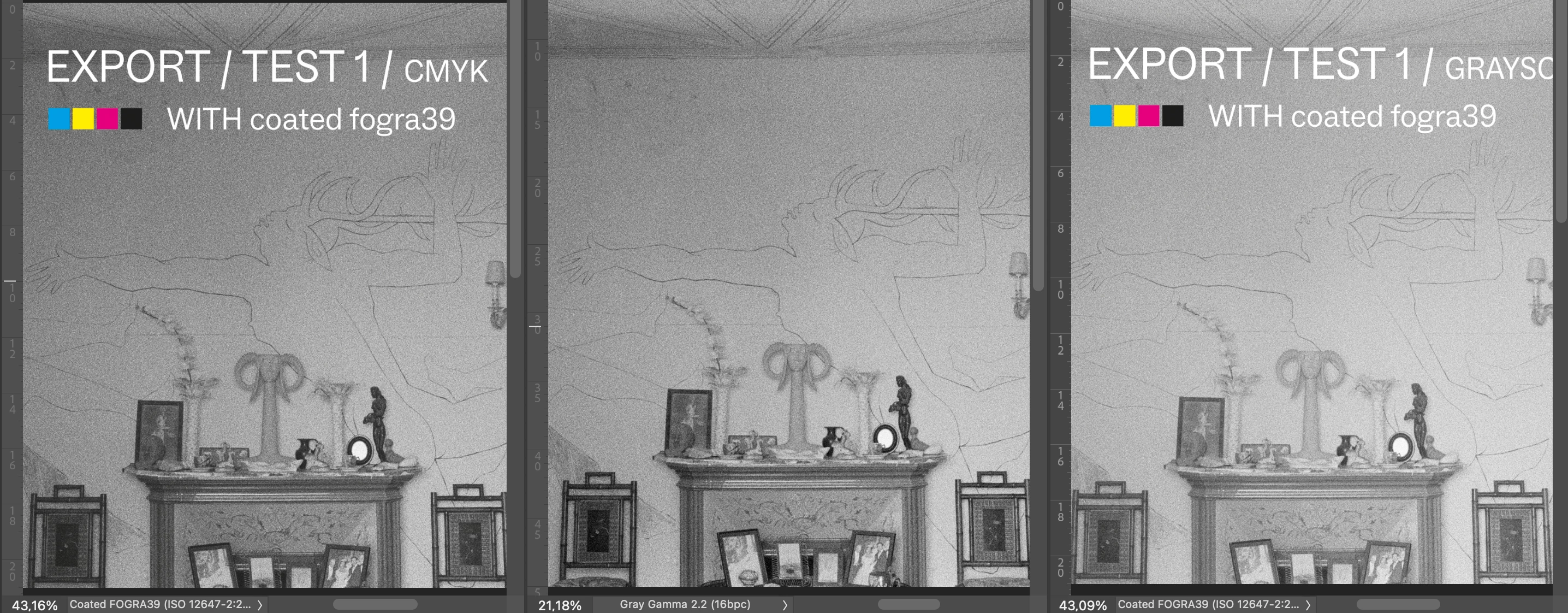

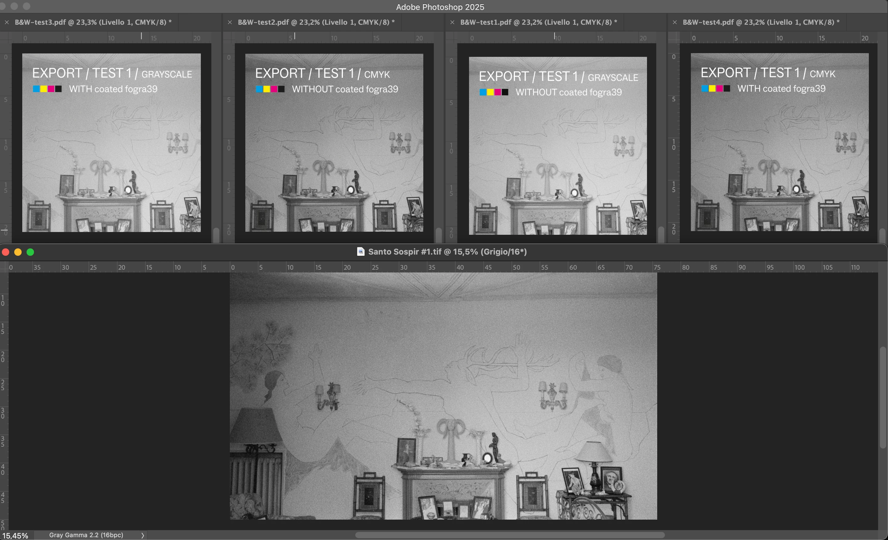

1. I used the image in 2 versions: the original .tif with a grayscale profile (gray gamma 2.2) and the same .tif converted following your instructions for custom CMYK.
2. I placed the 2 images in different pages of my .indd file, adding CMYK colored squares on top of them.

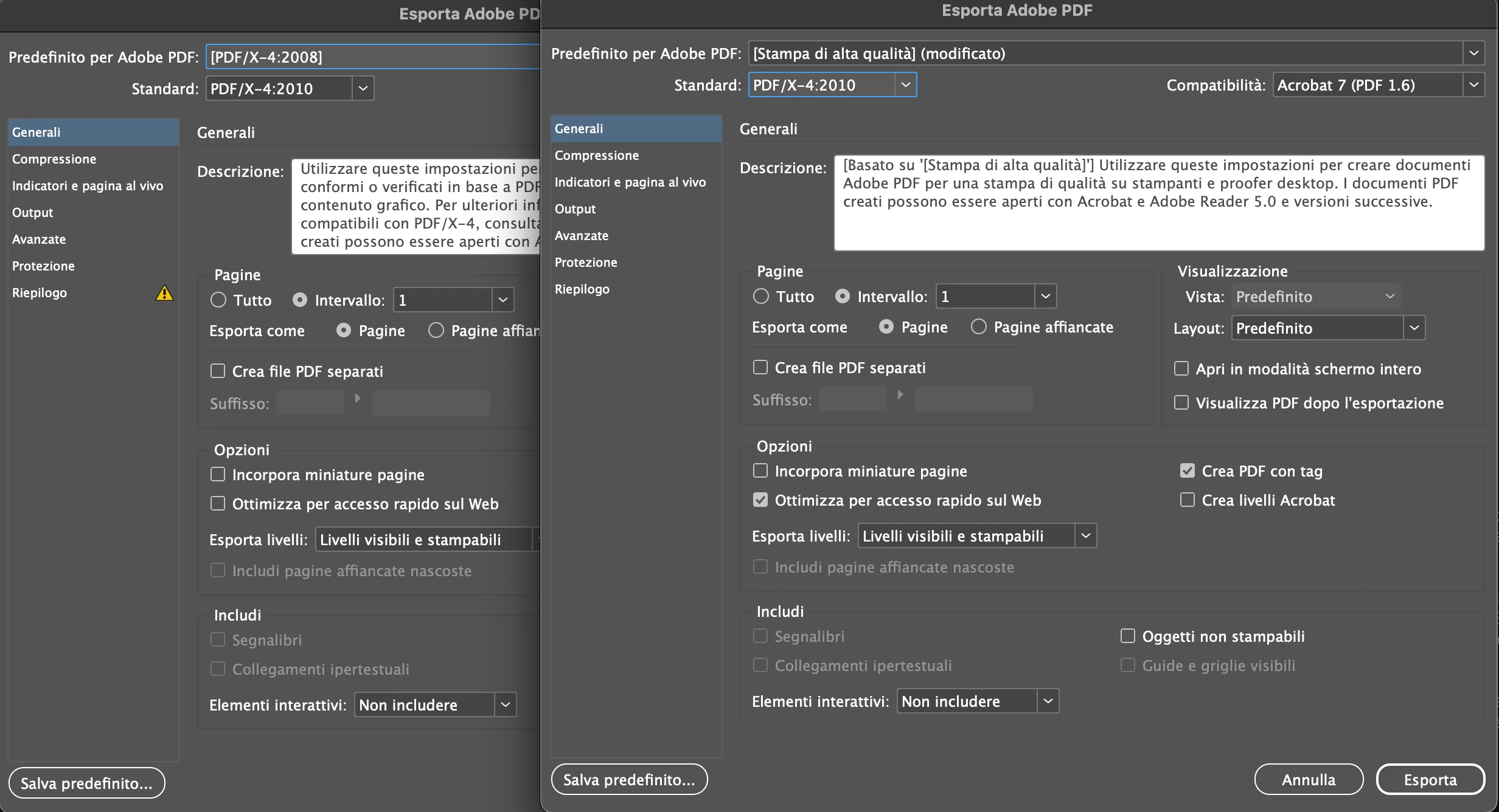

3. 3. Then I exported the file (using the High Quality Print as profile + PDF/X:4-2010 as Standard) in 2 different ways: without color conversions and converted to destination (with Coated fogra39 color profile).
As a result, I noticed that the Grayscale versions look more washed out, both when exported with and without the converison to the color profile. On the contrary, the custom CMYK versions are slightly darker but still closer to the original image (with and without the converison to the color profile).

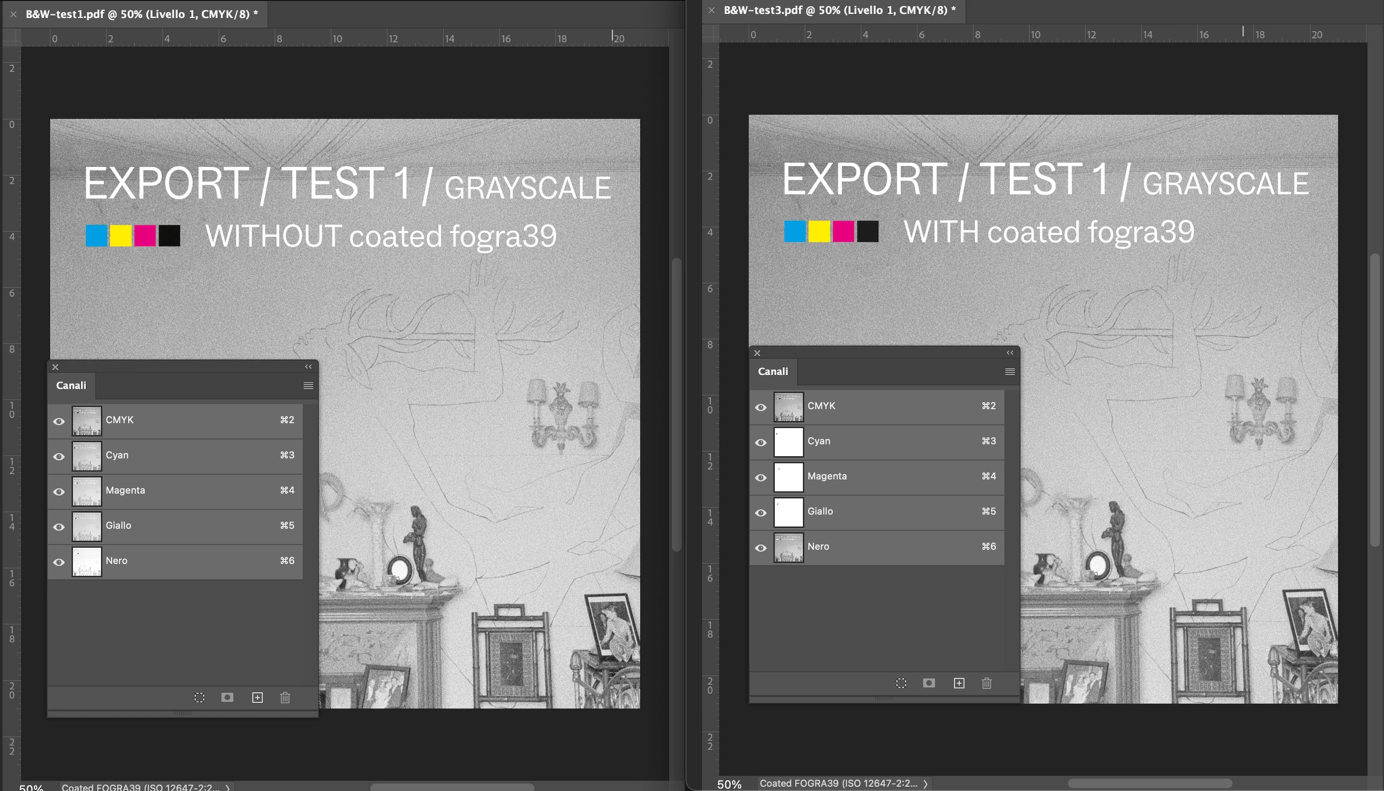

Another important thing I noticed is that when opened in Photoshop: the file with the grayscale version of the photo without a color profile is converted to CMYK using the 4 colors. The same does not happen to the grayscale photo with a color profile. Doesn't this imply the risk of getting a color cast? The printer still has to convert the file to a CMYK profile, so perhaps it is better to avoid this option. What do you think?
I encountered the same problem both using PDF/X:4-2010 as a Standard (with High Quality Print as the profile), and using PDF/X:4-2008 as the profile, with PDF/X:4-2010 as a Standard (which gets automatically selected).
There doesn't seem to be any difference in the output of these 2 different export settings. Do you think PDF/X:4 should be used as a Standard or a profile? Would it be better than using High Quality Print as a profile? Someone advised me to use High Quality Print as a profile and PDF/X-1a:2001 as a Standard, do you agree?
In conclusion, the best way to solve the problem seems to be: custom CMYK profile for the .tif + conversion to coated fogra39 when exporting from .indd to .pdf
This way the black and white image does not look washed out and the .pdf is already set to a standard CMYK profile, which keeps the CMYK color mostly consistent and the black image only on the K channel. What do you think? Thanks for your help!
