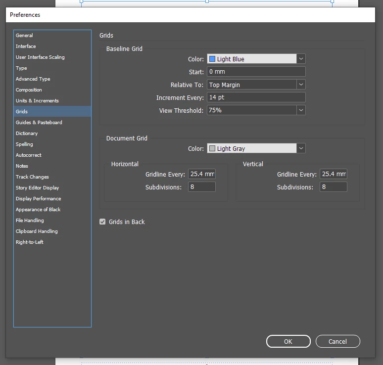

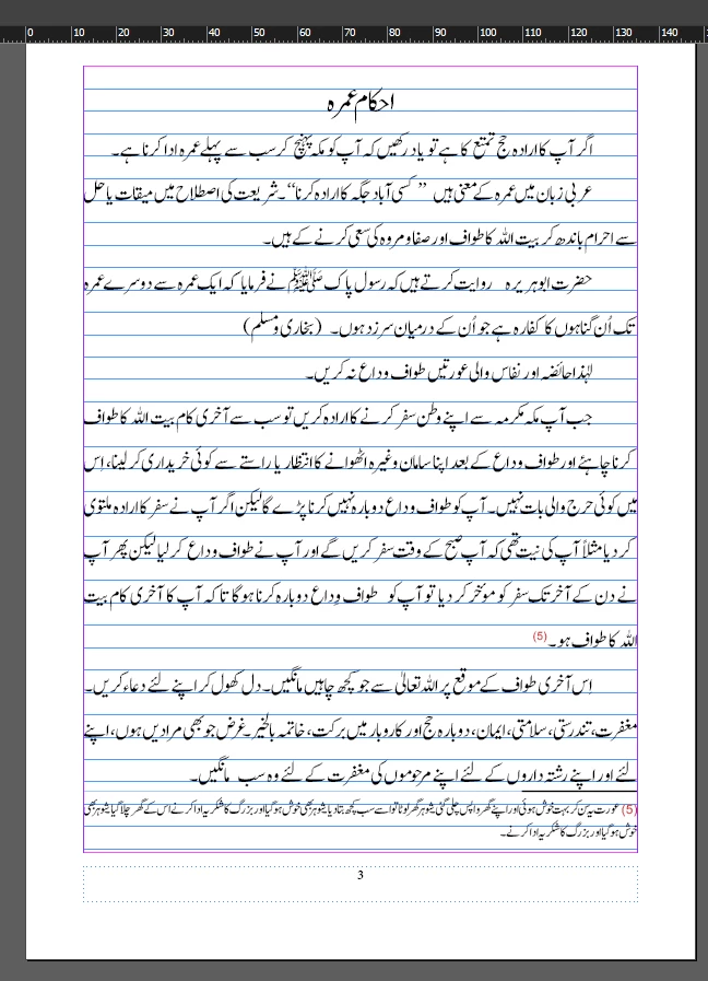

I have a situation. In my document, Body text is 15pt on 22pt. Footnotes is 10pts on 14pts and Heading is 22pts on 30pts.
I want all of them to be aligned on baseline grid. I have done all the settings but the output is not as per my requirement. Leading between Body Matter is not appropriate. The space should be less between the body text lines.
Footnotes are not set on Baseline Grid. I have attached screenshots of the pages and also the baseline grid settings for the document, paragraph styles, font and document.

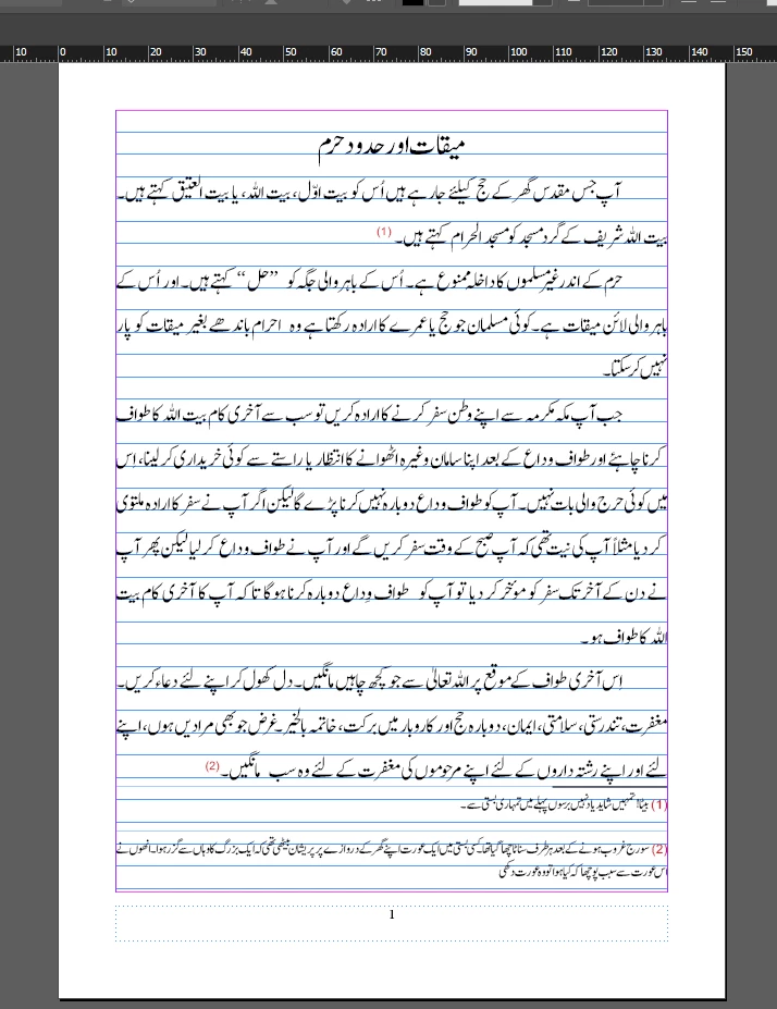

@James Gifford—NitroPress Thanks for the reply. I have modified settings a bit. Leading for Heading and body and footnote is multiples of 7pt. My Baseline grid is on every 7pts. Heading and Body is ok but footnotes still is not on the grid. Screenshot attached.
You can adjust the footnote layout (mostly spacing above the set, and the separator line) but they're either going to have to fit 7 or 14pt leading. Neither will be very graceful.
I know something of Arabic calligraphy and typesetting, and perhaps understand that the client wants this to conform to traditional standards, but I think the only way it will happen will be to adjust the layout page by page, including some ability to edit and rearrange the content. That's the level I've had to go to for some very fussy (and mostly short) layouts that needed to be 100% aligned.
