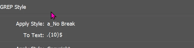

Robert at ID-Tasker
Feb 10, 2025 3:59 PM UTC
@landscape_snarkitect
"." = any character
"{10}" = repeated up to 10 times
"$" = end of paragraph

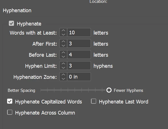

Dave Creamer of IDEAS
Feb 8, 2025 12:04 AM UTC
Short line endings are not Widows or Orphans--they are paragraph issues. Some people call them Widows, so I tend to call them "Line Widows".
This is what I do in my main Body style to prevent short endings:
I adjust the number depending on the column width used. If the character count hits mid-word, it still has to follow my hyphenation settings.
