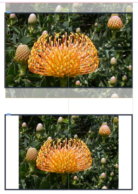

    Below are the results of Fit Frame Proportionally and Fit Content Proportionally.
    The former assume the frame size is the most critical sizing element, so photo fits frame to smallest dimension and crops off the other dimension (either width or height depending on photo to frame relationship).
    The latter assumes the photo content is the most critical sizing element; the frame would need to be adjusted to fit.

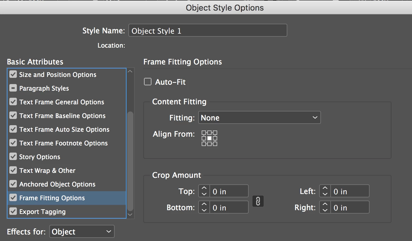

    From the screen Steve showed you, turn on Auto-Fit and set Fitting to Fill Frame Proportionately or Fit Content Proportionally depending on the aspect ratio of the images and the frames. And don't forget to select the center reference point in the proxy, as he is showing you.
    ~Barb
    Steve Werner
    January 30, 2018
    Use Frame Fitting Options:
