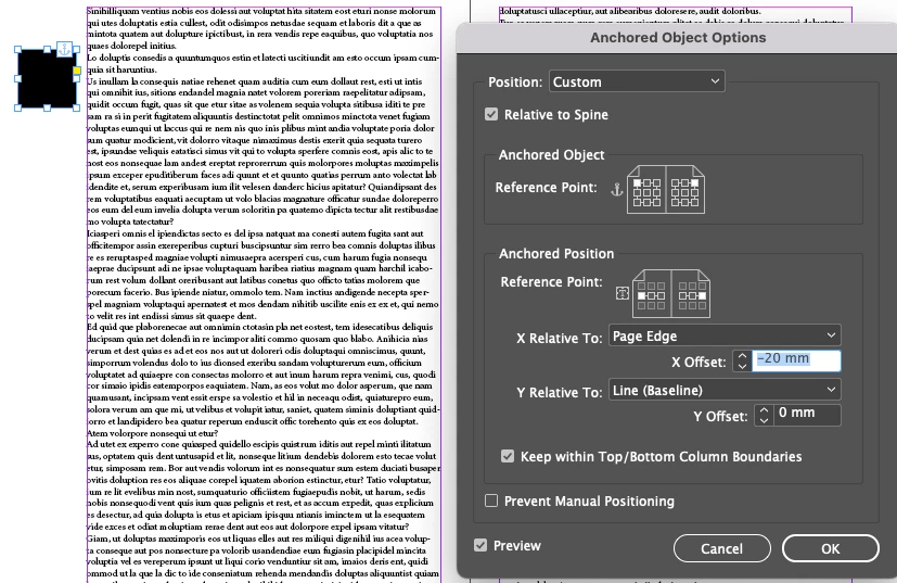

Feb 12, 2025 11:07 AM UTC
Anchored object setting something like this - make it an Object style for easier editing globally later if needed
