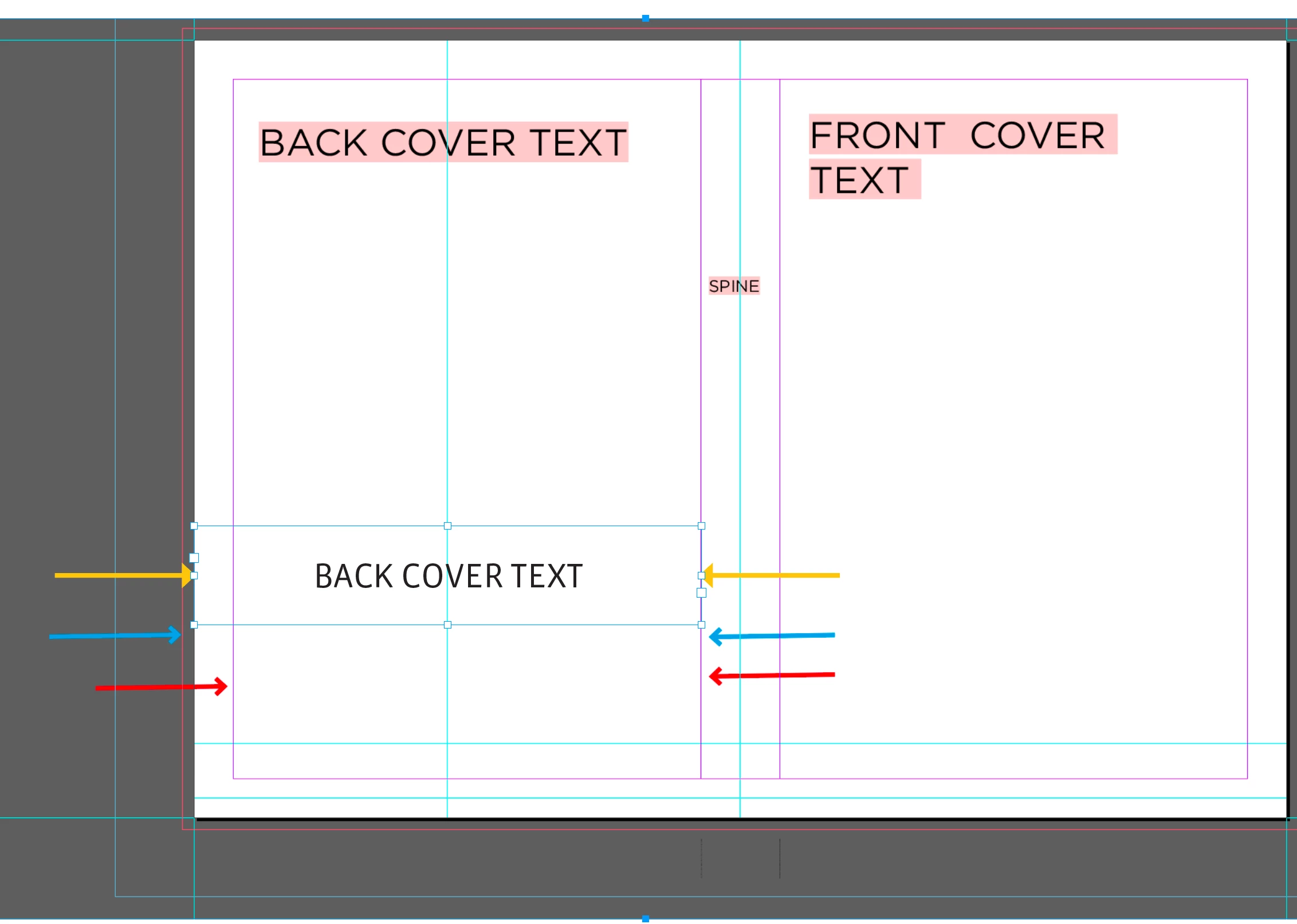

When aligning to the centre, am i supposed to be using the margins or bleed lines as a guide?
  • January 3, 2022
  • 1507 views

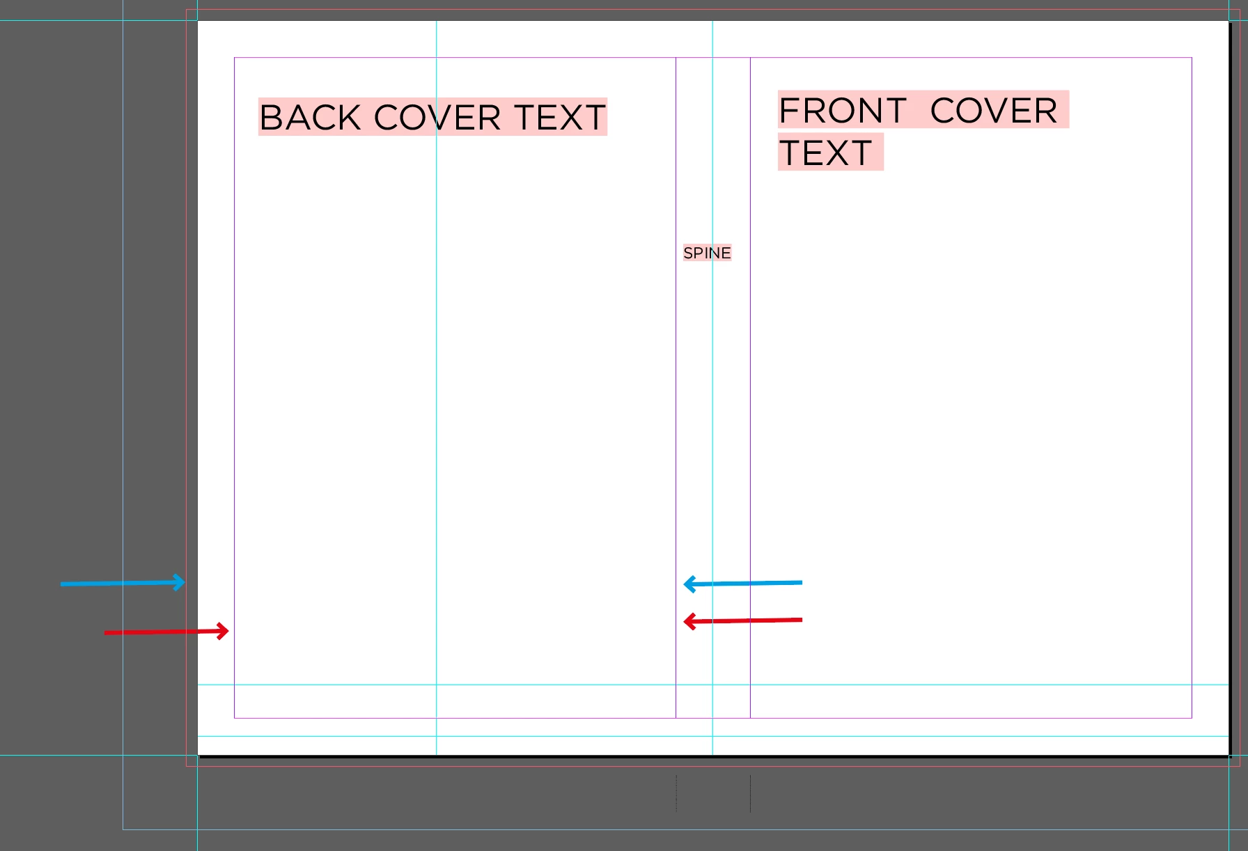

Im currently working on the layout of a book spread (Backcover, spine and front cover) and i would like to align the back cover text to the centre of the page. But the centre varies depending on whether im aligning the text between the bleed line and the spine margin (BLUE ARROWS) or between the back cover margin and spine margin (RED ARROWS).
Does anyone know which guidelines i should be using so that it prints correctly, thanks!

The back cover center would be between the trim and the spine fold:

With a normal paperback you work to the TPS.

I think that would depend on your preferences and how you would be binding your book.
  • If you're using the space between the live area of the front and back covers for perfect binding on a thick book, as you define the spine, I would center alignment between the blue arrow at the edge of the spine and the edge of the page, less the bleed area inside you show with your blue arrow outside the page trim.
  • If I was creating a smaller book that would be saddle-stitched/stapled in the center I wouldn't use either set of arrows either. In that instance I would center type between the blue centering guide you've set in the middle of the spread/spine and the edge of the page trim between your red and blue arrows at the edge of the page.
Either way, you want to be "centering" your elements between the spot where your cover folds over to create the spine and the edge of your page trim. So neither set of arrows would be the right answer. I would ignore your column/page margins, because they're lying to you about where the center of your page actually would be. If you want to fix the page with the page/column guides, set your left and right margins at 0 and your column separation to account for the final size of your book spine, or lack thereof.
