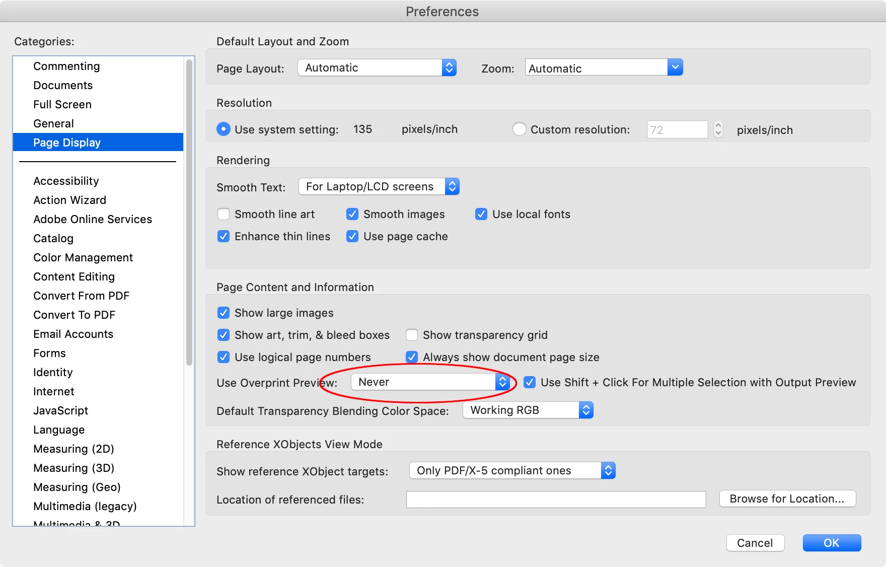

Hi @amandac55703260 , With Interactive PDFs, all color is converted to sRGB on export—doesn’t matter what the document Intent is. Acrobat Reader and AcrobatPro have a Page Display Preference that can affect the preview of RGB color. Try setting Use Overprint Preview to Never and the default blending space to RGB.

Marvellous Rob, thank you. 🙂 That's the ticket. After making sure each and every element wasn't set to overprint I didn't think to check if it was Acrobat.
Very grateful !

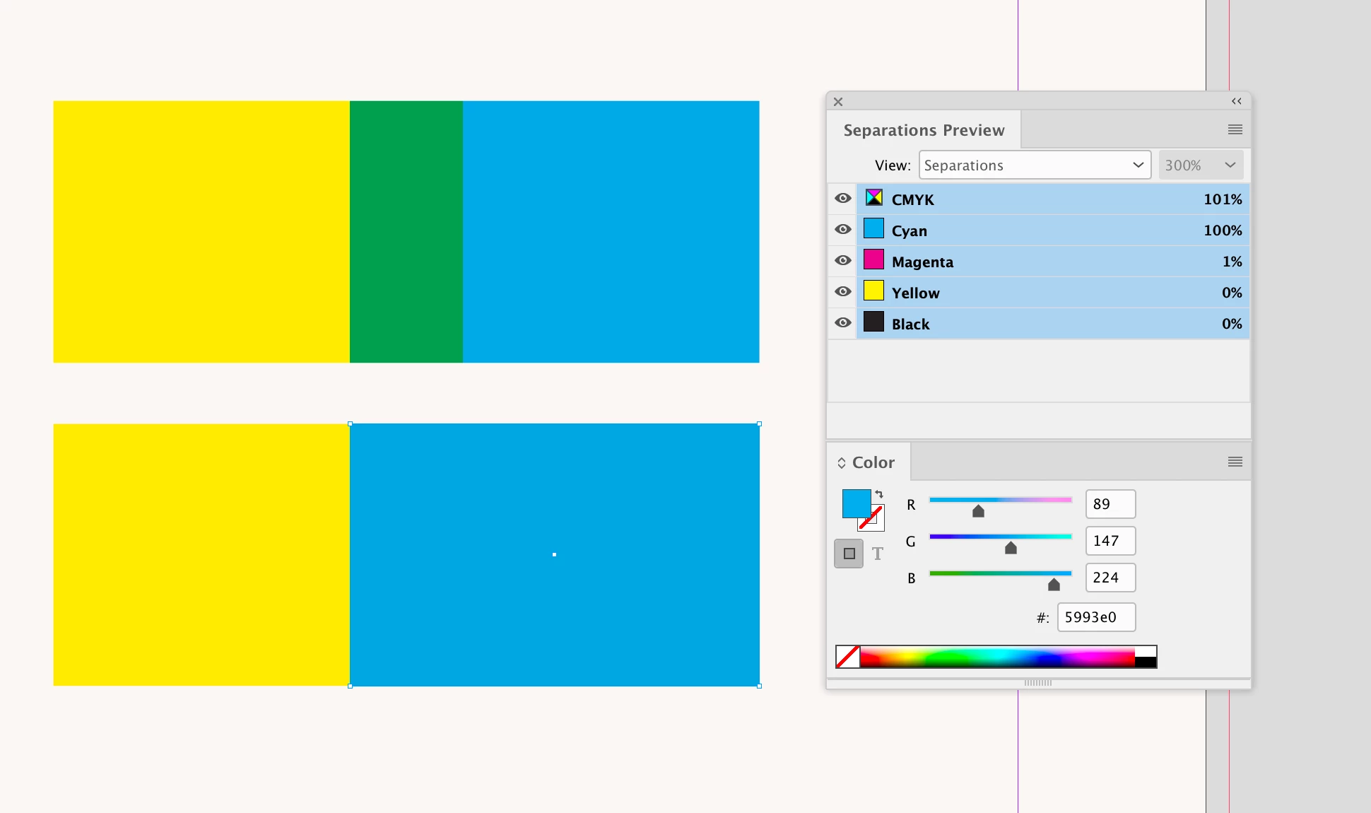

In this case the term Overprint Preview is a bit misleading—it really means CMYK Preview. You can set the Overprint Attribute for an RGB color, but it doesn’t do anything—RGB colors can’t overprint. Here 100% Cyan overprints 100% Yellow, but the RGB equivalent of the colors do not:

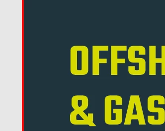

June 19, 2024
Thank you 🙂 Sadly it hasn't made a difference...it's very frustarting...I've attached a couple of screenshots to help - same document, same colour, different pages
June 19, 2024
I should add, that it looks fine in the file preview - just not when opened in Acrobat
