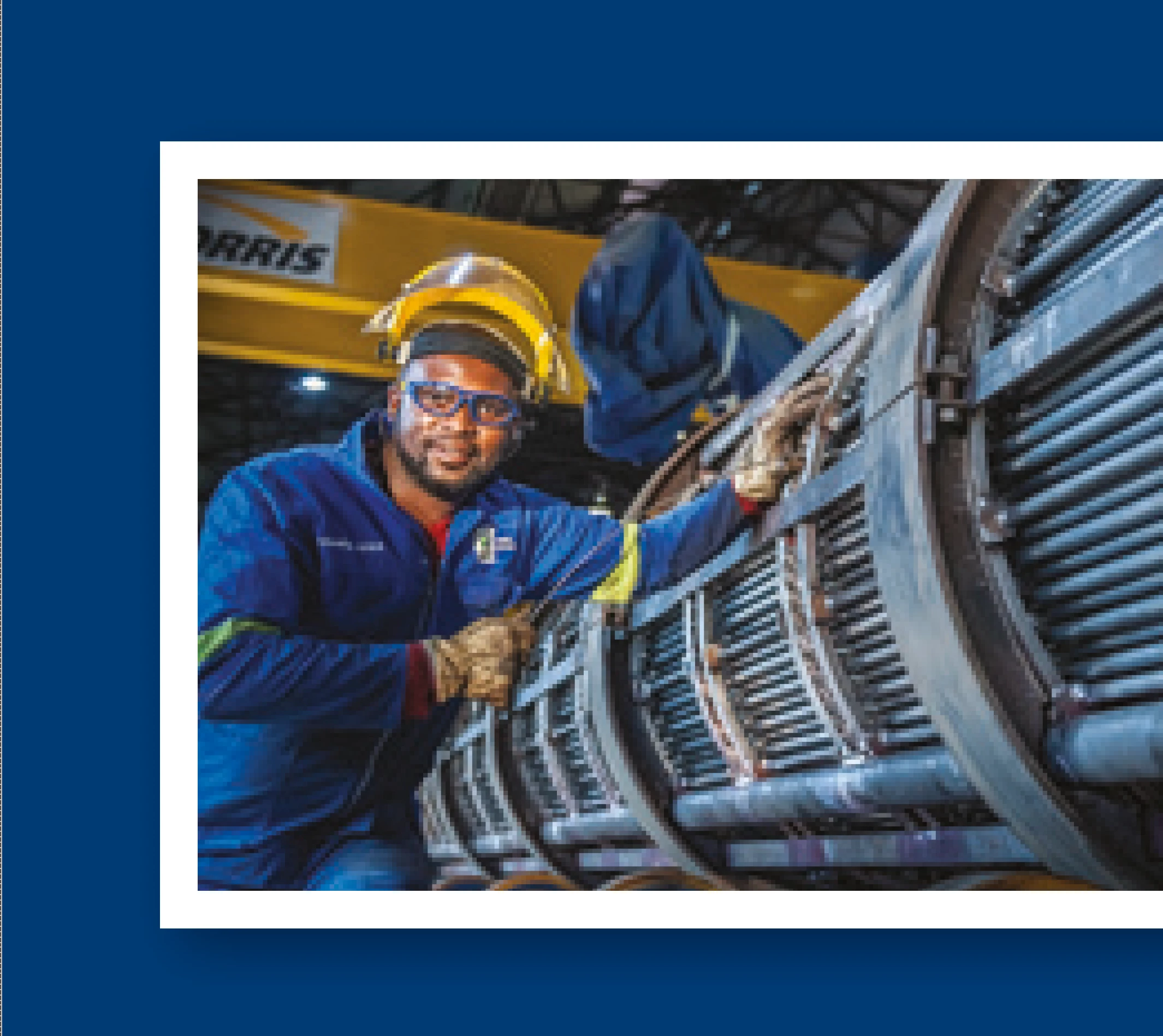

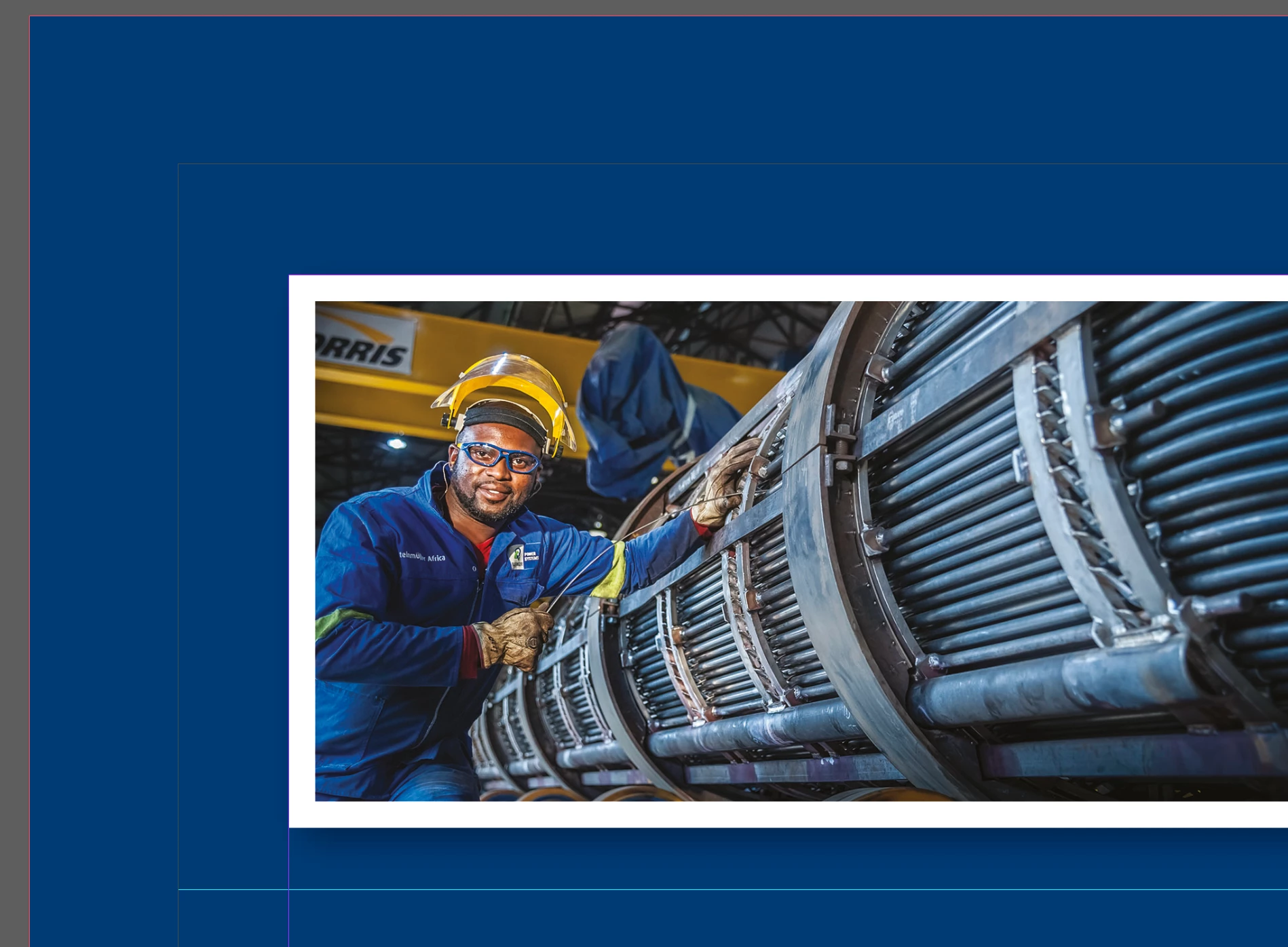

Here are images showing the high quality image in Indesign, and the low quality image in the PDF.
Could it be the image compression settings when export, that reduce the image tize and resolution?

I asked for a screen shot of the image together with the open link panel. Otherwise I cannot see what is going on.

Select a problematic image in InDesign and open the link panel to its extend and make a screen shot and post it here so we will get the relevant inormation.

Mike, could you please post more specific infomation about the contents of your InDesign layout, the exact PDF export settings you're using, and how you're determining that the images in the resulting PDF are of low resolution?
