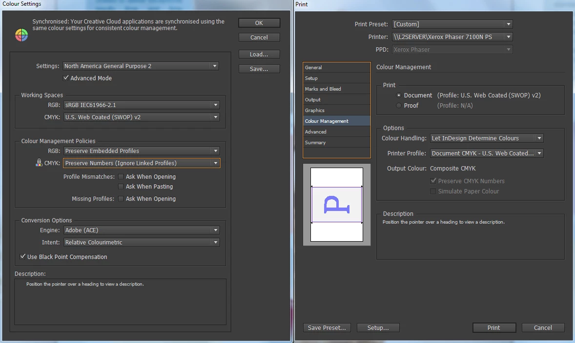

Do you let InDesign do colour management or the printer driver? Maybe your printer driver does CMYK  to CMYK colour management. We need to know your settings: used profiles, used colour management policies, used printer settings before we can help you with a fix...

These are the colour settings and print colour settings I'm using:
Due to being on a restricted network at work I don't have direct access to printer settings, so can't check whether or not the printer drivers are set to manage colour as you've suggested.
