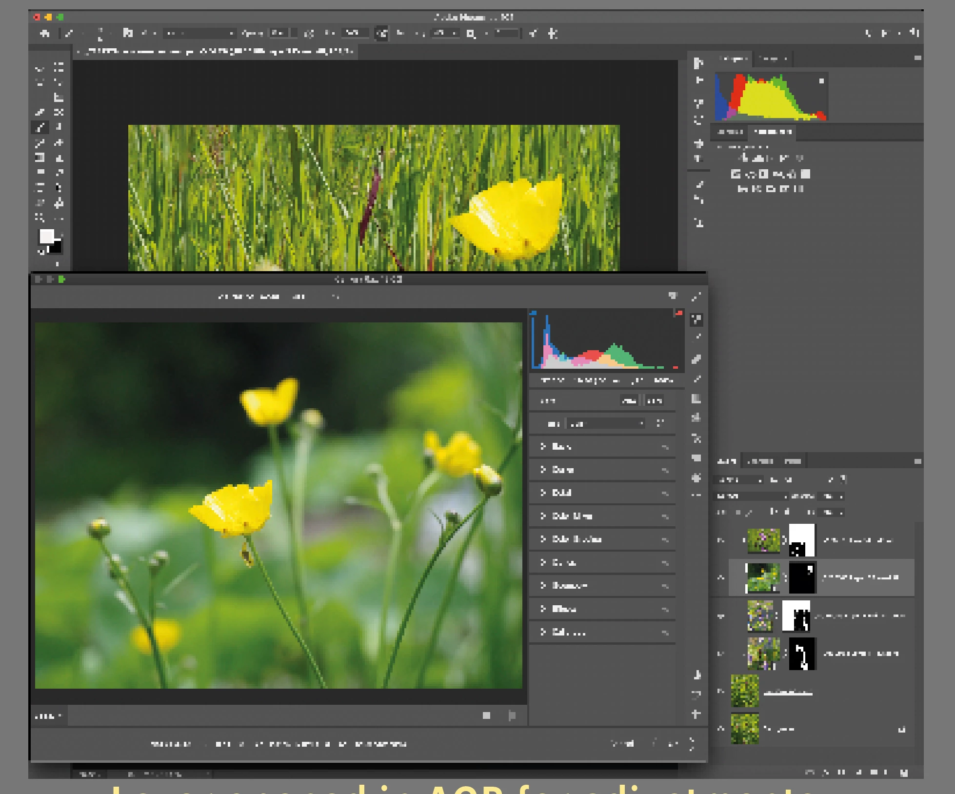

Not sure if this helps, either but two files below:  ScreenShot of the original file Place in the InDesign project and screenshot of the sad result now showing in the InDesign workspace which is bitmapped into oblivion.

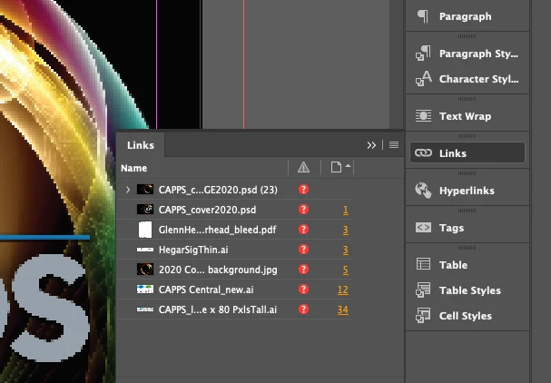

  1. First, I'd check your Links pane (not the hyperlinks, the links for placed content) and make sure none of them have the red questionmark dot in the column with the emergency triangle at the top (see attached image). The red questionmark dot is an indicator that the InDesign file can no longer FIND your image. If you used Command+D placed the image from a drive that you no longer have open (or access to), then InDesign's file can't SEE (find) the image and it cannot render a full resolution image for one it can no longer see.

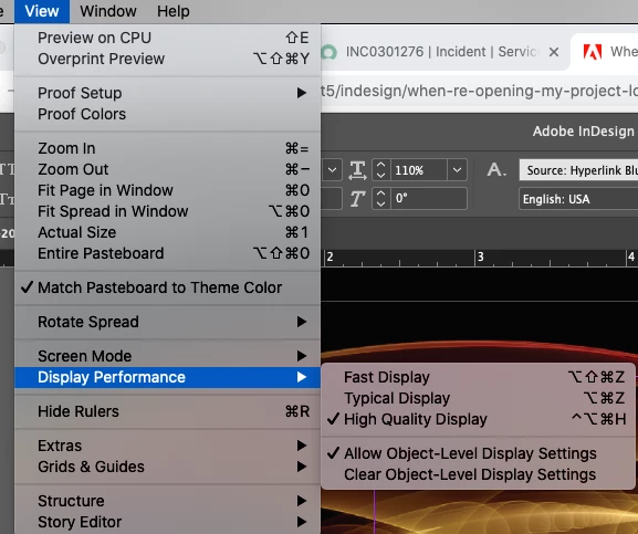

2) Check your InDesign file's View >> Display Performace ...and make sure that your file is set to "High Quality Display." Like this:
Both screen shots are of Photoshop and ACR . Was that the intent?

Hi Barb!  Guessing both screen shots, after placing them in my post, do not look much different here, at first.  When clicked on, to expand both images, it shows that the panels/info is not readable AT ALL in the "sad result" but is perfectly clear on "the original".
Please ignore the photo/image as the actual image is not important.  The intent is as an instructional document that requires the being able to read/see/decifer the panel info beside the image example.

Thank-you, MaryHelen!  Very practical advice.   The "Links" errors keep growing.  I keep all the images used for this project, in the same working folder, and have attempted to 're-link' them so many times, I quit bothering.
I do use the cmd-D to "Place" the images, from the same folder location( and drive) but the output file and PDF is stored on a different drive.  Hmmm, ... .  I will have another look at that arrangement.
As well, I will check the Display Performance, again.  Don't think it is that because everything was looking fine, when I first did the "Place" of the images.  Display was great.  Export,... not so much.  Re-opening the file, ... not so much.
