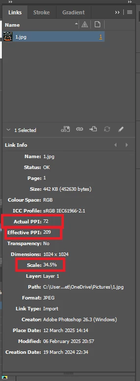

Robert at ID-Tasker
Mar 12, 2025 2:15 PM UTC
@Mattias_K12
Are you sure your linked files have enough PPI?
Can you select a link that is "bad" in the exported file - and show us what you get in the Links Panel:

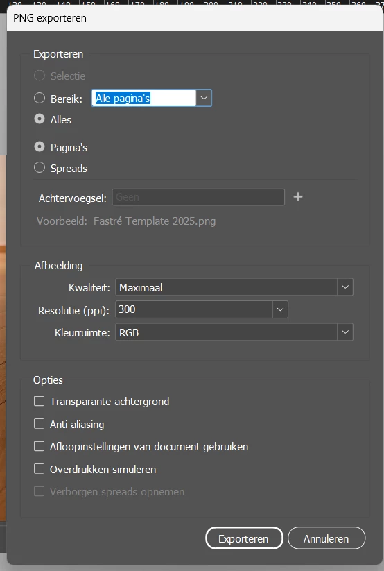

Mar 12, 2025 1:11 PM UTC
I have the latest version of InDesign, this is what I see
The thing is that the issue also happens when I try it on a different computer, so I have no idea what I'm doing wrong.
