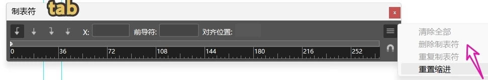

Where is the script code for these options in the tab?
I couldn't find these settings here.
https://www.indesignjs.de/extendscriptAPI/indesign-latest/#TabStop.html
Clear all
Delete tab
Copy tab again
Reset indentation
I don't want to use the 'clearOverrides' option below, I'm worried it might clear some settings that need to be kept.
texts[0].clearOverrides(OverrideType.ALL);
Thank you very much

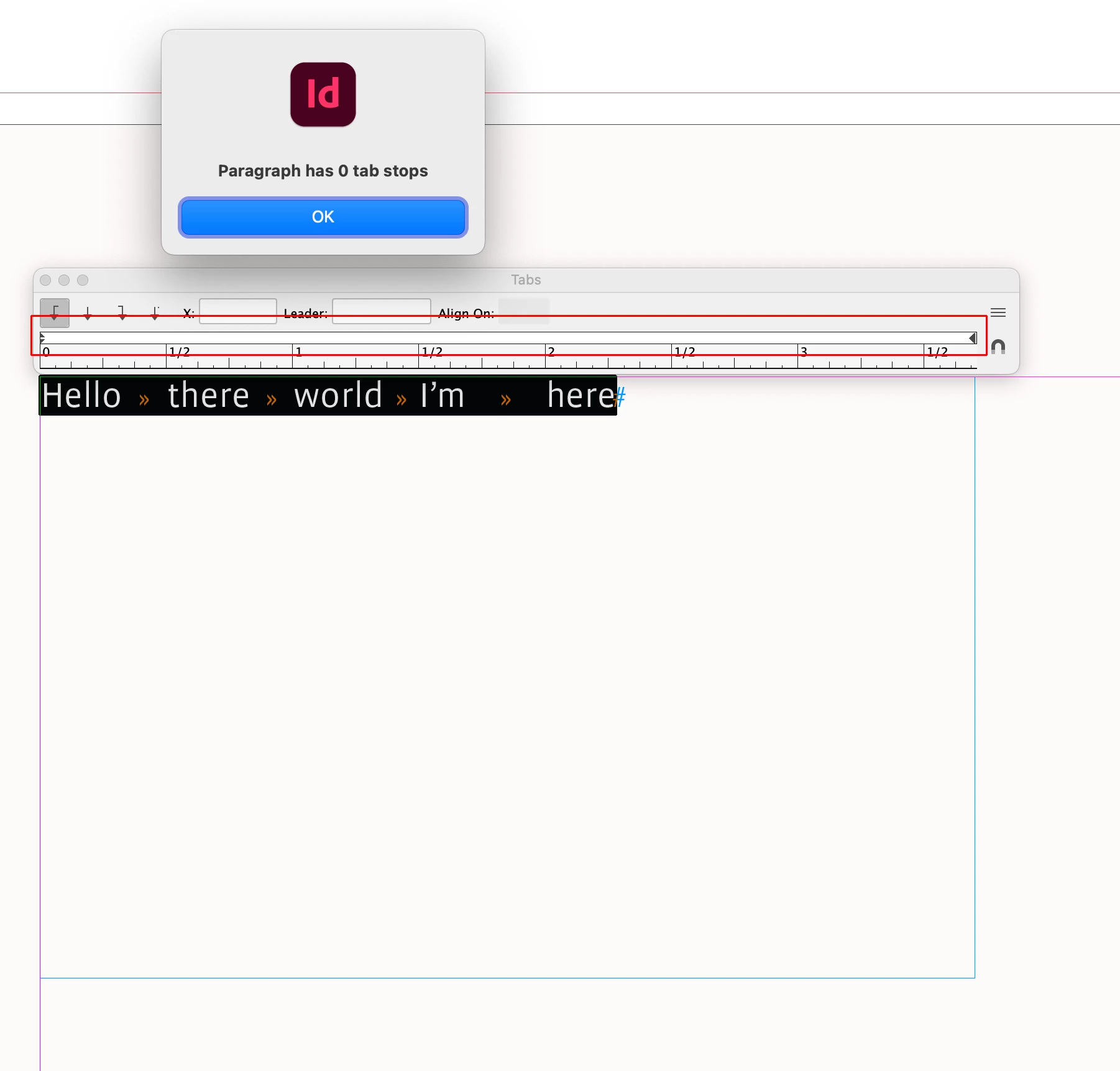

    Use add.tabStops() to create tab stops—Keep in mind the text may or may not have tab characters:
    //the first paragraph of the first story
    var p = app.activeDocument.stories[0].paragraphs[0]
    alert("Paragraph has " + p.tabStops.length + " tab stops")

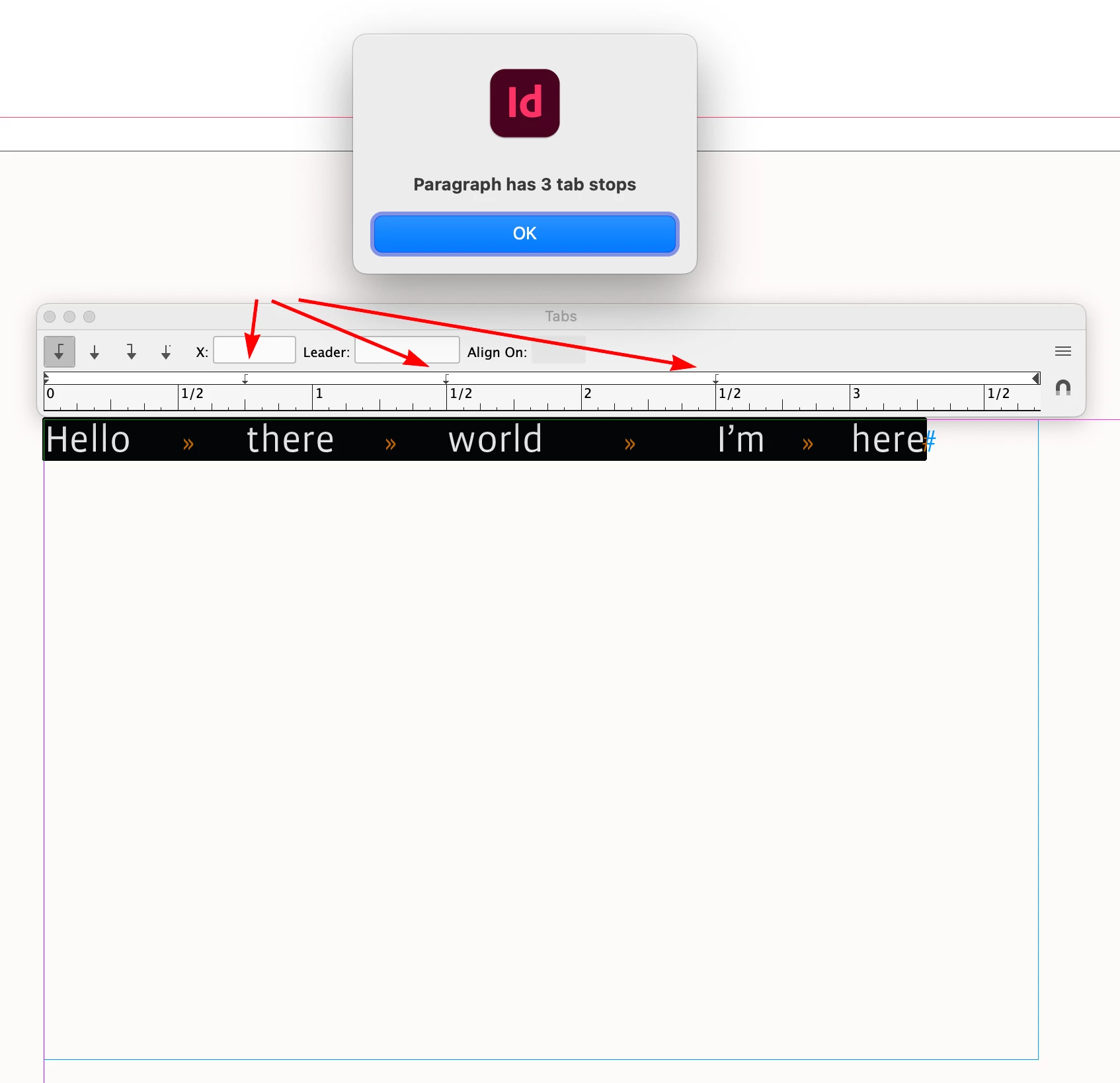

    //add 3 tab stops — NOTE the text may or may not have tab characters
    var tab1 = p.tabStops.add({position:".75 in", alignment:TabStopAlignment.LEFT_ALIGN})
    var tab2 = p.tabStops.add({position:"1.5 in", alignment:TabStopAlignment.LEFT_ALIGN})
    var tab3 = p.tabStops.add({position:"2.5 in", alignment:TabStopAlignment.LEFT_ALIGN})
    //alert("Paragraph has " + p.tabStops.length + " tab stops")
    Use remove() to remove stops. This removes all of the paragraph’s stops
    p.tabStops.everyItem().remove()
    This removes only the first stop:
    //Removes the first tab stop
    p.tabStops[0].remove()
    Also, if you want to start with no tab stops and 0 indents then before adding the tab stops:
    p.leftIndent ="0 in"
    p.firstLineIndent = "0 in"
