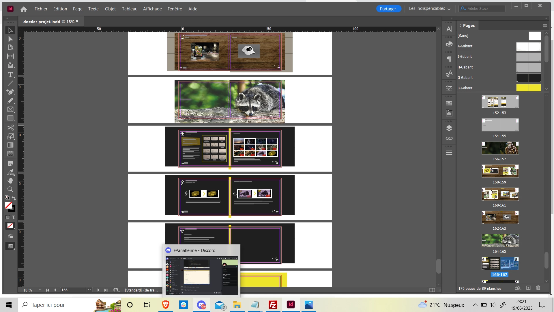

Hello, i have a great problem in my indesign
A giant white board is display on my work and embarassed to work, how i can delete it ?
Thanks

Je redis en français ce qui a déjà été expliqué : ce que tu vois est tout simplement le plan de travail. Si tu passes en mode « aperçu », il ne sera plus visible. Tu peux aussi suivre les conseils de @Steve Werner et de @Barb Binder.
Mais (ça n'a rien à voir) pourquoi fais-tu dépasser les fonds et images des limites du fond perdu ?

Hi @Meissan305993680wnt:

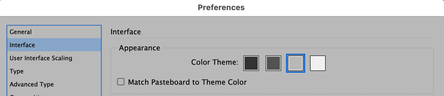

As per Bob, the white rectangles behind each spread are the pasteboards. This is usable space in InDesign — you can put content on the pasteboard that will be stored with the file, but will not print until you drag it onto the page. To make it less obvious, choose enable Match Pasteboard to Theme Color in the View menu. It will then become a darker gray.

When you choose View > Match Pasteboard to Theme Color, it is matching the Theme Color in InDesign preferences. As in other Adobe applications, in Interface Preferences you can choose your interface color from four themes:

June 19, 2023
I don't see any problem here. Are you referring to the pasteboard?
