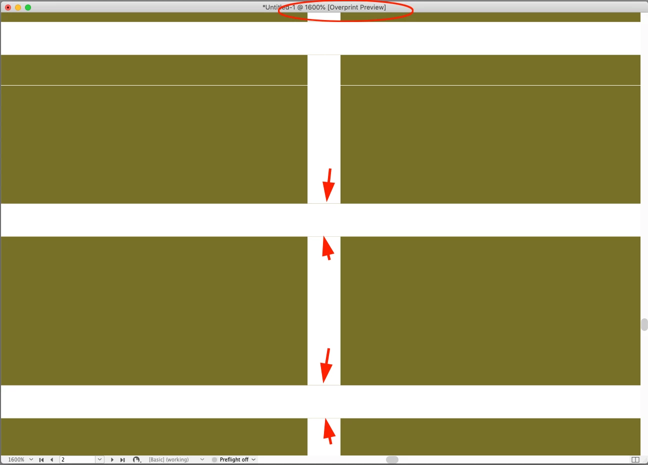

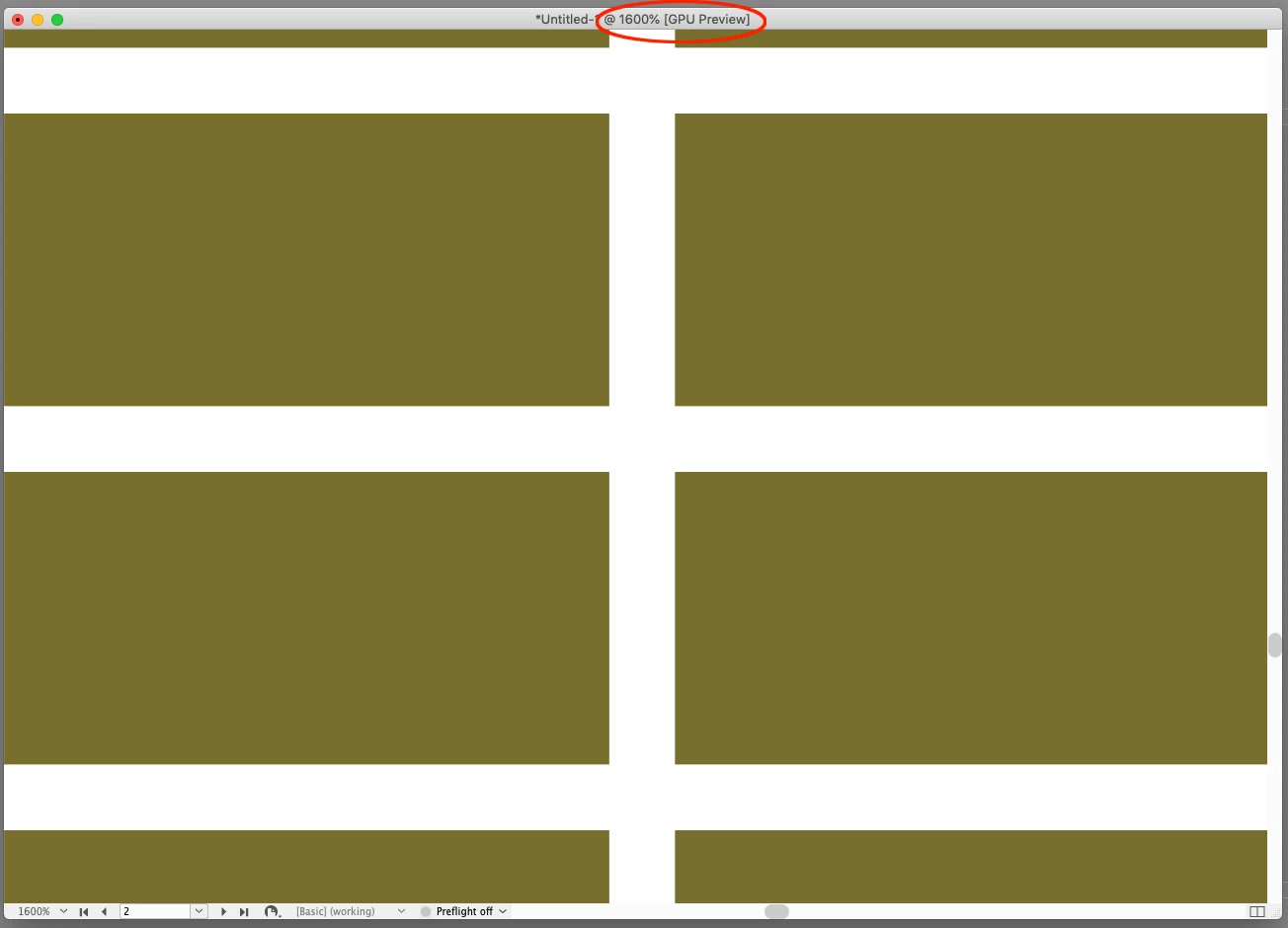

I can replicate @jodyw65132980 ’s problem by viewing on my lower res display and turning on Overprint Preview, so it seems like a display artifact.

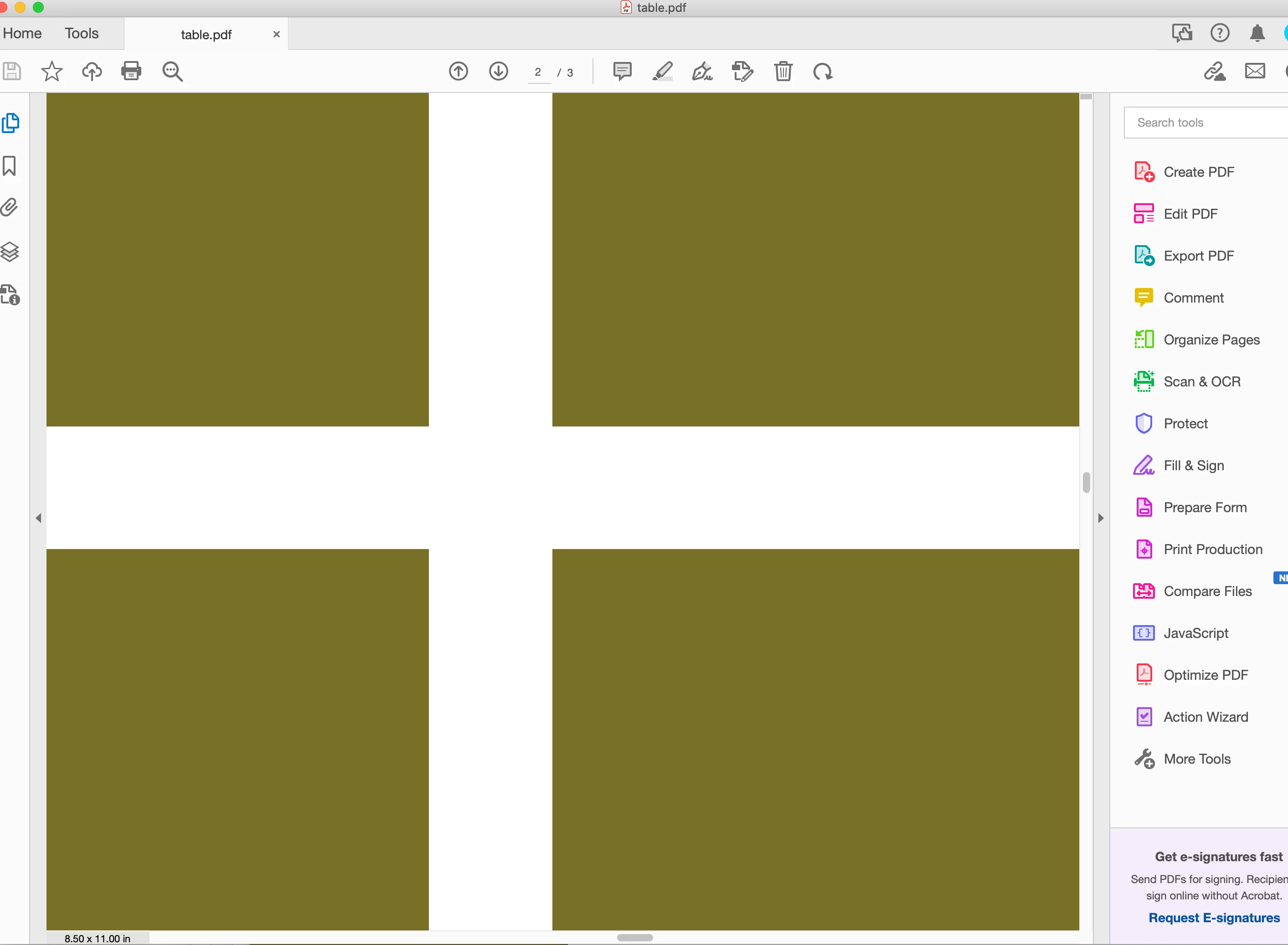

I’m not seeing the lines print or export, here’s a PDF/X4

Hi @jodyw65132980 , Do they change if you view at different Zoom magnifications? Do they show in an exported PDF?
August 24, 2022
It worked! Just by turning it into a pdf - thanks!

So, just to clarify: these were only on the display, and not on a printed page?
Export to PDF is always the acid test for anomalies like these. Displays vary so much they can do weird little things that aren't actually present in the layout.
