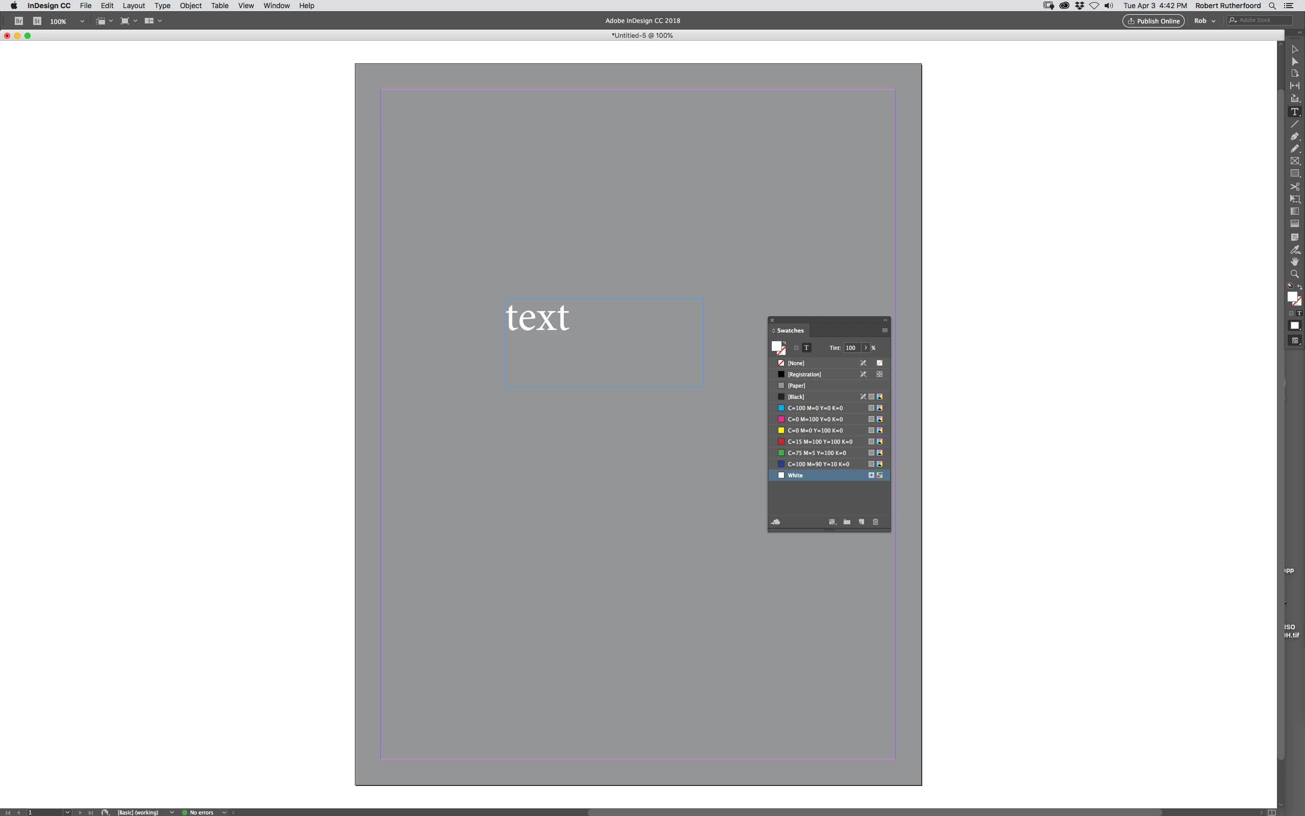

I'm trying to simulate a White Ink Spot on a non-white Paper (for instance a white ink on cardboard).
It would seem that when the Paper Color is changed, it applies an overall tone without allowing any element to inherit a lighter tone than the paper.  Is there a setting I'm missing?
Paper Color set to K:50% with text set to a Lab: 100%L Spot
First image with OverPrintPreview: off

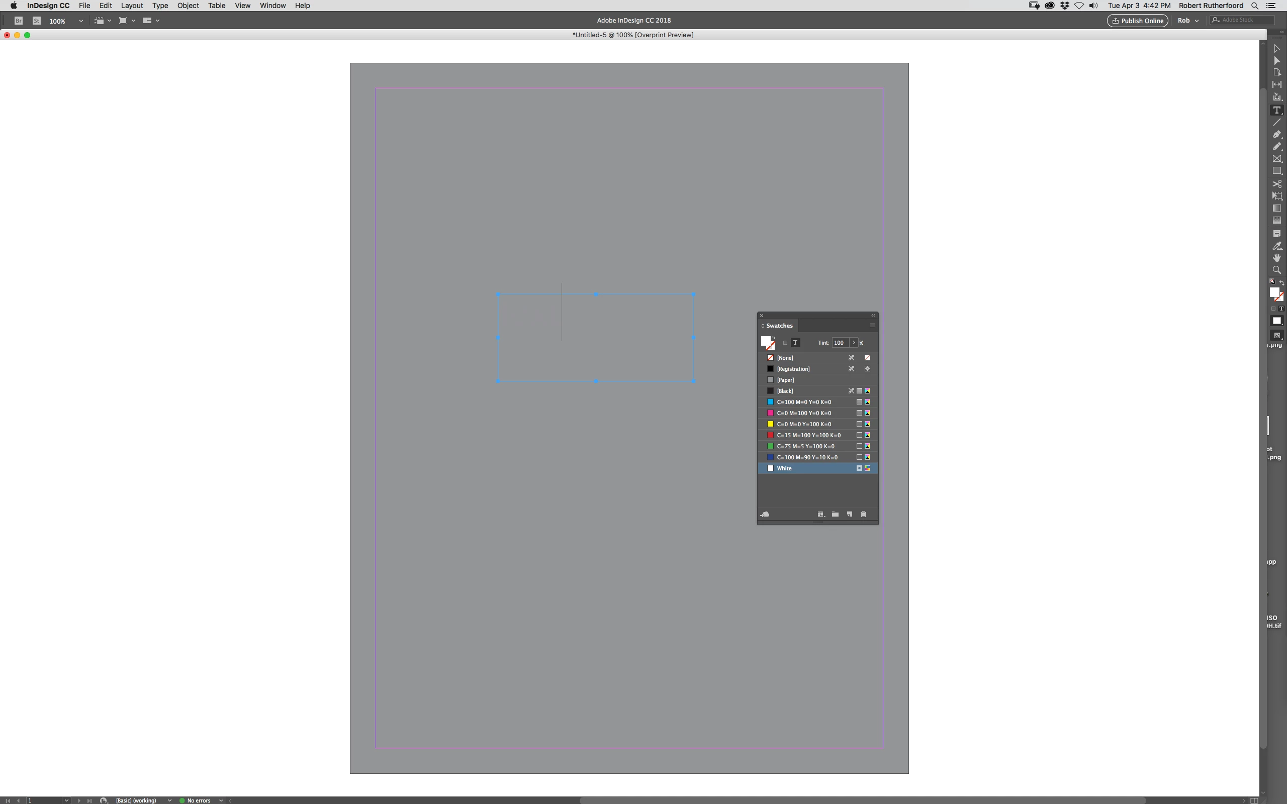

Second image with OverPrintPreview: on
I need this to look correct with OverPrintPreview on as there are other printing effects that need to preview correctly.
Eric Dumas
April 3, 2018
As far as I remember, changing the colour of paper on simulates the coloured paper, it has no intention of printing that colour, it assumes your paper is already 50%K. So overprint cannot really show the correct result.

I plan on printing a White Ink on cardboard. I understand that it will not print the paper color, but for simulation purposes I would like the paper color to be non-white.  But I would like the White Ink portions to appear 'whiter' than the substrate.
Also, another application I have planned, is printing 4-color on a transparent film.  The product will need to overprint on a Spot White (so it maintains it's highlights and full color range) while the shadow of said product will not (thus being printed on the clear film).
I hope I have explained that sufficiently.

I think, you cannot simulate this with InDesign.
Other than using a filled rectangle in the background as your paper simulation.
Tried some things with the ink manager with a spot color: Changes in ink density, opaque vs non-opaque and a simulation of the paper with a color profile. Also tried to define the spot color with CMYK 0|0|0|0…
Would be glad if someone could proof the contrary…
