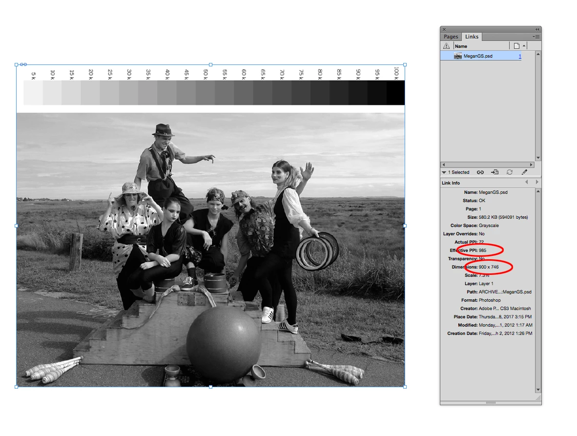

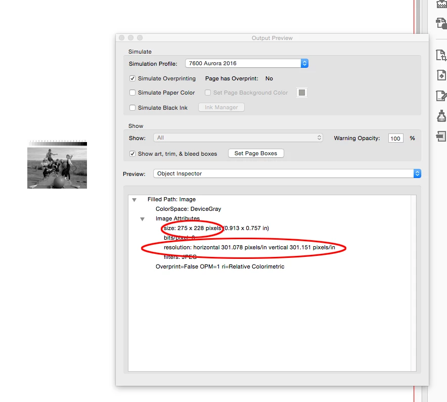

    You can check the exported resolution in AcrobatPro's Output Preview>Object Inspector.
    So here my image is starting with an effective res of 985
    Exported to interactive it is downsampled to 300ppi and the pixel dimensions are now 275x228. I can't stop the downsample with an interactive export

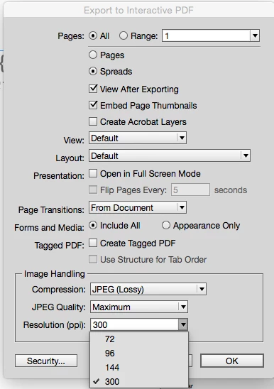

    Interactive PDF Exports have always enforced a maximum resolution. Here's 2014's dialog:
    So any image with an effective resolution over 300 gets its resolution lowered. In your case there's a huge drop in res from 7851 to 300. The effective res (not the actual res) determines whether the image will be downsampled.
    If you export your document to a Print PDF and turn off Downsampling in the Compression tab, you will see that the images don't change.
    If you really thing something has changed you can install older versions via your CC account and test.
