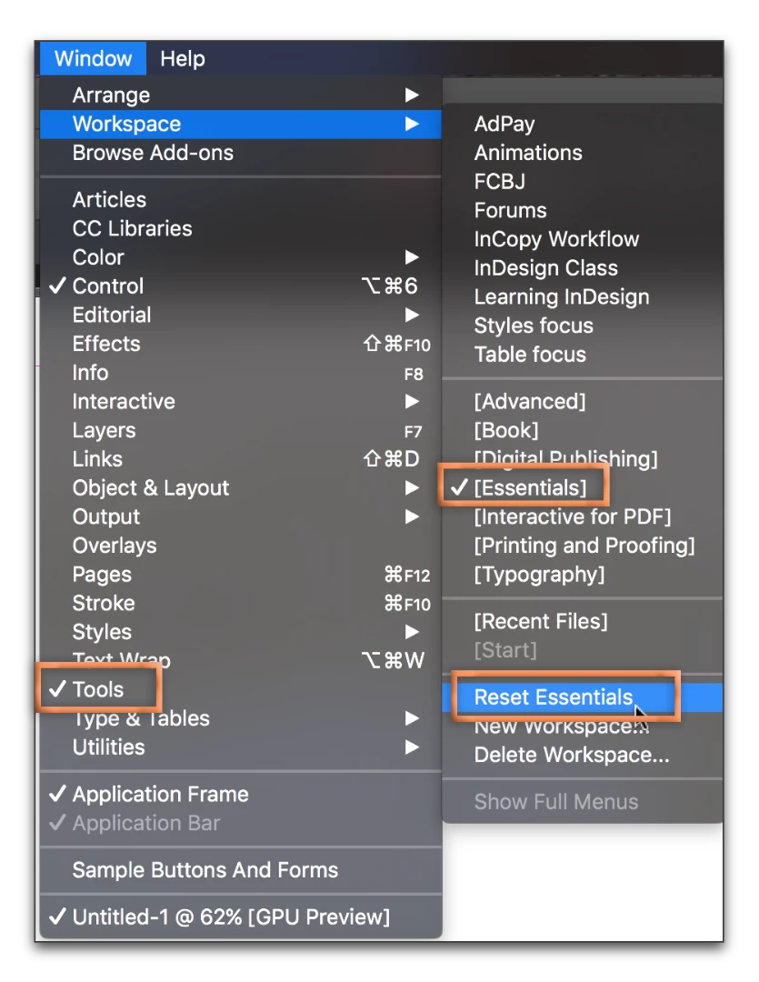

    Can you be more specific please. I have the exact same problem. The ToolBox just went "blind" , only the text box is "active", the rest are "not active". Please show a picture since I have the program in another language
    This does not sound like this same issue that was described by gamu_mac​, who simply reported that the frame edges were not longer visible.
    A screen shot from you would be helpful here because I don't know what "the toolbox just went 'blind'" means. If the toolbox is no longer visible, try:
    1. Window > Tools and/or
    2. Window > Workspace > Essentials, followed by Window > Workspace > Reset Essentials
    Or, if the software is misbehaving, trash your preferences: Troubleshooting 101: Replace, or "trash" your InDesign preferences
