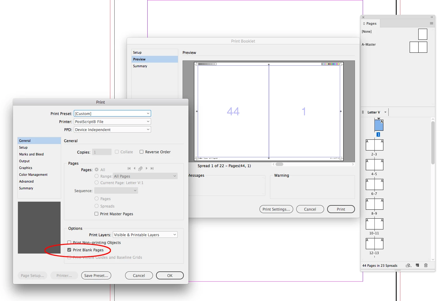

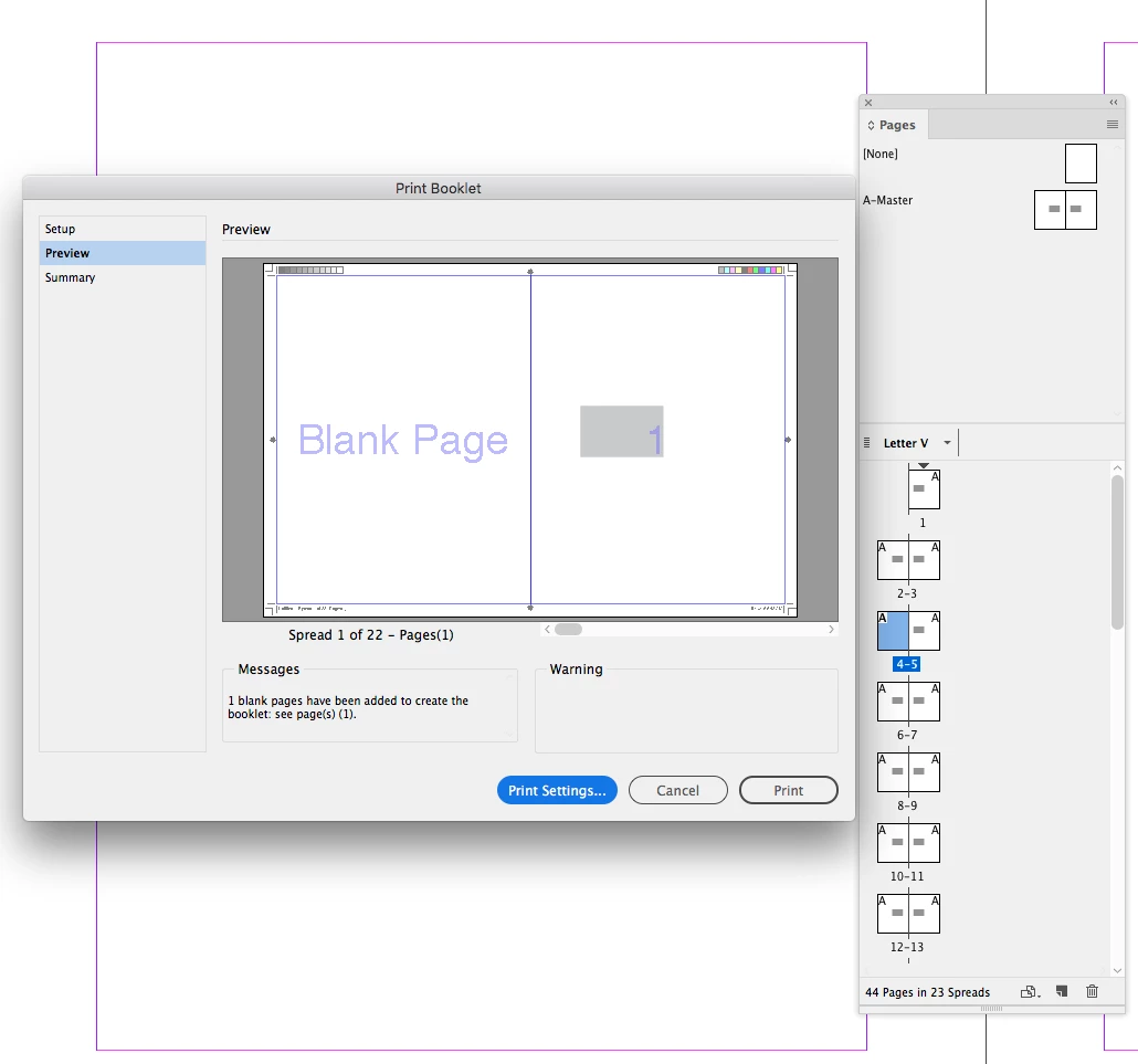

    Make sure you have Print Blank pages checked in Print Settings>Print>General. Also, are the pages setup as normal facing pages as I'm showing in my Pages panel?

    Here I have an Object on all of the pages except page 4, which is blank. Unchecking Print Blank Pages gives me this:
