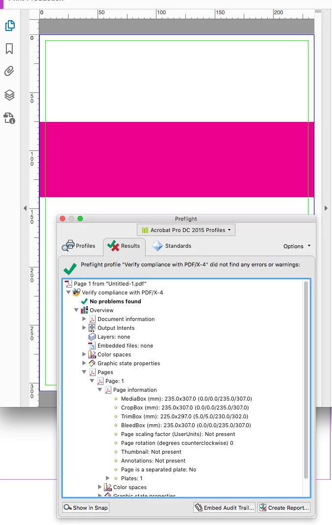

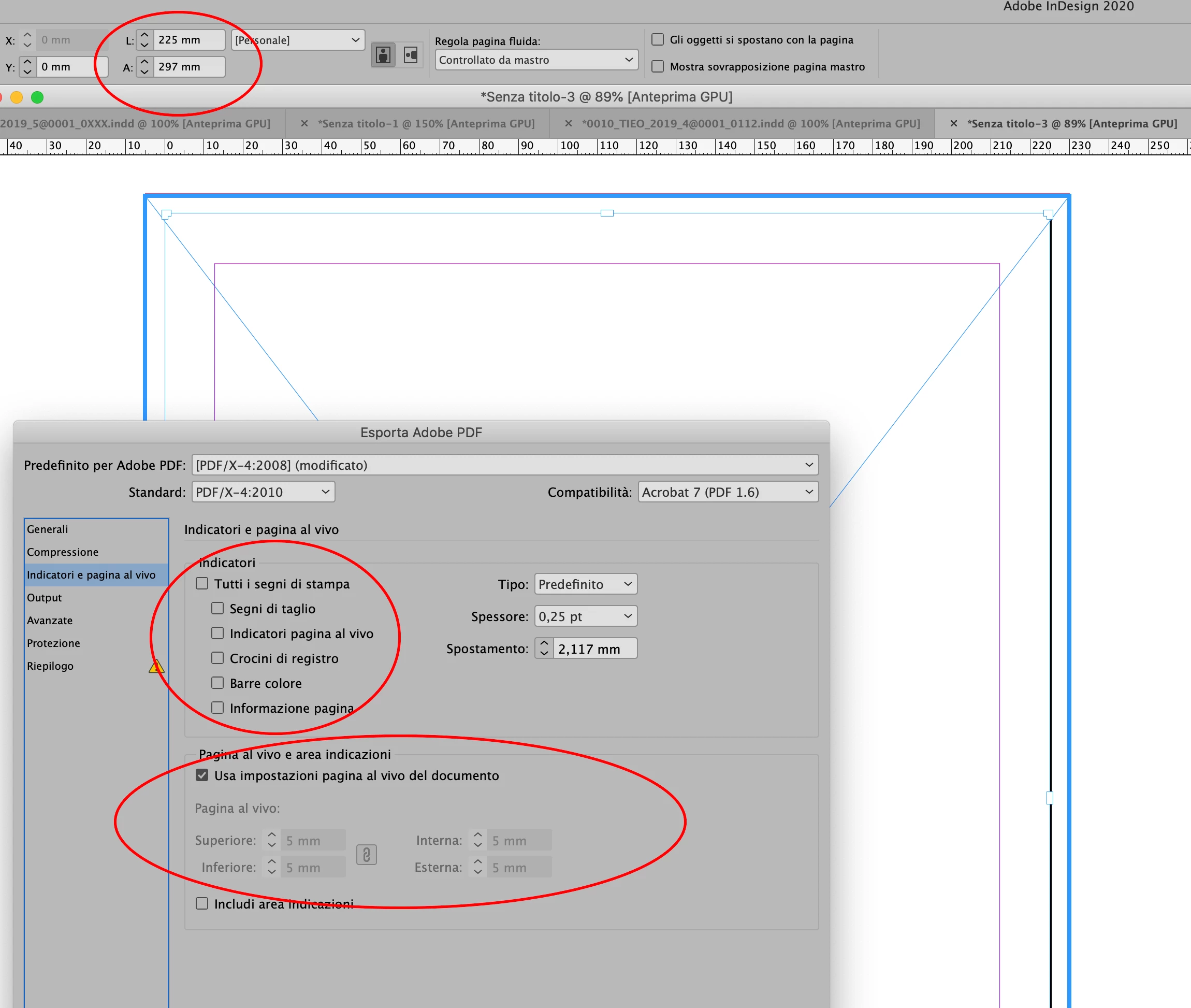

You could export to pdf with this settings
and the pdf will be 235 x 307
