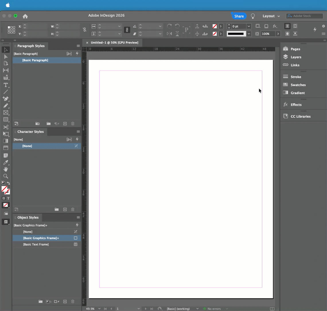

    This recording is from InDesign 2026. Nothing has changed in how workspaces are created, used or managed.
    However, over time, InDesign preferences can become corrupt and InDesign will begin behaving erratically, just as you are describing.
        Here is a second copy of the link that Leo gave you: https://www.rockymountaintraining.com/adobe-indesign-rebuilding-preferences-cache/  Please work your way to the bottom of the post and then come back and report the results.
        As an alternative, you could also download the Adobe Creative Cloud Cleaner tool to fully remove InDesign, and then reinstall it. https://helpx.adobe.com/creative-cloud/apps/troubleshoot/diagnostics-repair-tools/run-creative-cloud-cleaner-tool.html (This is not the same thing as uninstalling InDesign from the Creative Cloud Desktop App. That leaves preference remnants behind and so the problem that caused you to uninstall it will still be there after the reinstall. Either rebuild cache/preferences or use the Adobe Creative Cloud Cleaner tool.)
    I think resetting preferences is quicker, but both will get you to the same place. I think once you do one or the other, you'll be back to work normally again.
