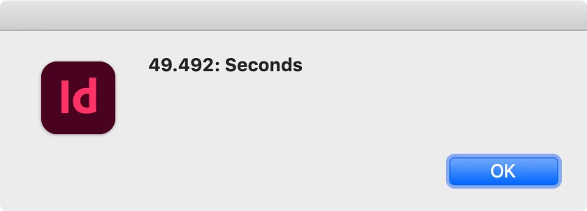

Maybe try upating the links by page so you avoid such large arrays. This was 6x faster for me on a doc with 40 links per page:
vs. all doc links
var st = new Date().getTime ()
var targetFolderPath = "~/Desktop/target/"
var p = app.activeDocument.pages.everyItem().getElements()
var updatedLinksCount = 0;
var pg, targetFile;
for (var i = 0; i < p.length; i++){
    pg = p[i].allGraphics
    for (var j = 0; j < pg.length; j++){
        if (pg[j].itemLink != null) {
            targetFile = File (targetFolderPath +  pg[j].itemLink.name);
            if (targetFile.exists) {
                pg[j].itemLink.relink(targetFile);
                updatedLinksCount++;
var et = new Date().getTime ()
alert((et-st)/1000 + ": Seconds")
