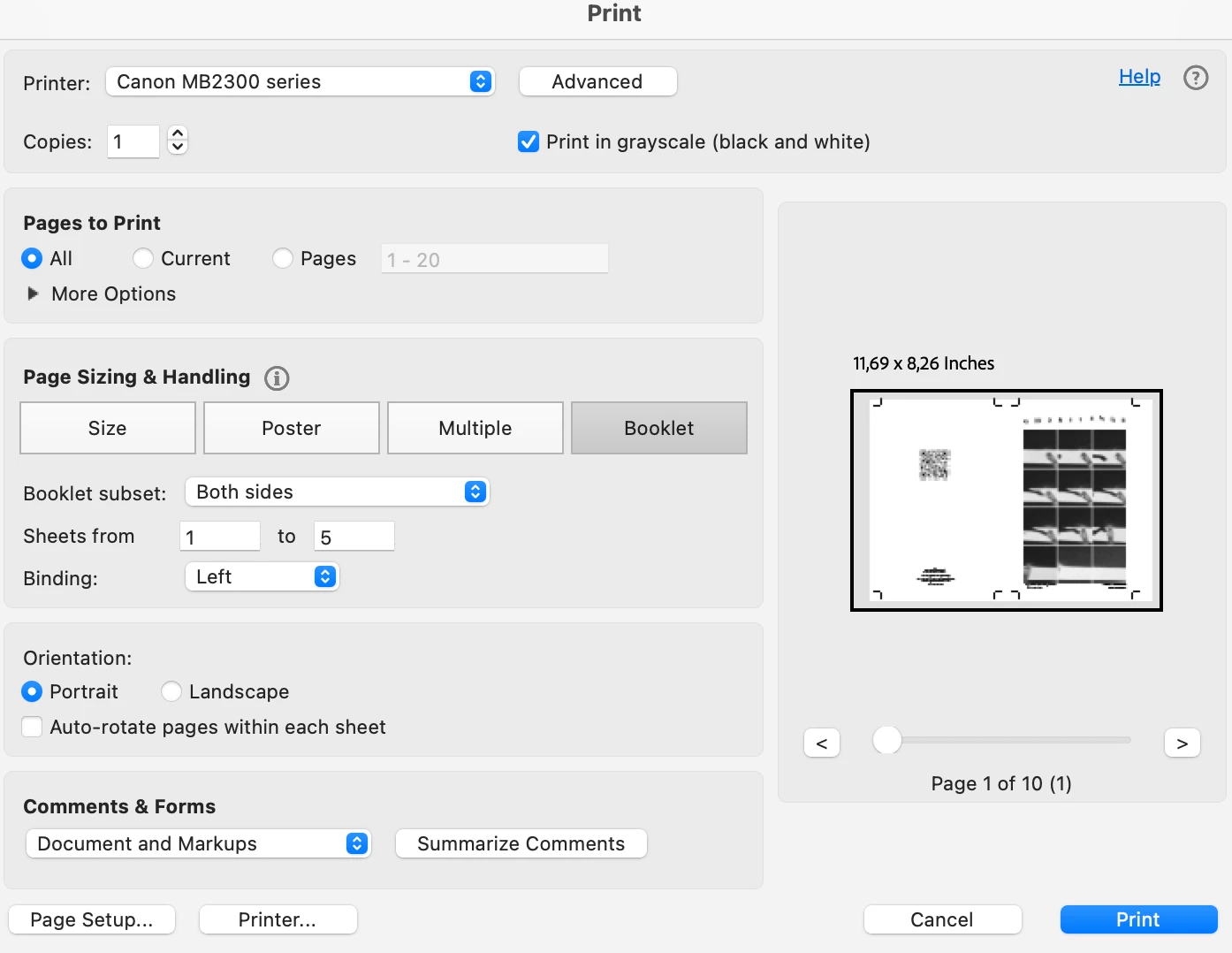

When I export my indesign doc as pdf (pages) and print as booklet, the pagination is set up correctly but there is a gutter inserted between the pages, in the centre of the spread. There is no gutter specified on my document set up. Its basically just printed paginated pages next to one another, with margins that extend around all four sides of the single page, instead of being joined in the centre of the spread. How do I remove this gap?
Printing from indesign directly works perfectly but it is not an option, the print quality is completely different and very poor.

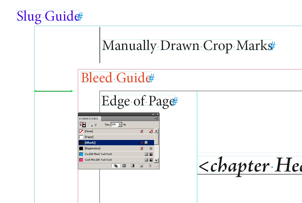

One more option is to set up with no inside bleed and add an additional slug on three sides, then add crop marks manually

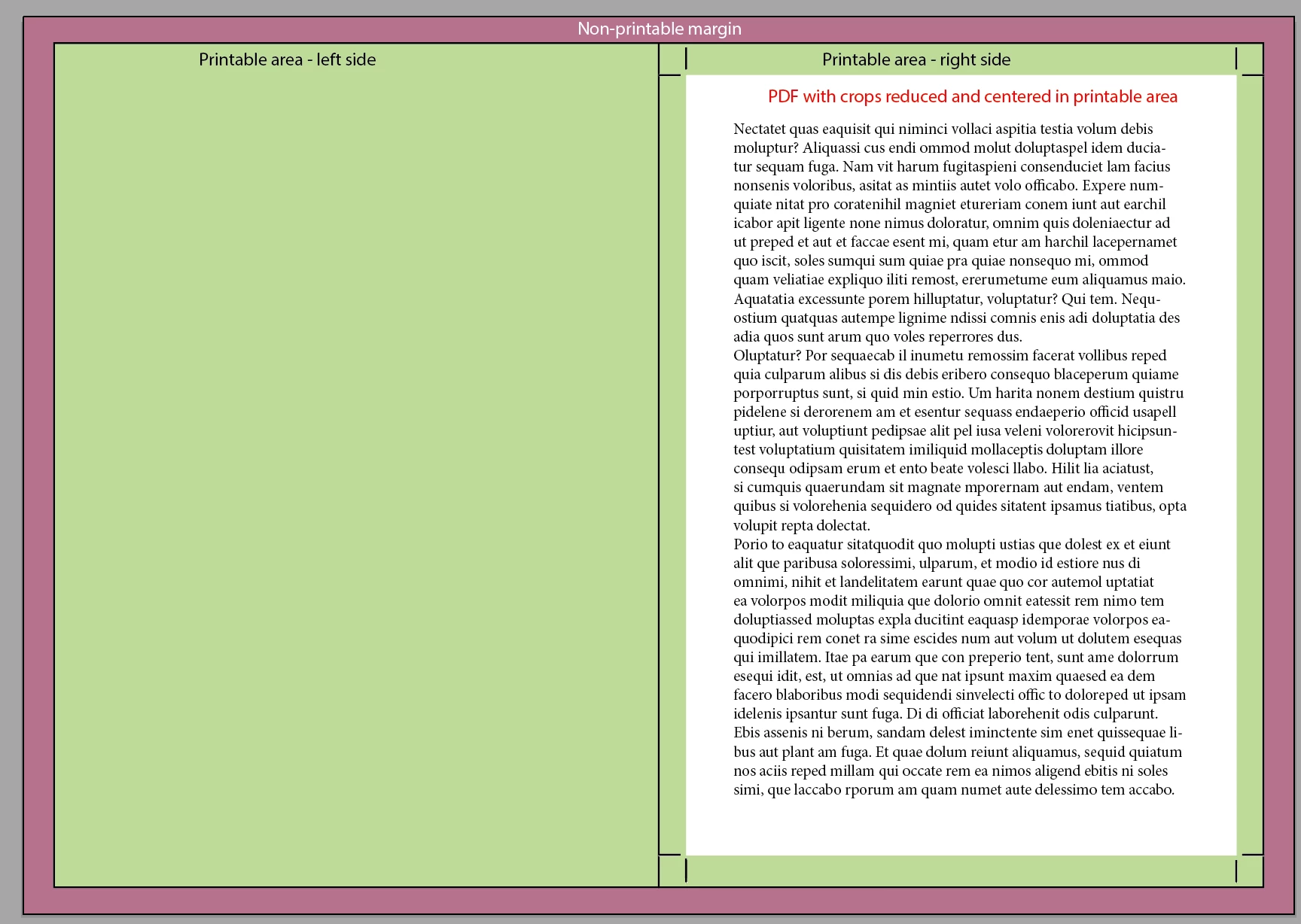

This is an example of why Acrobat's Booklet printing is so bad, as it is pretty "dumb" about imposing pages. So if your exported PDF has bleed and crop marks, Acrobat will reduce/fit that entire image of each page to fit inside one-half of the PRINTABLE area of your page, and it centers that in each area. As below:
 This is really to say, you will NOT get the results you want from Acrobat.

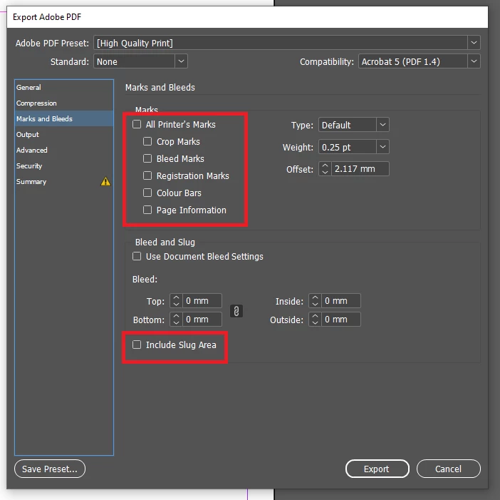

You are trying to print as a bookled PDF that already contains all those "extras" - bleeds and marks.
You need to export your PDF again - this time, make sure there is nothing selected here:

I suspect that your odd gutter is appearing with your output with crops. Adding crop marks to the output expands the page beyound your trim size, of course, and that could give you the impression of extra gutter space. The first thing I'd try is printing the InDesign PDF without crops and bleeds and see if you get better results. I'd try this first.
If that doesn't fix the issue,, I've got some questions to ask before we can delve further into your issue:
After deleting the crops, fixes get a little more complex. I'm assuming from the screen capture that you're working from a Mac. Are you printing your PDF from Apple Preview or Adobe Acrobat? Are you printing the booklet from InDesign as a PDF, then using your PDF to output the job? Or are you using, say, Acrobat to build your booklet and printing from there?
