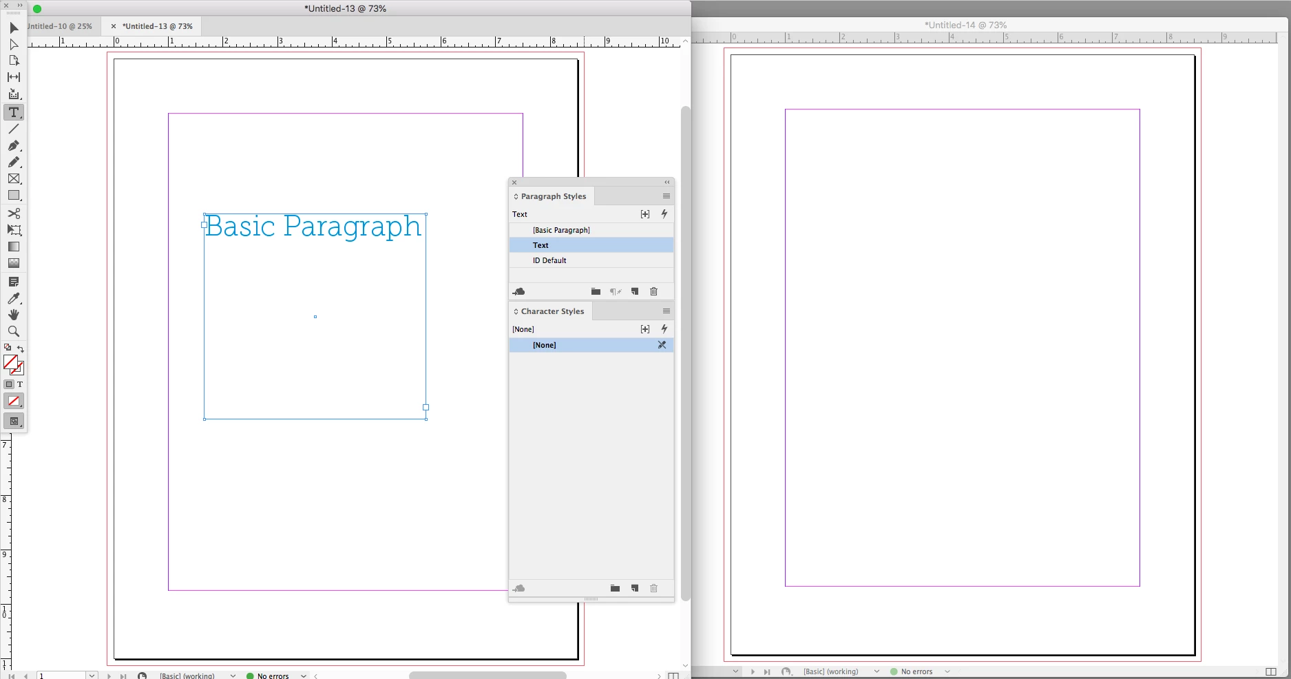

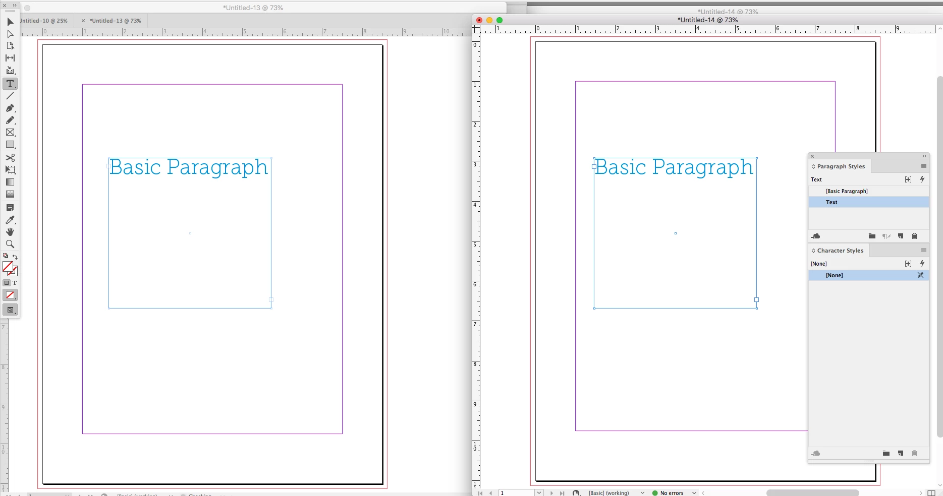

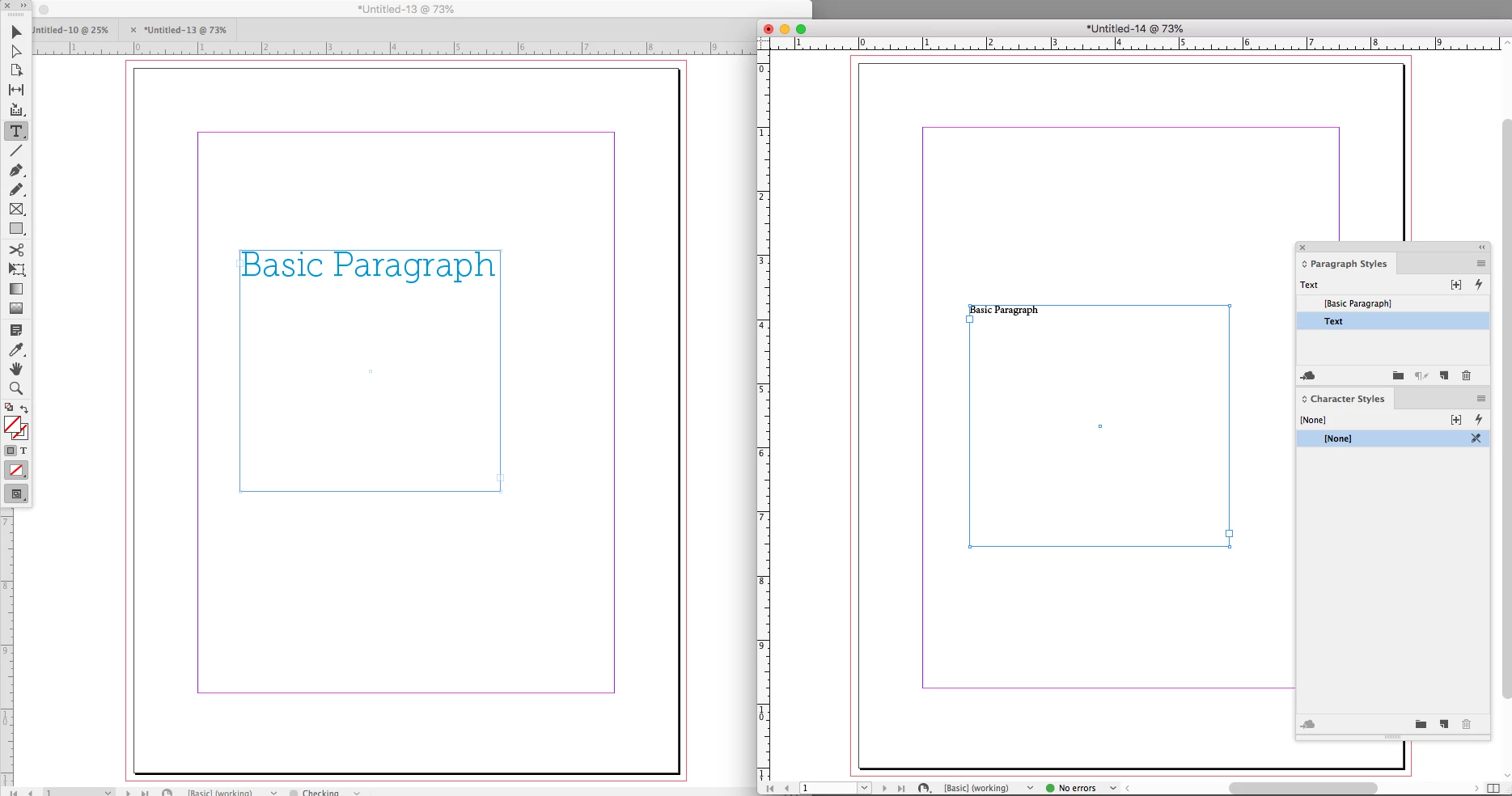

    It becomes a problem when if you share or collaborate on a project and the text gets pasted into another document where [Basic Paragraph] no longer matches, or even when the source styles are based on adifferent [Basic Paragraph]:
    So here I have some text with a paragraph style named Text applied. The Text style is based on [Basic Paragraph].

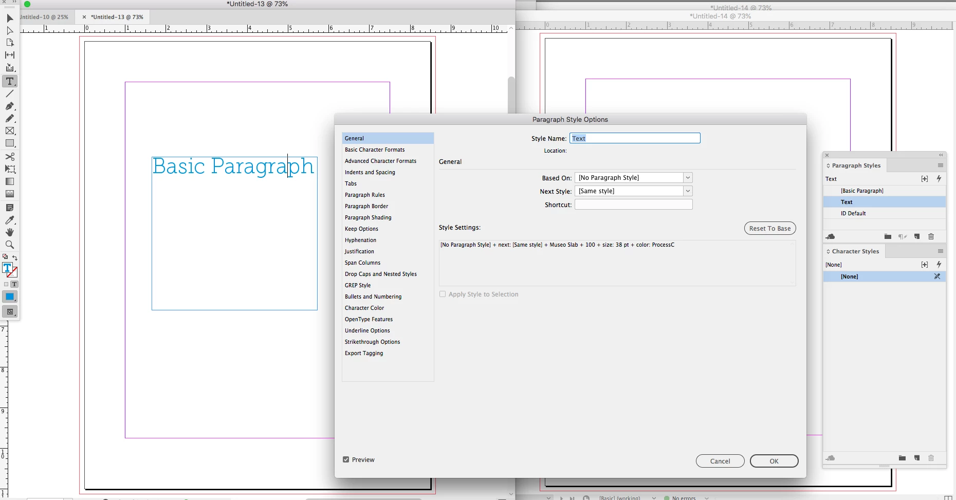

    If I paste the text into a new document with no paragraph styles, you would expect it to paste in unchanged because there is no conflicting paragraph style named Text, but that's not the case because Text is based on BPS:
    If I base my Text style on [No Paragraph Style], the text pastes unchanged:

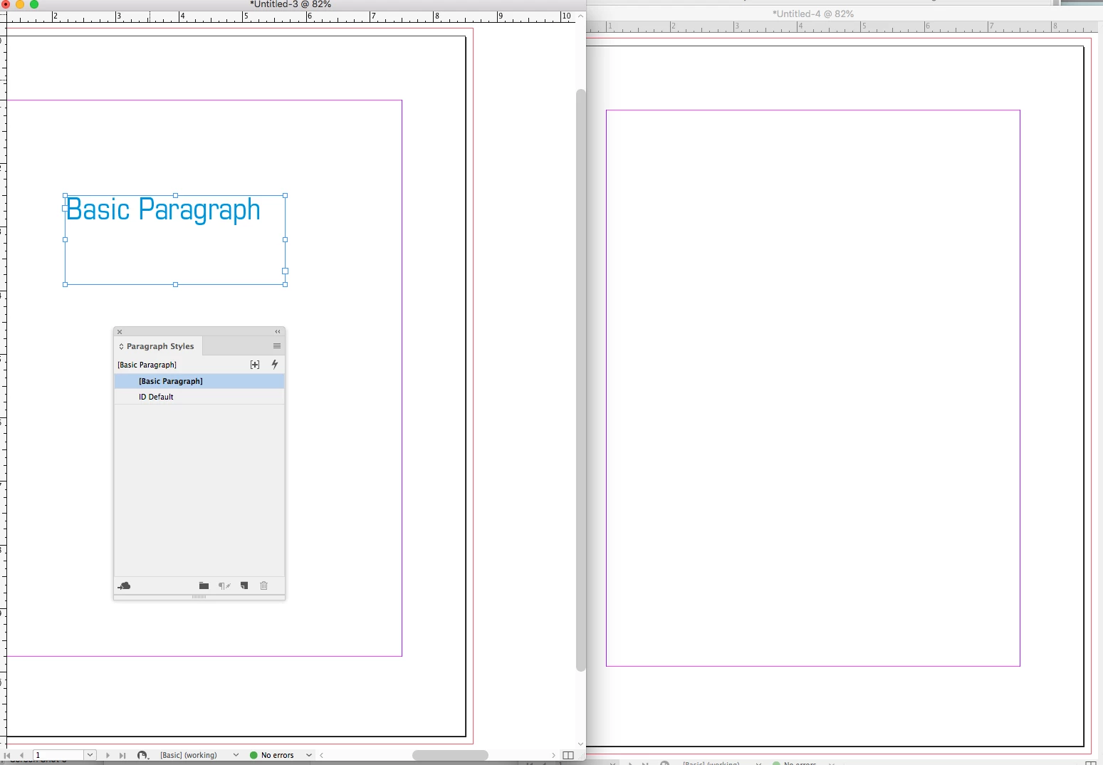

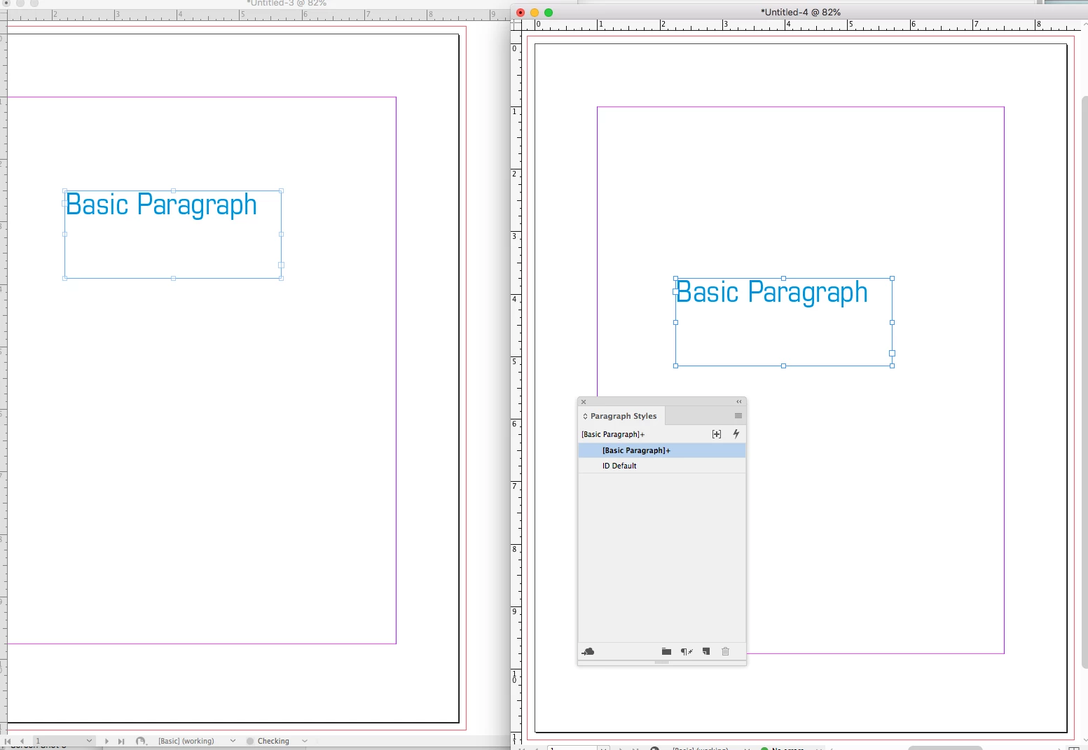

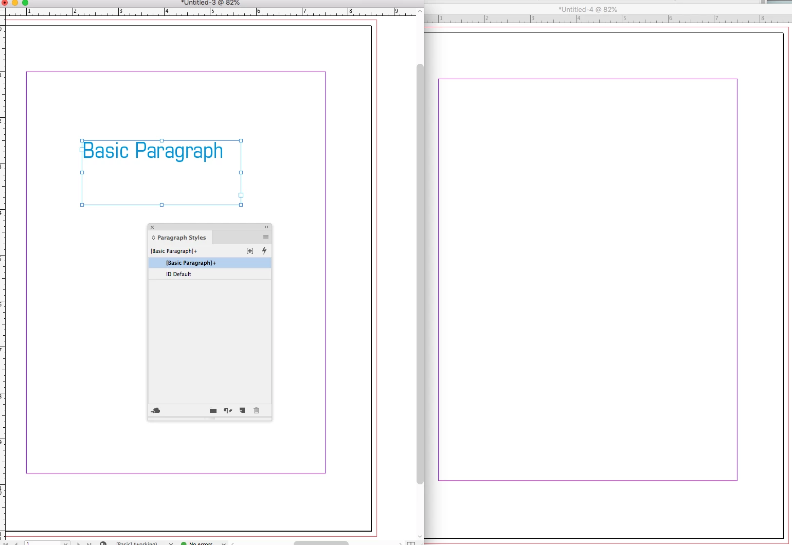

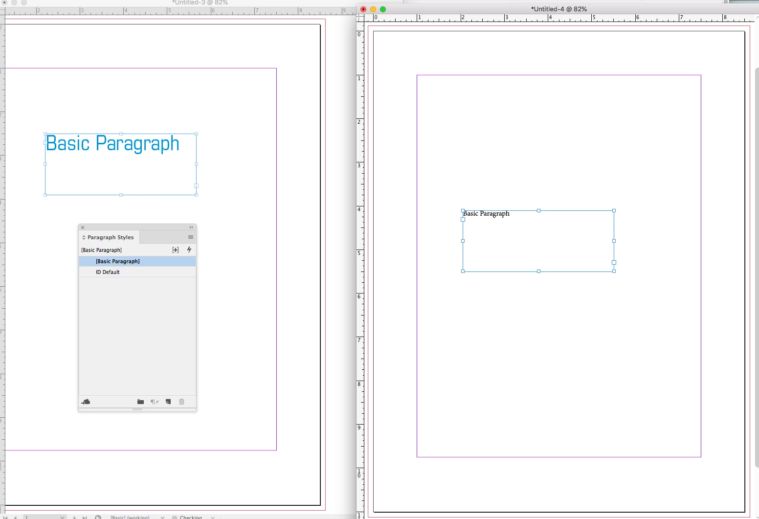

    But the larger question is: why does Basic Paragraph not behave like other styles when text is copy/pasted? Why does the incoming style definition overwrite the existing definition?
    I think it depends on if the [Basic Paragraph] style has been overridden and not redefined in the source document.
    So here I've overridden the font, size, and color, but haven't redefined the style—[+]
    Nothing changes when I paste, but the text with [Basic paragraph] in the destination is still overridden
    If I redefine [Basic Paragraph] in the source document (no +), it gets the destination's [Basic Paragraph] definition on a paste
