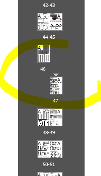

Ich habe ein PDF in eine .indd-Datei eingefügt. Das PDF wird nun nicht am gleichen Druckbogen angezeigt. Wie bekomme ich das in den gleichen Druckbogen rein? Und welchen Unterschied macht es für mich, wenn es in der neuen Zeile beginnt?

The section starts there because I moved the PDF to site 47.
Yes, this option is selected. But it does not move up if I deselect it, unfortunately.
[…] because I moved the PDF to site 47.
You mean that you moved the page? This PDF is placed on a page.

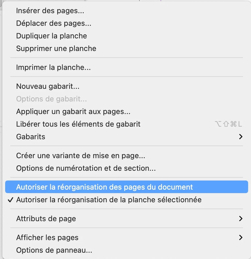

This option is selected by defaut. If your document is a facing pages document and if this option has not be unticked, it should prevent you to be able to “break” the spreads. Try to untick this option, then to tick it again; a dialog box should open, click on the No button.

You can simply drag the page 47 up, next to the page 46. Make sure that you see a heavy black line appearing like this: ]
Alicja-MAuthor
October 6, 2022
Thank you for your reply. Unfortunately, I already tried and it won't move up. 😞

Why is there a section start on page 47? try to remove it. And is this option ticked or not
