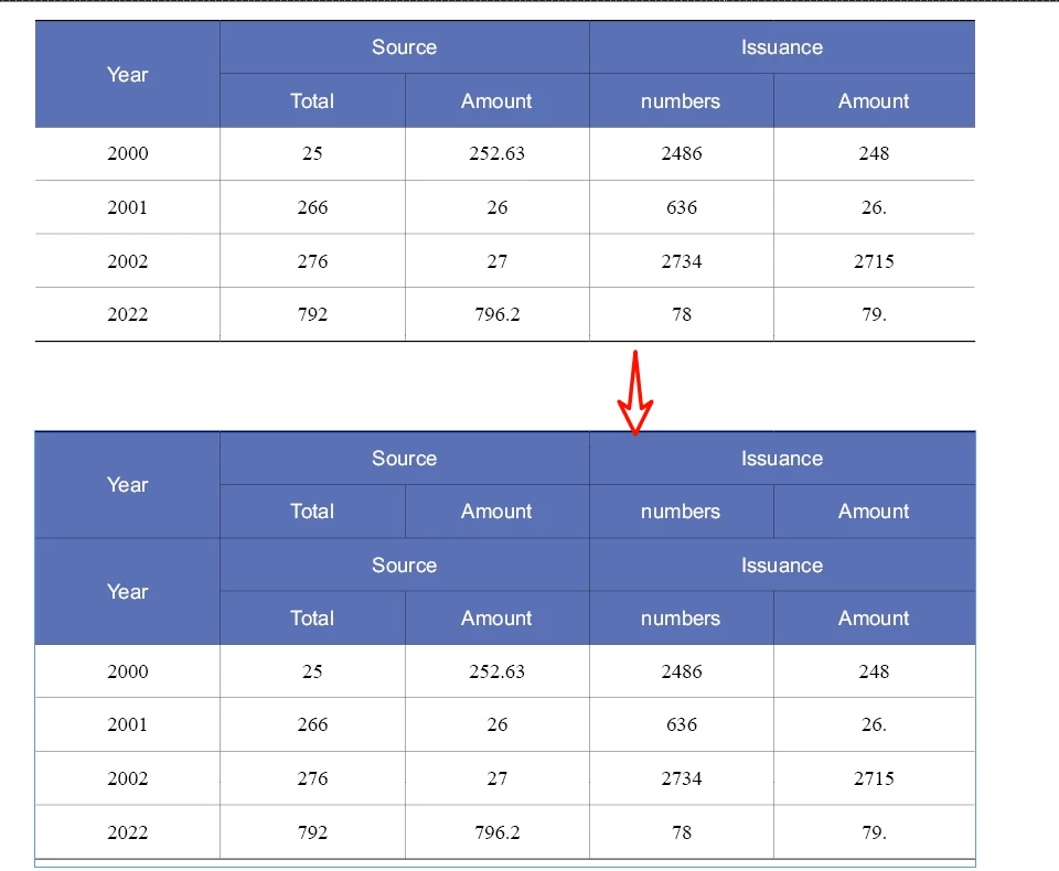

dublove
Jul 18, 2025 3:32 AM UTC
With script, How to duplicate header rows that have "cross rows and columns"?
The original script doesn't seem to work anymore?

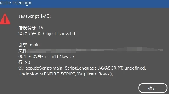

dublove
dubloveAuthor
Jul 18, 2025 2:56 PM UTC
If it's already a table header, it will report an error.
Nothing else found.
Still want to be able to execute scripts with table headers already present.
Because sometimes the table header already exists, but I still need to add rows at the top or at the end.
