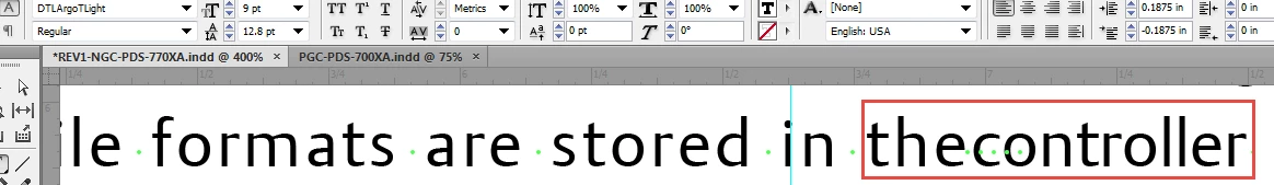

    Lara M T
    Lara M TAuthor
    December 5, 2017
    Here is a close up screenshot. I have the paragraph markers on, so you can see that I have tried to add space between the two words (the green dots), but it's not working.

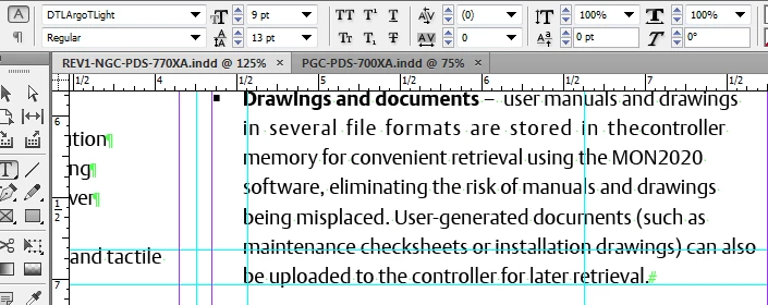

    Lara M T
    Lara M TAuthor
    December 5, 2017
    No, they are not text variables (at least I don't think so).
    Here is a screenshot.

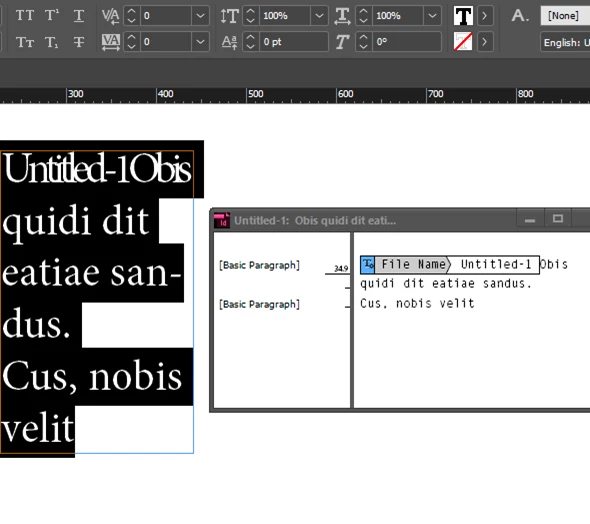

    amaarora
    December 5, 2017
    Can you add a screenshot showing the issue?
    Are they text variables by any chance?
