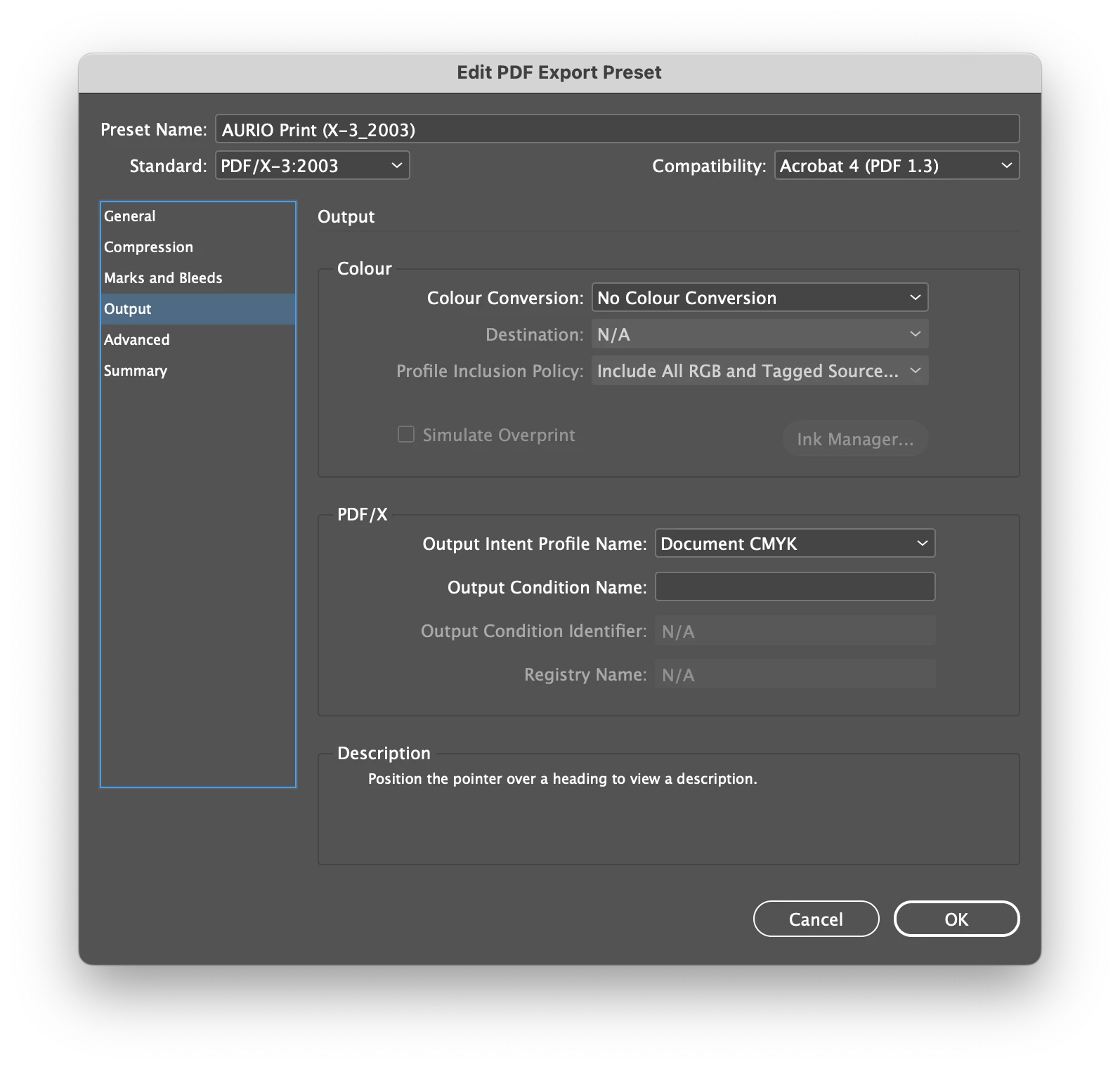

Is it bad to use default export settings? Or maybe I have just messed something up with the output settings. I will attach screenshots of the output settings used for the two files.
I normally always check Convert to Destination (preserve numbers) or Do not convert but, obviously, I must have done something wrong along the way. Sometimes it seems as if one should just let the software use the default if one doesn't know 100% what he is doing!

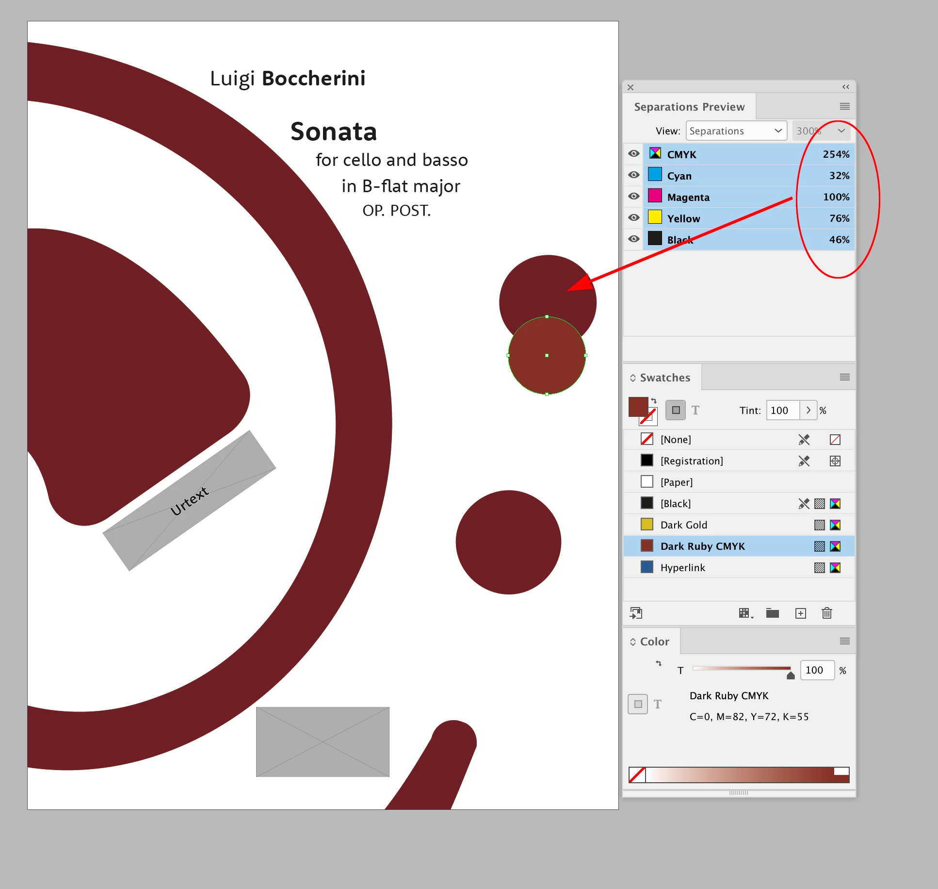

Hi @Inélsòre , The red color in the .ai file you are placing was created as an RGB swatch.
Illustrator has a Document Color Mode—yours is CMYK, so when you pick an RGB color in the CMYK document, it gets converted to CMYK via color management. In your case it would be from your Illustrator’s RGB Working Space to the document’s CMYK profile, which you have set as FOGRA 39. In Illustrator the red CMYK color is 32|100|76|46:

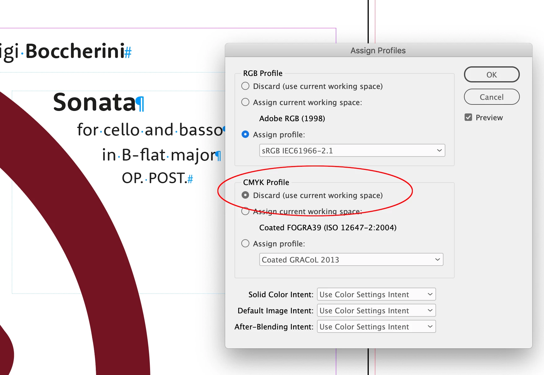

Your InDesign document has no CMYK profile assignment and its CM Policy is set to Preserve Numbers (Ignore Linked Profiles), so the Illustrator CMYK values place unchanged, and the red CMYK preview depends on whatever CMYK Working Space you currently to have set in Color Settings:

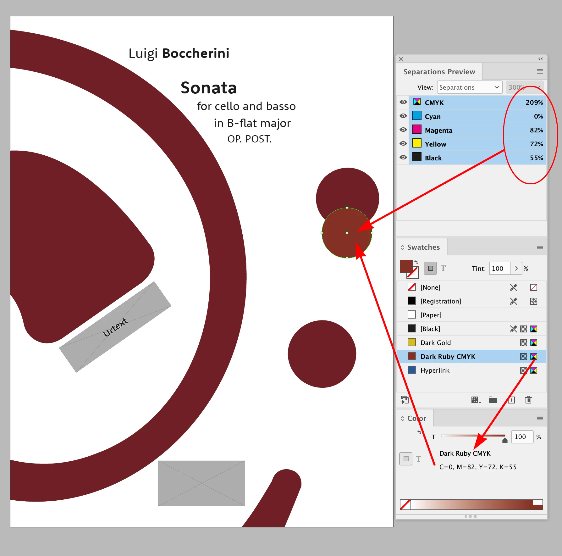

Here you can see my Separation Preview is showing that the Illustrator CMYK values have placed unchanged:
You also have a CMYK Swatch that is not used named Dark Ruby CMYK, and it looks like you built that swatch in ID as CMYK 0|82|72|55. If that’s the color you want output, go back to Illustrator and set the CMYK values of the swatch you have named as R=116 G=21 B=33 to 0|82|72|55, and maybe rename the swatch to avoid confusion.
I would also set your InDesign document’s CMYK profile assignment to FOGRA39 and when you Export use a PDF/X Standard preset—don’t use the Export setting you are showing in 9a-1.png.
