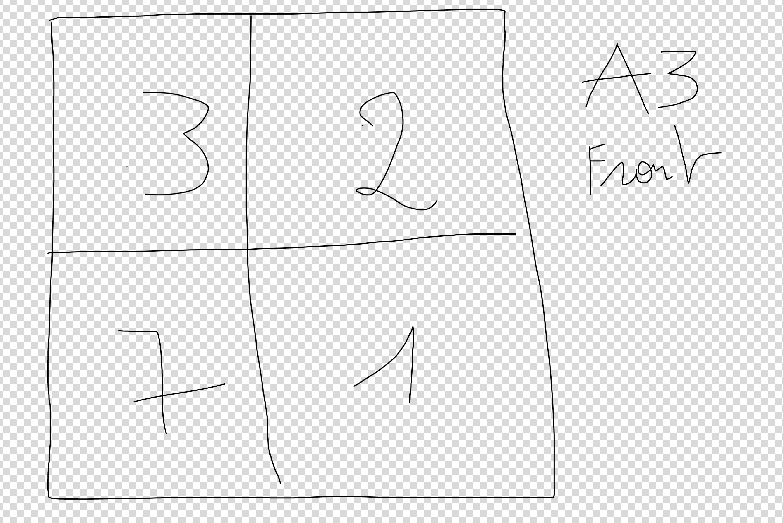

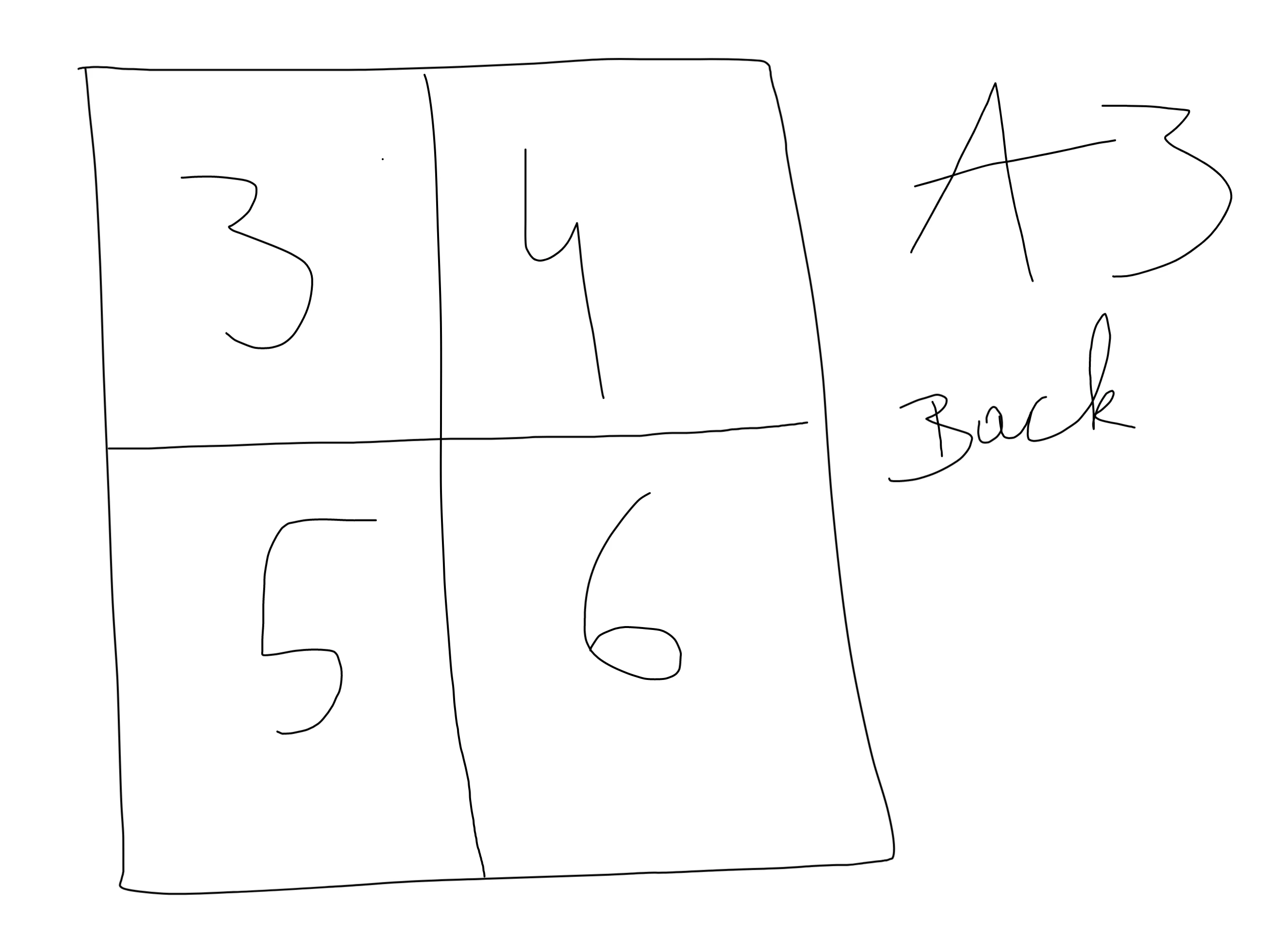

I need to make an brochure with A5 pages on an A3 format.
So we can fold the A3 in 4 so it will give us an A5 brochure that will need to be unfolded to see the other pages. See attachement for a better understanding.
Is it better to wortk using A5 pages or an A3 format with 2 pages (front and back) ?
Thank you

Here is what I would do (not necessaraly the best answer).
  1.  Create an A5 document, probably facing pages
  2. Create the design on the 8 x A5 pages
  3. Create a new A3 file and add the InDesign frames (nice trick here to insert an indd file, so when you update the A5, the A3 updates automnatically)
  4. Be careful, the way you have it sketched, you will not get a 2 sided print result. you will need to measure and test to confirm the designs are well aligned. The type of printing device you use will impact the required location.
