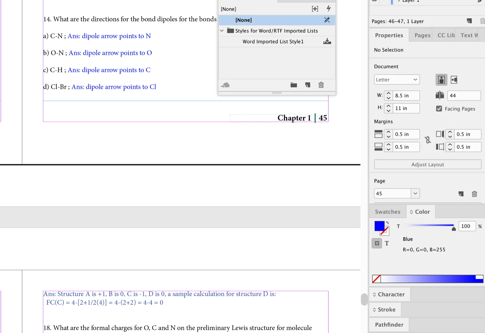

    maritb
    maritbAuthor
    May 11, 2019
    Thank you! I'm attaching a screenshot. The text at the top is what it's supposed to look like when it's changed to blue. But on the next spread it is a darker blue, even though in the color panel it's showing up as the same color when each section is highlighted. Any other advice??
    Thanks so much
    jane-e
    May 12, 2019
    Hi
    Delete the Styles from Word, then create and use your own Character styles.
    Jane

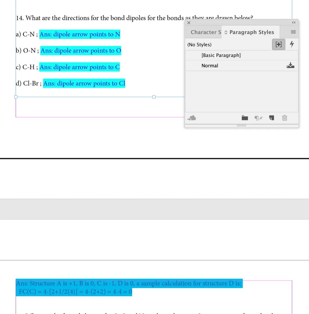

    maritb
    maritbAuthor
    May 11, 2019
    It does appear that I have a style turned on - to change the text from black to Bight Blue. But from one page to the next, the appearance of the blue is different, even though it looks like the same style has been applied. For Paragraph Styles it seems to be [Basic Paragraph] and for Character Styles it looks like it is [None]. See screenshot. The highlighted text in the bottom portion is what is the problem.
    Any other suggestions?
    Thank you so much for your time!
    jane-e
    May 12, 2019
    Hi
    Click the plus button in your paragraph panel to turn off "Show Overrides".
    The alternative (best practice) is to use styles for everything.
    Jane
    Mike Witherell
    May 1, 2019
    If it is the background that is cyan blue, then you must have turned on the Style Override Highlighter button in the upper right corner of the paragraph styles panel (or the character styles panel).
    Mike Witherell
