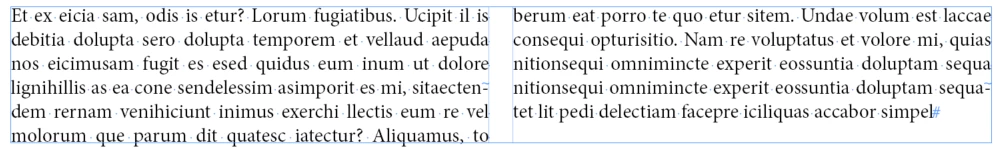

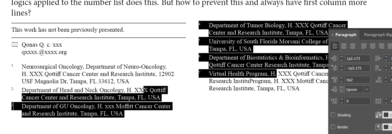

Usually on a “Frame to Content” fit, the first column will have more lines than the second column (check first image)

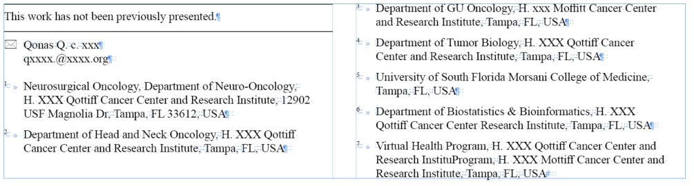

But on the below case (check second image), why the second column is having more lines than first? It seems like the keep logics applied to the number list does this.
Please let me know how to prevent this and always have first column more lines? Do we really need a scripting support here? Have attached the DEMO indesign file.

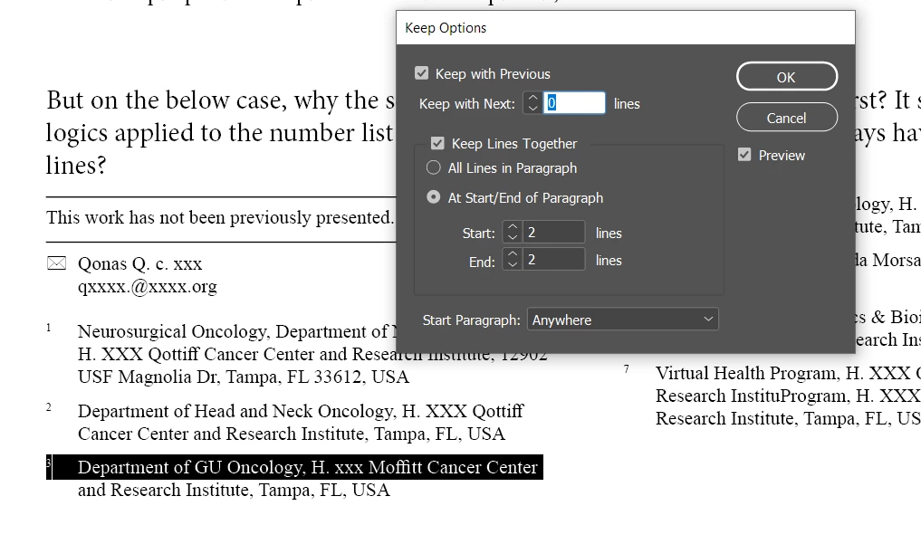

The reason is that there not enough space for the no.3 bullet to fit in that space.
You have to reduce the paragraph spacing to 0p2 to fit it in
Or reduce space elsewhere
Or increase the size of your text frame and for No. 3 - set it to keep with previous
Then fit frame to content works
Eugene TysonCommunity ExpertCorrect answer
November 17, 2022

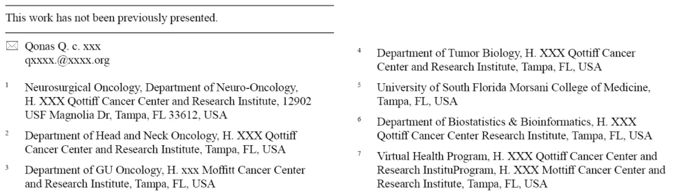

Shiv Allva
November 17, 2022
ok, thanks for your valuable info.
I took the last solution what you provided and created a script, works good!

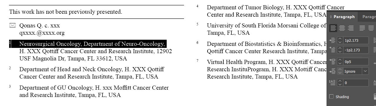

Did you intend on the text on the right column not to go to the top of the frame?
Brad @ Roaring Mouse
November 17, 2022

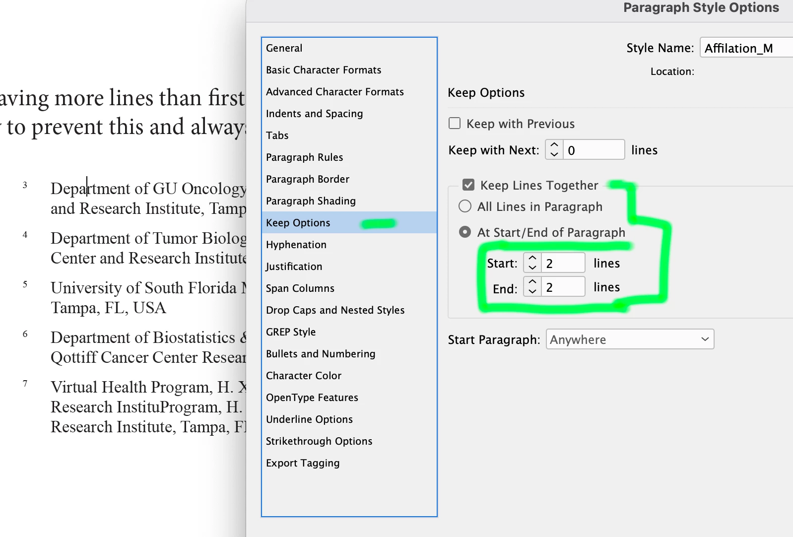

It's because of the Keep options on your paragraph style for the numbered items. It will not break any paragraph into less than two lines. This forces the last item in the first column to the top of the second column.
You could turn it off, but having single lines is bad typography.
"Usually on a “Frame to Content” fit, the first column will have more lines than the second column"
No. It will make the text box the smallest. In this case, that means putting the extra item in the second column.
