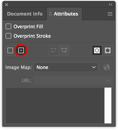

    I feel that you are thinking of Illustrator and not InDesign. If it is Illustrator it is part of the Attributes panel. If you click on the Show Center icon you will see an X when click or move an object.
    May 19, 2020
    Thanks for the reply, but it was in InDesign. We use ID almost exclusively. Unfortunatley, there is no "Show Center" icon check box in the ID Attriburtes panel.

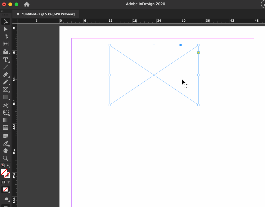

    I agree with Barb. One of the reasons that the center point isn't necessary with text and graphic frames is that if the frame's fill is None for a text or graphic frame, you can still move the frame by clicking inside the frame. This hasn't changed in recent versions.
    But with Unassigned frames, and you have a frame will a fill of None, you can ONLY move the frame by clicking on the inside of the frame by clicking on the center dot.

    As far as I can remember, InDesign only shows the center box/x for unassigned frames—not text frames or graphic frames—and the frame has to be selected, and it can't have a fill.
    Illustrator shows it for all closed paths, and it can be enabled/disabled in the Attributes panel, but InDesign doesn't have that option.

    Thanks for the reply. InDesign 2018 shows the center small x in the both rectangle boxes and the text box when they are drawn or moved even if there is color in the box. ID 2020 only shows the small x as the box is drawn. Very nice graphic you sent, though. Wish we knew how to do that. We just do print.
