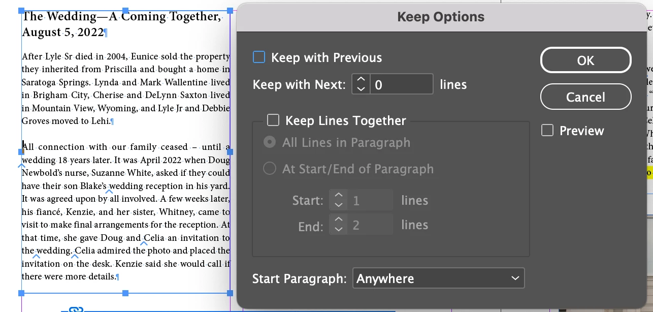

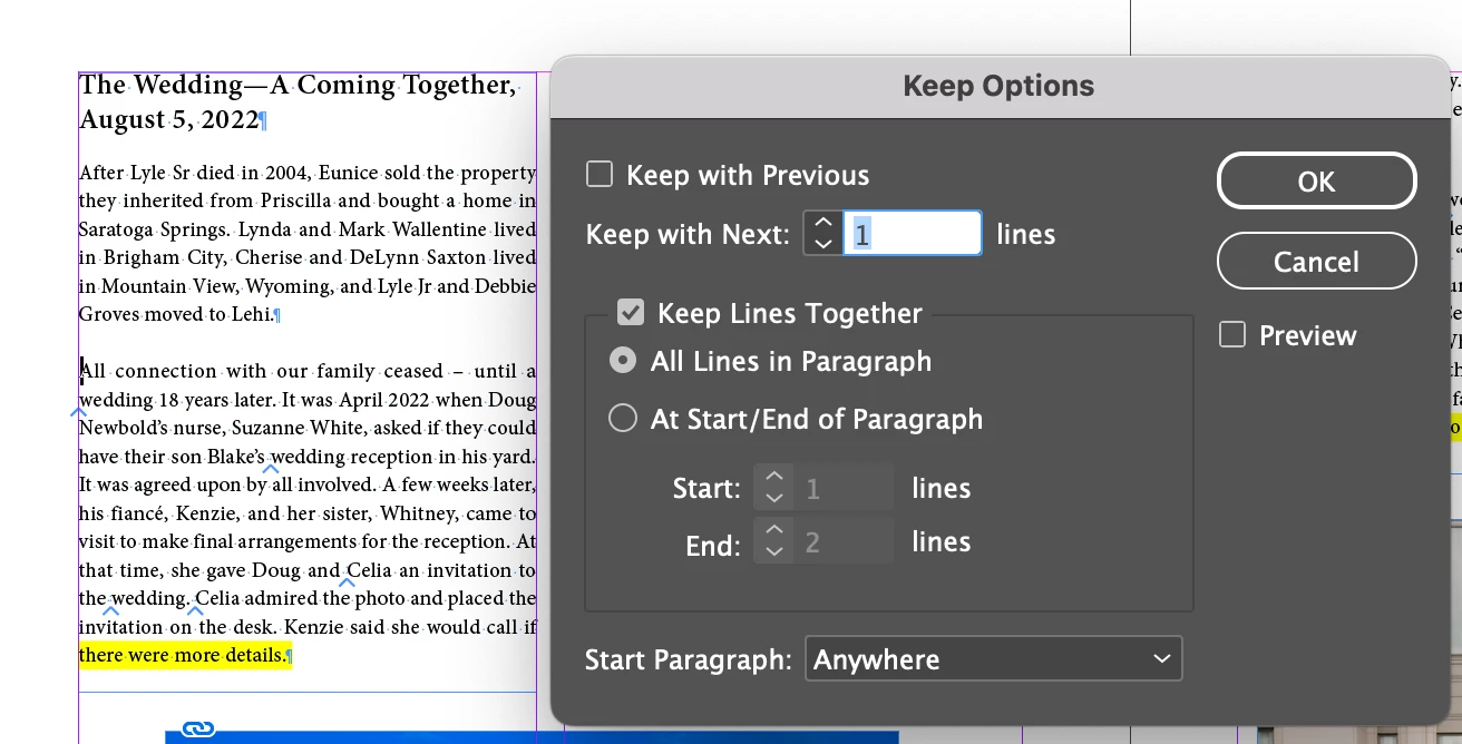

Amy22137409vgibCorrect answer
Oct 5, 2023 6:56 PM UTC
IDK if this is what you are experiencing, but I had a similar situation. The paragraph style that was used for the affected paragraphs had the "Keep Lines Together" box checked and the "Keep with next ___ lines" had 1 in the blank. I deselected the "Keep Lines Together" box, and changed the "Keep with next ___ lines" to 0. The yellow highlighting disappeared.
