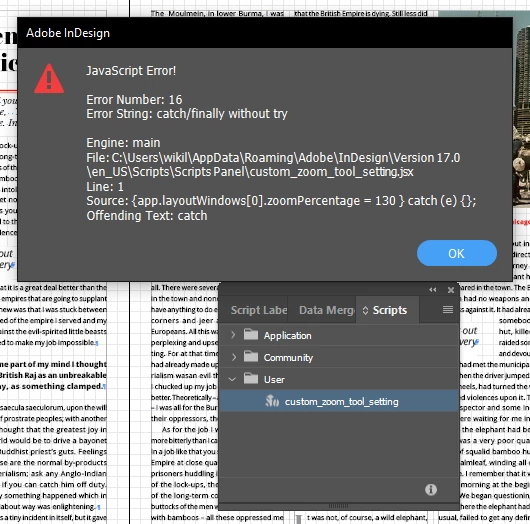

try {app.layoutWindows[0].zoomPercentage = 130 } catch (e) {};
Mike Witherell
Chris  P.  Bacon
September 7, 2022
The zoom tool does not invoke the code, and when I double click the script in the scripts menu to test it, I get this error message.
Do I need to set up a custom shortcut to invoke this script with, or need extra measures to bind it to the zoom tool?
