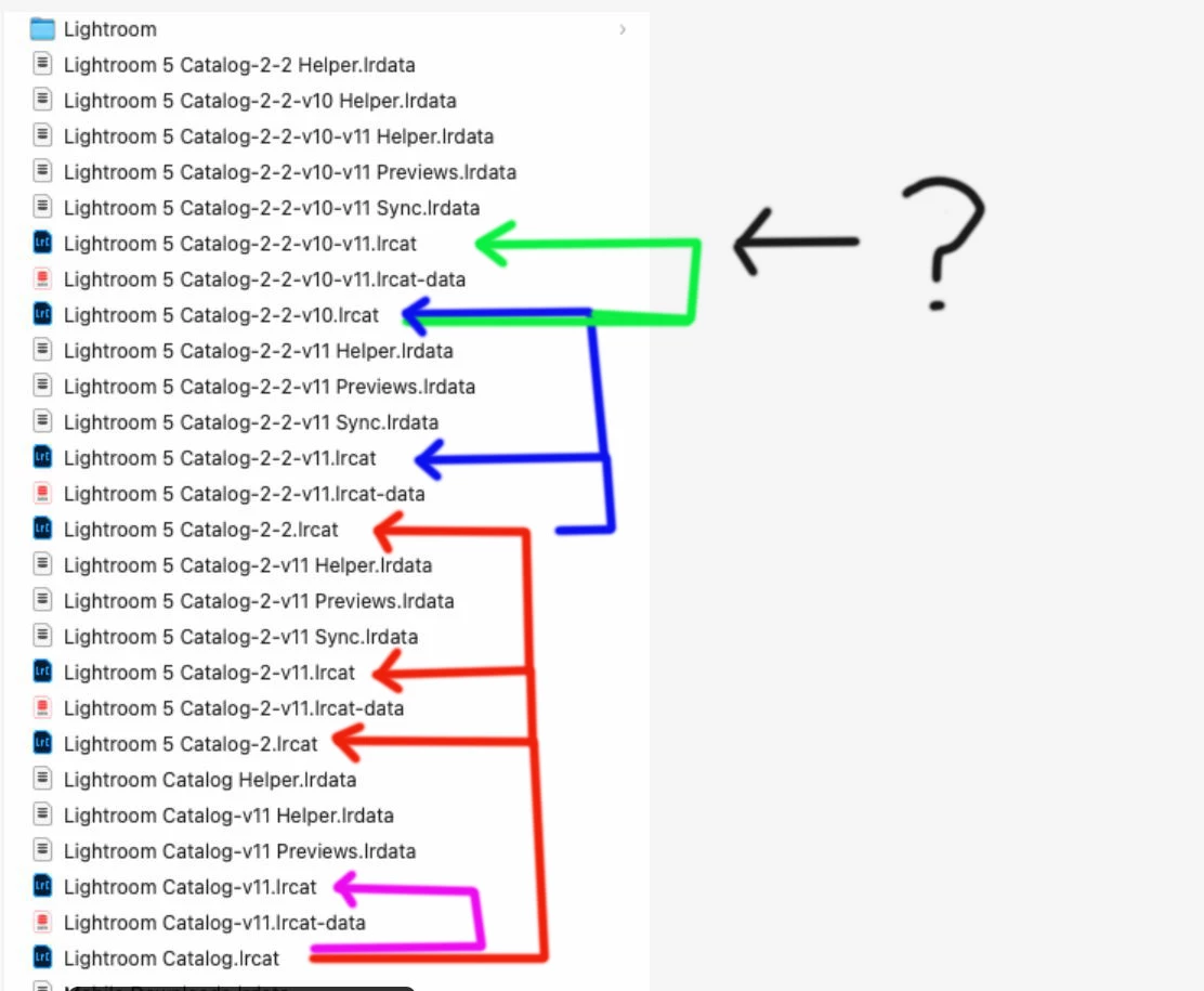

@El_Jeffe  If I might suggest- You really need to keep only your ONE current working catalog in the folder you frequently use for Catalogs.
When you upgrade a Catalog you should archive the 'old' version well away and never open again (except for catastrophies where 'backup' catalogs would be of use)
Catalog maintainence is your problem- not a support problem. (Would you contact Microsoft to create order of your Word documents?)
A progression of upgrades show in your screen clip, and you have been upgrading very old catalogs that precede other upgraded catalogs- hence your problems.
A progression of upgrades would be like this- (IF you always upgraded the correct catalog)
Catalog.LRCAT > Catalog-2.LRCAT > Catalog-2-2.LRCAT > Catalog-2-2-10.LRCAT > Catalog-2-2-10-v11.LRCAT
Of all your Catalogs in your screen-clip, only you can determine which is the 'latest', but my suggestion is that it might be-
Lightroom 5 Catalog-2-2-v10-v11.LRCAT    (Double-Click on the .LRCAT file to 'Open' it in Lr-Classic)
https://www.lightroomqueen.com/lightroom-upgrade-catalog/
https://www.lightroomqueen.com/one-or-multiple-catalogs/
In your screen-clip I see you have been  (incorrectly) upgrading old catalogs with v11 (see the Red line in the clip below).
Regards. My System: Windows-11, Lightroom-Classic 15.1.1, Photoshop 27.3.1, ACR 18.1.1, Lightroom 9.0, Lr-iOS 10.4.0, Bridge 16.0.2 .

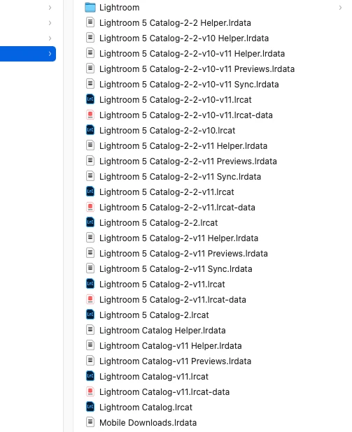

El_JeffeAuthor
January 11, 2022
Adobe does come on the forum and help sometimes.
I also don't want to sit on the phone for an hour gain with someone who can't help. This is an archive of many years of professional work and I don't particlarly want to have some noodl around with it and screw it up. I pay full freight for the Adobe subscription and honestly, when I pay them that much, I expect them to stand up and fix issues. I'm running a business here too.
Here's what my Pictures folder looks like. It's on an external SSD, as it's been for a numeber of years now. None of the .lrcat open up and show anywhere near the folder structure of my hard drives the last time I used LR. In fact when they open they're showing old hard drives that have been retired for age reasons from a year or two ago.
