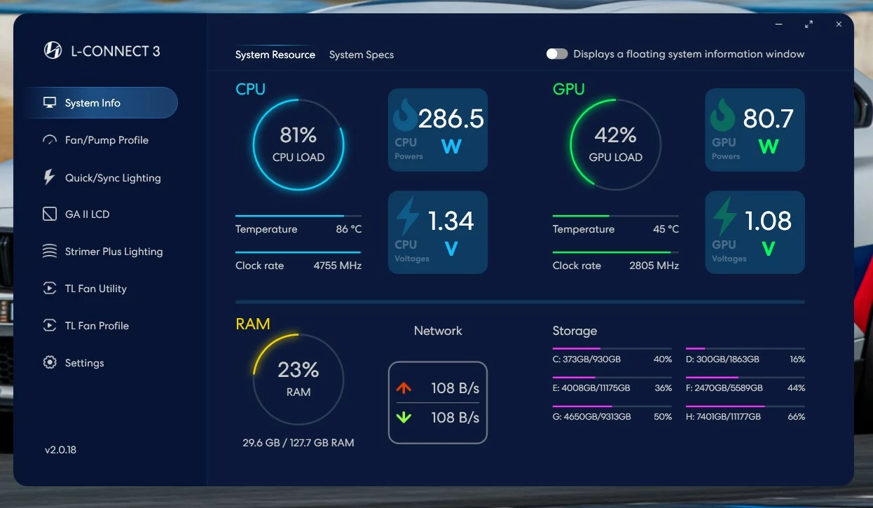

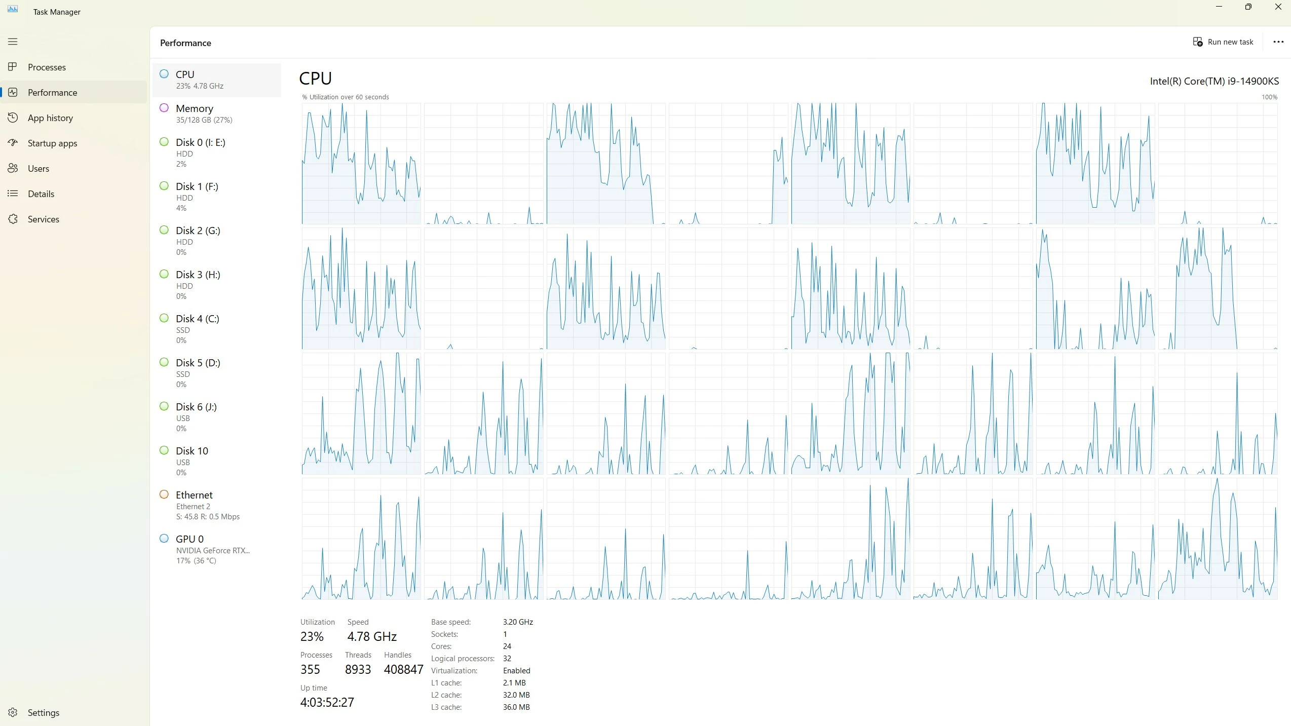

A detailed look through my performance metrics shows my machine resources are not maxed out or even utilised. LR just isnt utilising the full ability of my PC to export.

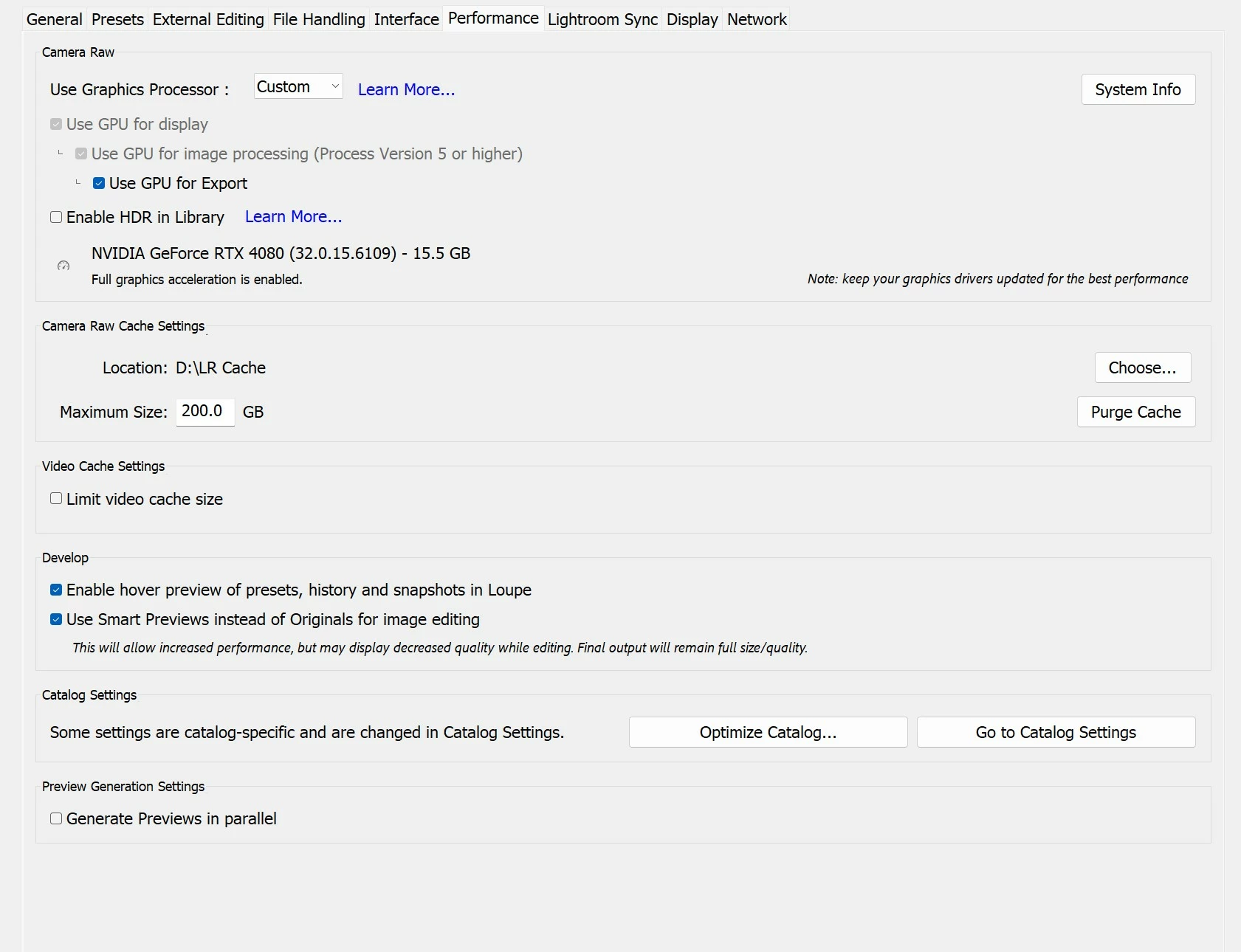

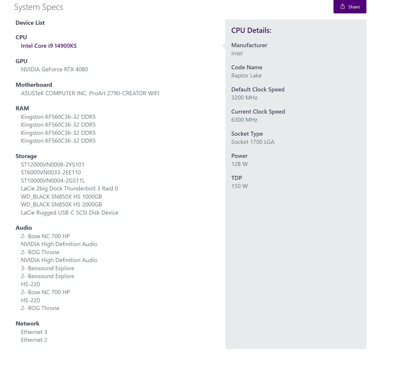

My PC Specs are as below as per attached images. It is clear the PC is more than adequately built to handle anything lightroom can throw at it. I use super fast SSD as OS Disk and separate SSD as scratch disk with all my lightroom files on it and I tons of storage literally 25Gb in total on the PC. So im not hitting any limits.

Nothing works. My PC is just horribly slow at exporting right now. Im exporting right now and took screen shots of my PCs performance parameters ... its NOT utilising the PC at all. Whats wrong with LR?>

"NVIDIA GeForce RTX 4080 (32.0.15.6109)"
That graphics driver is four months old. So as a first step, as @Aleke suggested, install the latest Studio driver from here:
https://www.nvidia.com/en-us/drivers/details/240528/
If that doesn't help, then proceed with the additional steps provided by @Aleke.

Jan 30, 2025 6:29 PM UTC
Hey @RobbyJai!
Can you check if there are any updates available for your GPU drivers? Have you noticed any performance issues while working on your photos, or is it just during exporting? Can you see if exporting also slows down when you uncheck "Use GPU for Export"? To narrow down if it's an issue with an export preset, can you test if using different export presets results in slow exports too?

Jan 31, 2025 12:44 AM UTC
thank you so much. you and John Rellis was bang on. Definitely graphics drivers issue. Unticking use GPU to export sped things up massively.
As per johns advice i updated the graphics drivers to the latest and the machine is back to normal when i turn on GPU to export.
