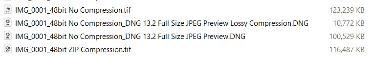

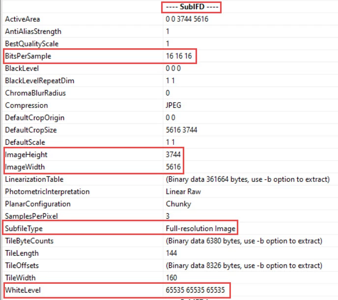

April 26, 2021
Windows Explorer file properties are showing the embedded preview bit depth. I created a LrC 10.2 DNG export file and checked it with ExifTool as shown below. The TIFF and DNG file size would also indicate it is 48 bit.
LrC 10.2 48bit TIFF export to DNG
April 27, 2021
Thank you, Todd !
I checked with Exiftool and it does indeed show the full resolution image is 16 bits.

That size difference is pretty big, but as far as I know, DNG in Lightroom is completely lossless, but apparently it does package the data more efficiently. That's why converting RAW files from your camera into DNG will also reduce their size (and in addition contain all metadata, which is normally in external XMP files). I don't know if this is true for all RAW file types, but I've seen it with a few, usually saving around 1-3% of space. Not huge, but with tens of thousands of pictures, it does have an noticeable impact on storage.
