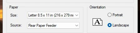

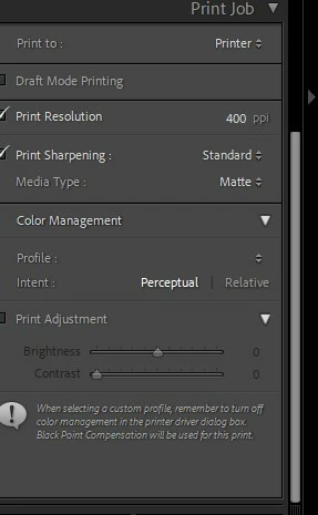

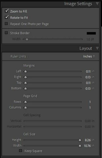

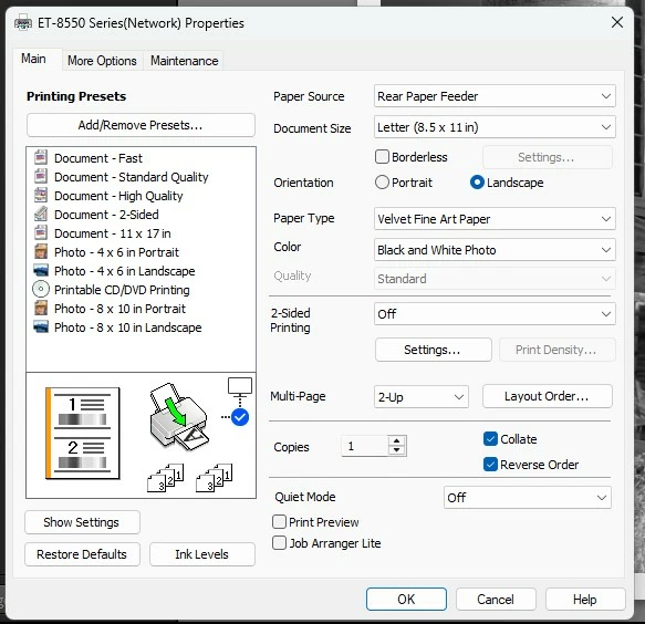

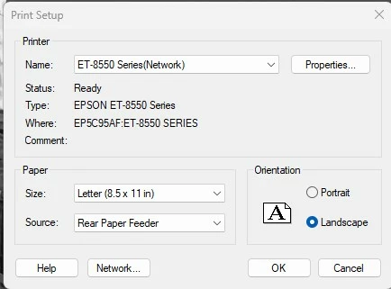

I am having a challenge in the print module. I'm using LrC 14.5.1, Windows 11, printer is an Epson ET-8550. I have been trying to print 8.5 x 11" prints with a small border. I have all the margins set properly in the print module page layout, everything looks proper on the screen. It's the way I have been doing the prints for years. But the resulting print is consistently coming out as a 5 x 7" print on half of the paper. I'm not using any print template. I have two other printing programs, Qimage and Epson Print Layout, and they both print as expected. But I'm puzzled because LrC doesn't want to seem to print the full-page image. Any suggestions would be greatly appreciated.

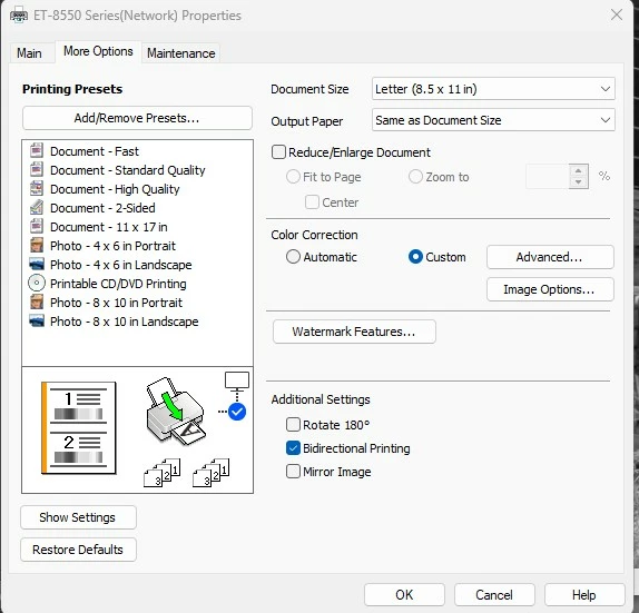

@JimHess  Try checking the Epson [Print Preview] to 'on' in the Printer dialog-  The preview might indicate if it is LrC creating the smaller 5x7 image, or if the printer is at fault.
I also note your field for {Profile} under Color Management is blank- Are you letting the Printer color manage? I would expect to see "Managed by Printer" or a Paper Profile if LrC is managing color. (Even if printing a B&W image).

I don't see any problems with your settings ( Rotate to Fit ? ). With my limited knowledge.

I appreciate your looking at the screenshots. LrC printed just fine initially, but just recently started printing strangely on the 8.5 x 11" paper. I even reset the defaults on the printer to see if that would help, but it didn't. I can still export and print using the other applications, however.

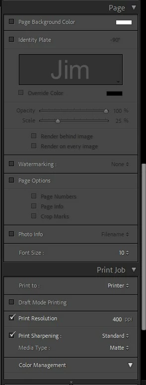

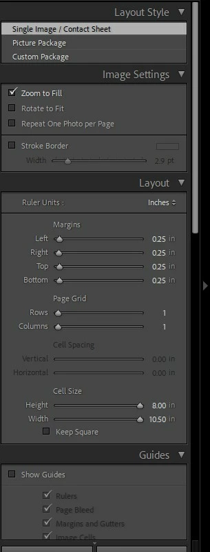

Post some screen-clips of your printer setup dialog and the LrC layout panel-  Someone might then see the problem.

JimHessAuthor
Oct 10, 2025 3:44 AM UTC
This particular job is a B/W image. Problem is the same for a color image. I didn't include the screenshots for the a BW page. Hope this is enough.
