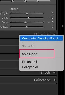

Ian Lyons
January 13, 2023
Before resetting preferences.
From your description and screenshot, it would seem that you have enabled Solo mode. To disable Solo mode you will need to right-mouse click on any of the panel headers to open a context menu. When context menu opens - click on 'Solo Mode' to disable the checkmark. I've attached a screenshot as an additional aid.
If above doesn't solve the problem, then go ahead with resetting prefernces as John suggests.
riwo.dotAuthor
January 13, 2023
Solo mode isn't the problem, I've tried all that and whether it's enabled or not doesn't change anything on the panel switches.
Unfortunately, resetting and deleting the preferences with a restart of the Mac did not help.
Oliver
