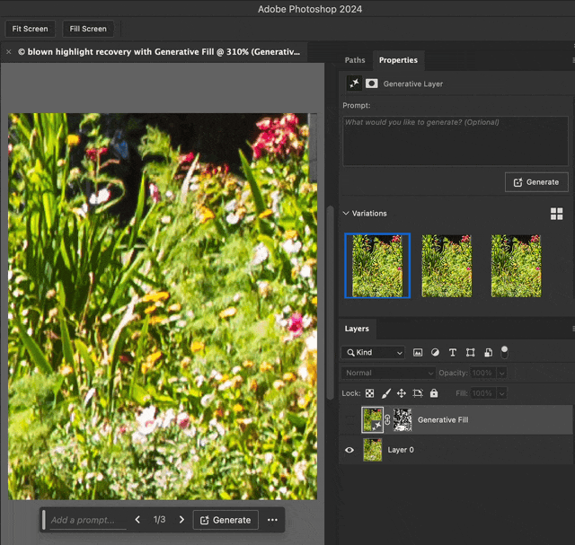

In Photoshop the conventional way to handle this is to manually heal or clone, but this problem gave me an idea: Can Generative Fill help here? I used Select > Color Range to select the extreme highlights, then with the selection active I clicked Generate in the contextual task bar. This might take a while because the selection is much more complicated than the usual shapes that Generative Fill fills in. After it generates the three variations, you select the one you like the best. In my example the result isn’t perfect, but it can potentially be improved by using a different layer blending mode. Or maybe what I should have done is make a better initial selection. If the Generative Fill technique meets your requirements for texture matching, it would certainly save a lot of time compared to manually healing or cloning.
