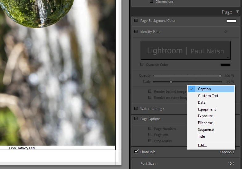

You can use LrC Print 'Print to File' to get an export of your images with metadata shown. Here's an example of print the caption.
Be aware that the information is overlayed on the bottom of your picture so you lose some pixels.
