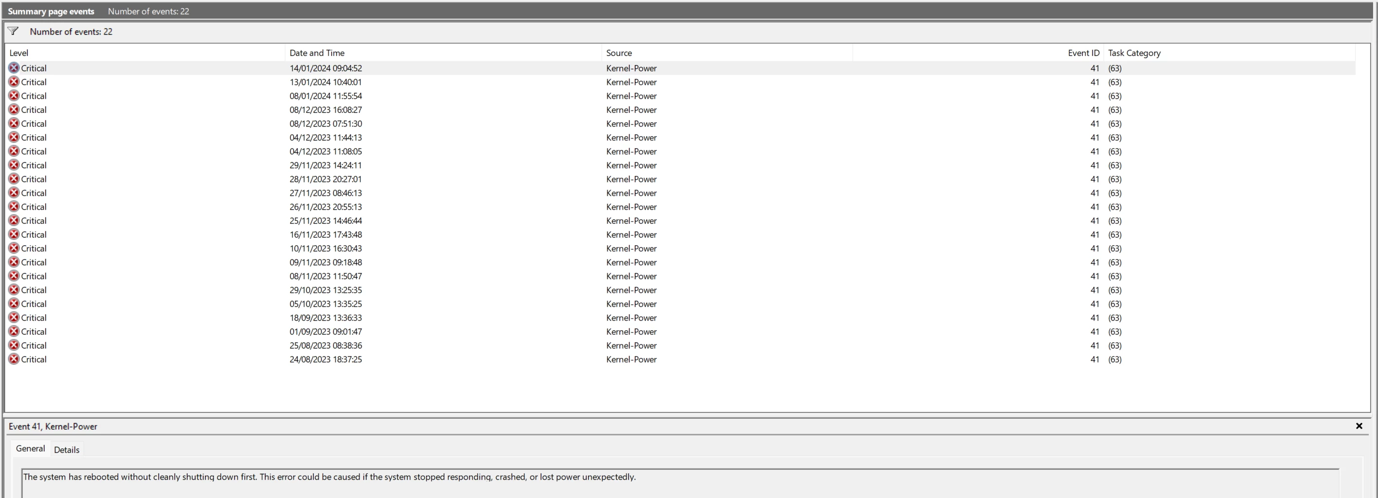

3. Events Viewer (again)
Please revisit your Windows Events Viewer. Look for Critical events referring to Kernel-Power. Any?
January 14, 2024
I get a Critical event logged (Event 41, Kernel-Power) every time I force restart my PC after a freeze from LRC or Photoshop.
GoldingD
January 14, 2024
So a Kernel-Power event.

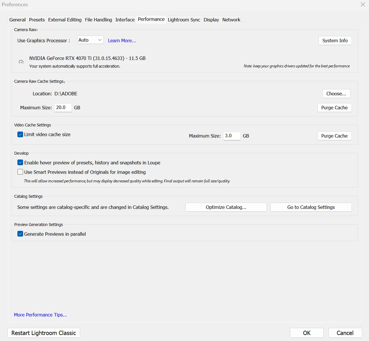

 2. PERFORMNCE SETTINGin LrC PREFERENCES
  • And please post a screenshot of LrC /preferences/performance/
  • Looking for:
/example deleted now that author has posted info

2.
GoldingD
January 14, 2024
Nothing wrong with any of that requested info.
