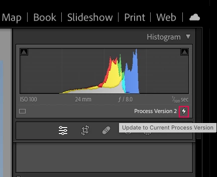

Yes, the exclamation mark was on the bottom right corner as shown in the first screenshot below. However, it's now indicated by a lightning symbol at bottom right of the Histogram.

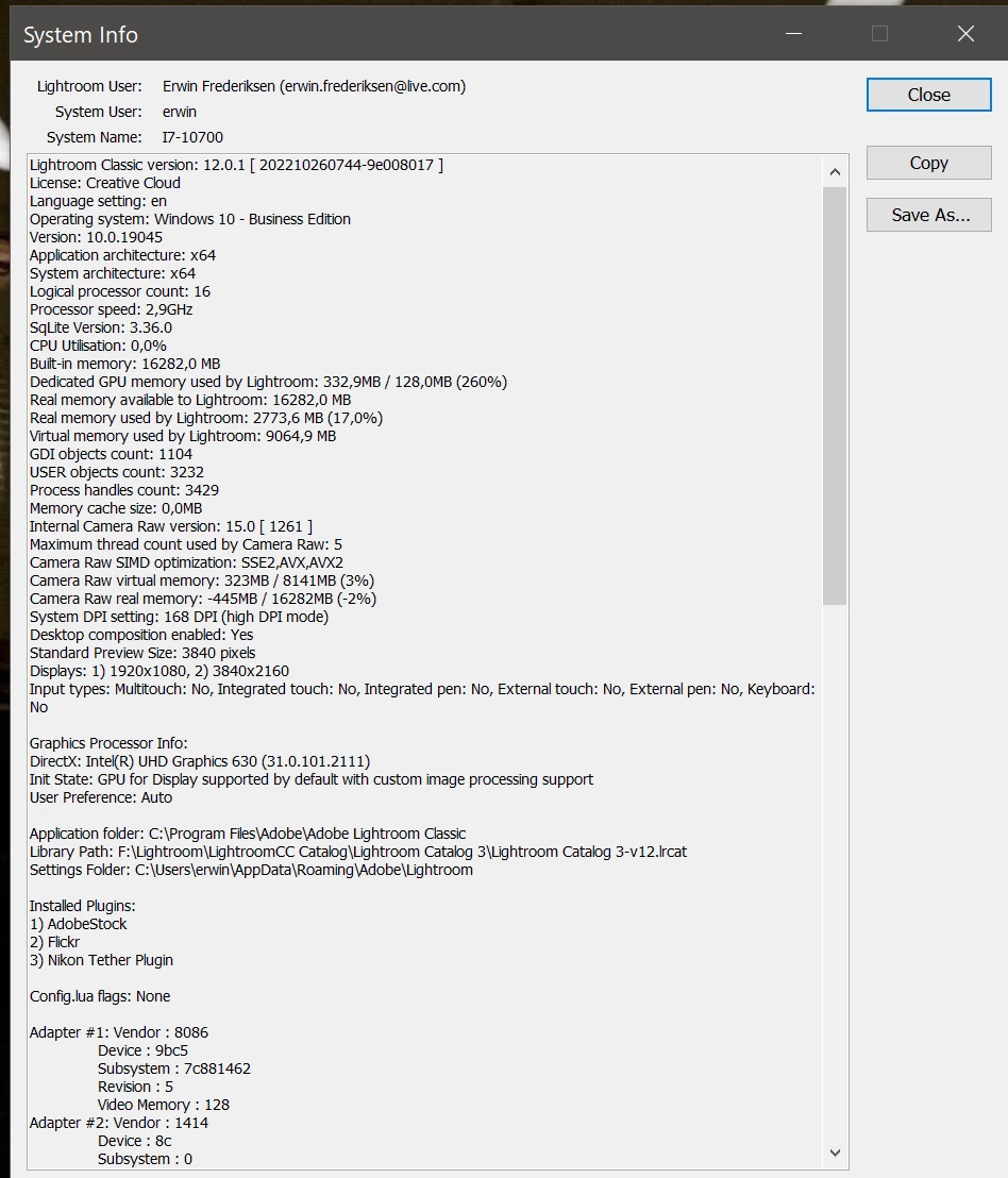

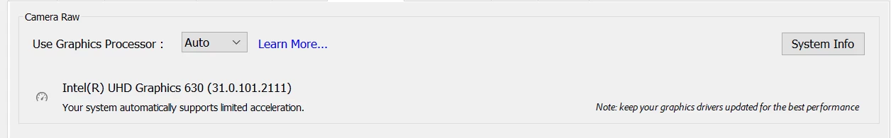

Well, yes, the UHD is the integreated video controller. There is no other video card in the system. Lightroom is using the UHD630, as can be seen below:
and also from system information:
I also tried disabling the GPU support in settings ( on the old laptop is was disabled as well), but that did not make a difference ( even with restart of LR).

Interested in seeing the display section of the system information that LrC will report. Please click on Help, then System Ino, copy that, then paste in (a reply) the bit about the display.
