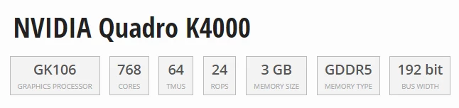

 I've read the threads about the time it takes to process AI denoise and I'm curious. I'm not a computer guy, maybe someone can help me understand. I have images from a Canon 5D mkIv and the estimated times on random photos range from 40minutes to 860 minutes. My machine has an Intel I7-3770K CPU @ 3.50Ghz and an Nvidia Quadro K4000 GPU (11 GB memory). I grabbed a photo with a time estimate of 38 minutes ( it took 20 minutes ) but I opened task manager and watched my component usage and my GPU usage was hovering around 2% but my CPU shot up to 100% ( Lightroom was using 98% ) .. All the threads I've read point to the GPU as the culprit for these long processing times but my task manager showed barely a blip on my GPU while my CPU was maxed out.  I would greatly appreciate any thoughts on this. My motherboard is ten years old and I'm not sure about just plugging in a more modern GPU when I don't fully understand what's happening.
 Thanks in advance for any help.

 Thanks for the link, I have the most current driver installed ( 474.64 ) . What confuses me is that during processing I'm only seeing 2% of my GPU memory being used. But, after some help I've looked at the performance tab and see I can only tick the "use GPU for display" radio button... "use GPU for image processing" is greyed out. So, while my card meets the minimum specs, 3GB mem, direct x12, etc. and lightroom sees it, it apparently doesn't like what it sees 🙂 ...Thank you for taking the time to help.

Your GPU only has 3gb, not 11 (ideally you want at least 8gb), and is otherwise pretty underspecced:
(https://www.techpowerup.com/gpu-specs/quadro-k4000.c1841)

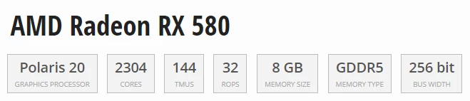

My AMD RX 580 is by no means a particularly impressive GPU, but it takes c. 45 seconds for a Canon R5 file.
Look at the difference in specs. Even if you aren't "a computer guy", more is better - especially around RAM and cores - where Lr is concerned:
(https://www.techpowerup.com/gpu-specs/radeon-rx-580.c2938)

Hi Keith, Thank you for pointing that out. I guess I'm confused by what my task manager shows. That shows 3.0GB dedicated GPU memory and 8.0GB Shared GPU memory with a total GPU memory of 11.0GB. I'm probably misinterpreting that information because like you've said, if I look up the spec sheet for my card it says 3GB. Thanks for taking the time to help.

I can see that happening if the GPU is not supported for Lightroom Classic/Camera Raw graphics acceleration. If the GPU can’t be used, it would have to push all the work to the CPU, overwhelming it. I looked up the release date of the Nvidia Quadro K4000 GPU, and it looks like it was released a decade ago. The CPU release date appears to be 11 years ago.
I’ll have to leave it to the more expert PC users to advise on putting a newer GPU on that motherboard, but given the age, yes, it’s likely that for it to be worth doing that, other motherboard components would also need to be updated to keep the entire system balanced and not bottleneck a current high performance GPU.
