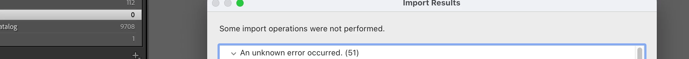

I've been on a 2 week holiday and Lightroom Classic has going to sh*t on me.
I'm getting an error that says "An unknown error occured 51", and now I can import photos".
I'm running 14.1.1 (I just upgraded hoping this would help the problem.
Mac version: 15.2 (24C101)
I'm just trying to import.

"However, I discovered a "/" in my filename. Removing that fixed everything"
Yes, that would be an 'illegal' character- best to use only alpha characters and spaces or underlines.

An Error 51 can also appear if the folder Destination for the file import is not writable ( normally this error would show "not writable")
Check your Disk and Folder Read/Write permissions.

Hi Guys,
Thank you to you wonderful wise people.
This is what I've done so far.
Checked that my drives are writtable - they are. I've copied other files across and they write.
Resetting the preferences.
Rolled back to 13.5
Used a back up
I've rebooted.
I've checked that LRC is compatible with Sequoia.
I still have problems with LRC not recognising some of my folders but that's not my immediate problem.
I've done everything that I've done for the last 7 years and now it's stopped working.
"LRC not recognising some of my folders"
If you corrected folders and filenames with the OS file browser by removing the "/" then you would encounter 'Missing' folders and photos in the LrC catalog.
