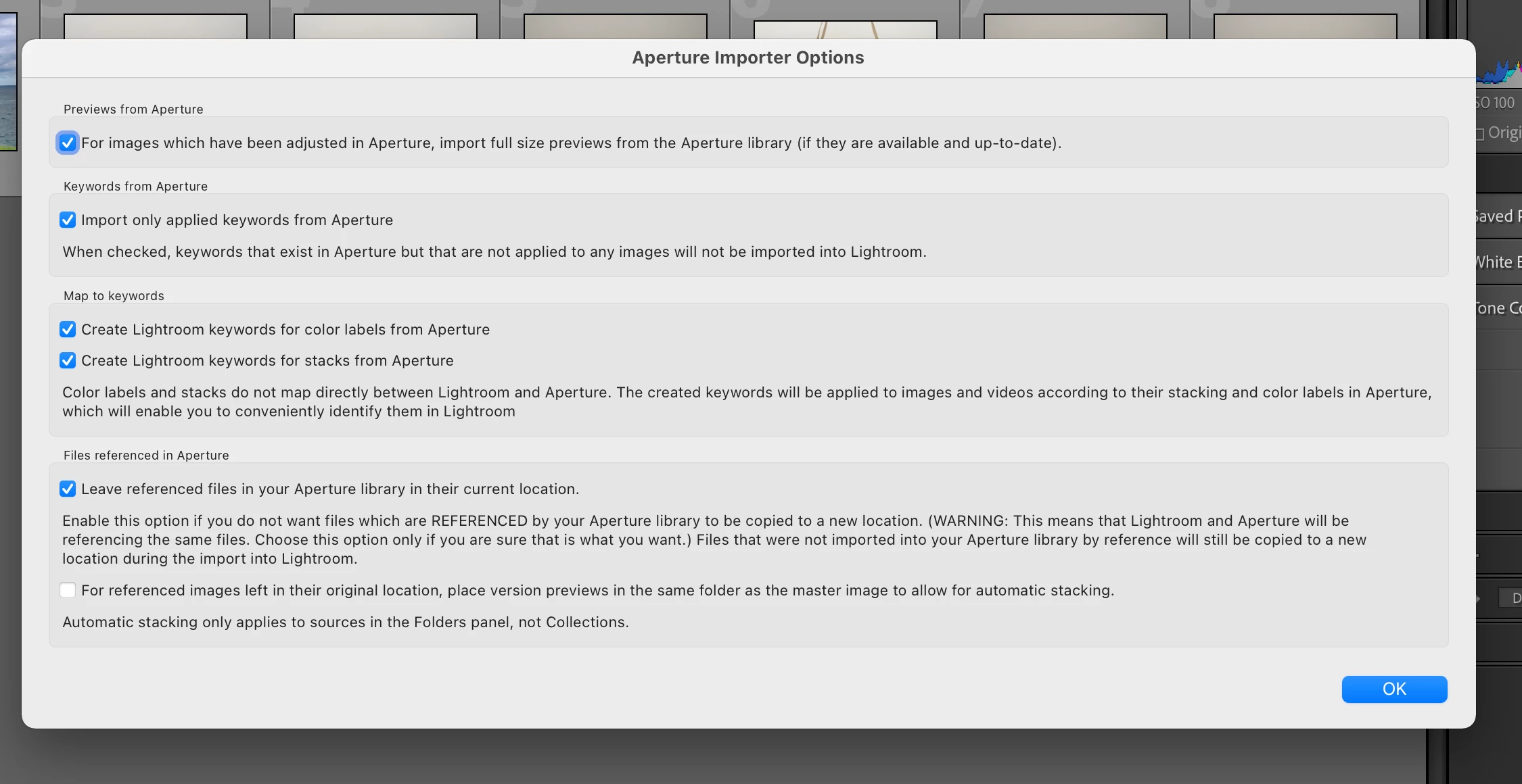

For everything above regarding checking all images are referenced I did this using Smart Albums for "Missing"" and "Managed" images. The big one though is Keywords. Lightroom does not accept Keywords with punctuation or nested keywords.
The solution I found after several fails was that you MUST go through your in use Keywords in Aperture while it is still working and remove any keywords that have punctution marks, are duplicates or are nested inside other folders. Having done that it is now chugging away and after several days is at 34% on 106,000 images.
In Aperture, create a new Smart Album called Keywords. Click on the little inspector at the right to define the Smart Album. Click Keyword and you will see all the in use Keywords. Click one or more keywords that has punctuation, is a duplicate or is nested as indicated by parentheses and then go through them as above using the Edit Keyword menu at the bottom of the Keyword HUD. Assign all visible images to the same keyword so that all of the Keyword in the right hand column of the editor are unique and un-nested. You don't need to worry about un-used keywords. If you delete a keyword it will ask you first if images are assigned to it.
Once you are done I used the settings in the image attached. Good Luck. Bob
