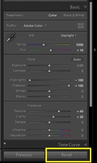

I clicked on the reset button, lower right-hand corner of the develop module.
If that isn't working for you like it did for me, then perhaps you should take time to read a link that is provided in one of  the "featured" posts in the forum:
https://helpx.adobe.com/lu_en/lightroom-classic/help/raw-defaults.html

Yes, that's because you have set that as a default preset for the camera. The reset button resets to default, and I haven't chosen a default setting. Therefore, it will clear the prreset that I chose in the import dialog and leave the raw file without any adjustments. I have chosen NOT to have a default preset. A

I'm using Lightroom Classic 9.2.1. I just performed a reset on an image taken this morning that was imported using a preset that applied the Adobe Color profile and applied a few other adjustments. The reset process changed the profile back to Camera Standard, and canceled all of the other adjustments that have been applied by my preset. I don't know if it's because of the way I have things set in my preferences, but the raw file was pretty much untouched after the reset.
